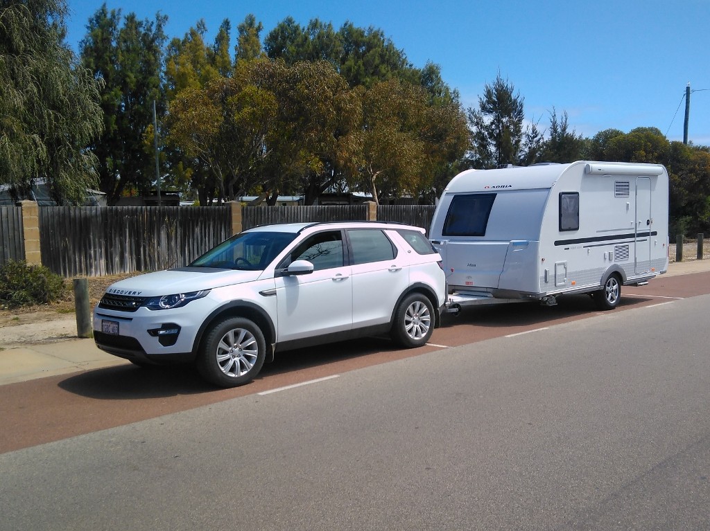

Mamil said
10:44 PM Dec 21, 2018
Mick, if you do stay with the Beemer, have a look at the Adria range of caravans. I have 16' Adria Altea 402. It is 1600kgs fully loaded, ball weight of 100kgs, and tows easily behind a medium SUV. The European manufacturers really know how to fit a lot into a small and light van, and their construction techniques are streets ahead of Australian made vans. A friend of mine has the same model of Adria and tows it with a BMW X3, and I use a Landrover Discovery Sport 2.2 diesel. You don't have to have a V8 tug and a three tonne van to get out there and do it - sometimes less can be more....
-- Edited by Mamil on Friday 21st of December 2018 10:47:44 PM
-- Edited by Mamil on Friday 21st of December 2018 10:51:57 PM
-- Edited by Mamil on Saturday 22nd of December 2018 10:46:19 AM
