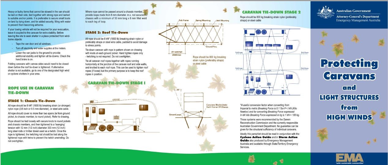

I offer the following, although I would think it was over the top unless actually caught in the path of a cyclone and you couldn't relocate and had time to implement it.
Protecting Caravans and light structures from High Winds PDF
You will get lots of links to PDF of this handy brochure
ie
www.google.com.au/search
