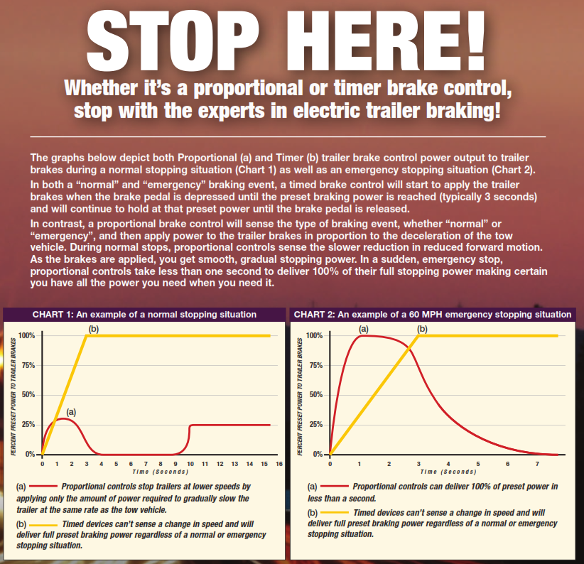

There are two types of Tow-Pro controllers available. See Tow-Pro Range. The Tow-Pro Classic is the older synchroniser style of controller that the major manufacturers of brake controllers either no longer supply or do not heavily promote them. They are the ones that require resetting for different conditions. When you apply the brakes they quickly ramp up the braking power to the maximum you have set. It does not matter how heavily or how long you have been braking the braking effort from the van will be the same.
The Tow-Pro Elite has two operations modes, proportional and synchroniser (or user-controlled mode as Redarc call it.) Proportional controllers have a sensor in them that senses how heavily you are braking. The controller will thus apply the brakes of the van to match the tugs braking effort (when you have set the controller up properly.) I would strongly urge those with a Tow-Pro Classic controller (or any other synchroniser style controller) to replace it with a proportional controller pronto before they get into strife fiddling with the controller on the move.
The following is a graphical representation of how the two types of controller work.
