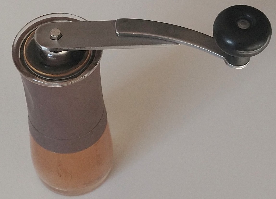

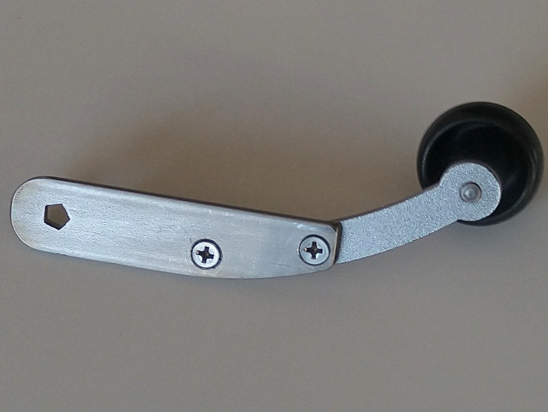

Emergency repairs for caffeine, as the 5 sided key in the handle wore loose & was on the verge of turning freely, panic set in!
I could have bought a new grinder & it would have been easier, but since I had nothing else better to do I fixed the old handle.
The 5 sided key was a pain in the neck to file to size, mostly with a needle file, but got there in the end. I had some 3 x 20 stainless 316 flat bar, so that won't rust.
Tapped two M4 holes for screws. Also used some Loctite. The small Bosch 10.8 v (12v) angle grinder is probably one of the best tools available.
Very happy with the result & we can continue to grind our beans.

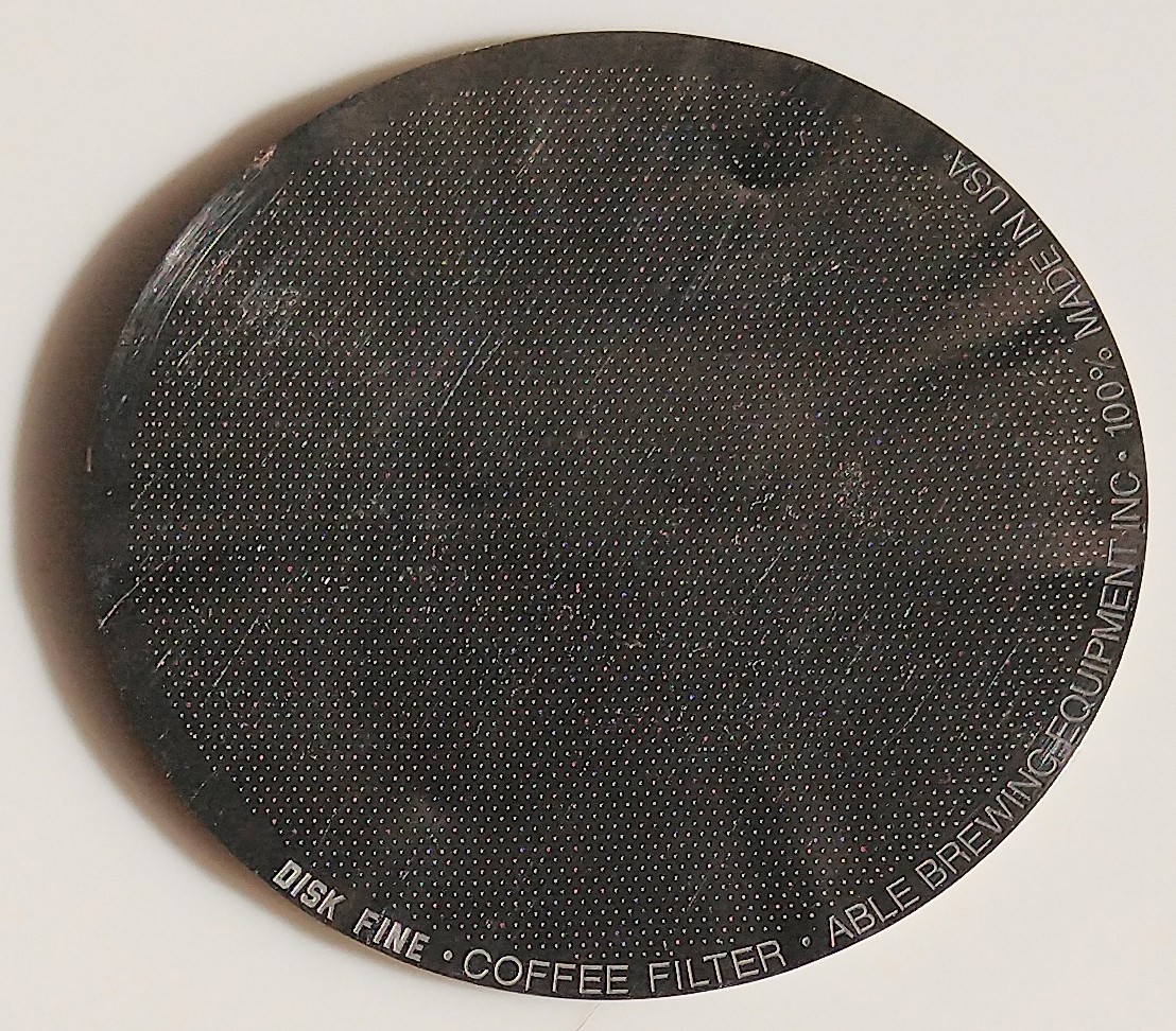

& a reminder for everyone, NEVER use boiling water in any coffee inciuding instant coffee. If you like a hot coffee pre heat the cup.
We use a Able fine filter in the Aeropress. Have the standard filter as well.

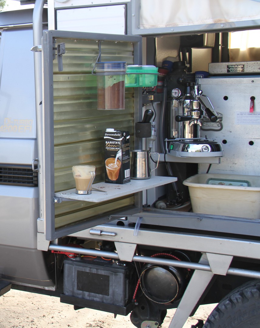

My La Pavoni Lever machine in our Slide- on camper. Powered by a built in Honda EU20i Gen set.
I pre -grind a quantity of beans before leaving home (not ideal) . I hope to be able to install a Grinder in the Slide on in near future - I have made room for it.
This set up is quick and easy to use. (no unpacking etc.- just open the door!)

On a side note , was helping out at the Salvo's through a work scheme last week , they actually had a commercial machine and grinder there and l made the workers there coffee's , only thing was the beans were use by next month , so l presume nearly a year old ...... they didn't mind the resulting brew , l gave it a miss lol :)
-- Edited by Whenarewethere on Thursday 27th of May 2021 08:45:12 AM

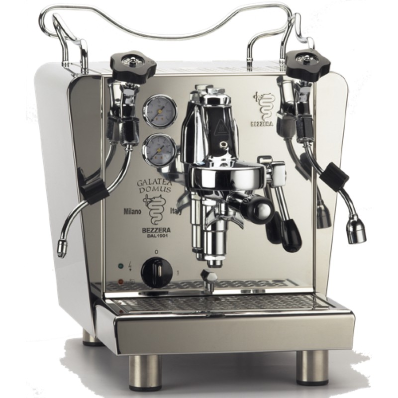

Coffee Head (incl. Group handle ..) and coffee water in a "Commercial" Espresso machine is regulated to around 90 - 92 Degrees C via a "heat exchanger" system . The boiler (a different system ) is for steam and boiling water.
Coffee is very susceptible to heat - boiling water burns it quickly to a bitter taste. It will only tolerate 90 Degree C water for no more than around 30 secs. before degrading and becoming bitter. That is why Baristas "pull" their "shot" (30mls single or 60mls double shot) in the 24 sec. to 30 sec. range and this timing is controlled by the grinder.(how fine or coarse the coffee is ).
Probably because of Public Risk issues (spilling in bed etc..) Many Cafes etc. cut back on temp. for the same reason (I think this could be a reason to put people "off" coffee as it is not nice if half cold.) - that is why if I ever buy a coffee any where I always ask for "extra hot" but just watch they do not boil the milk when "stretching it" for a capuccino.
I'd be more concerned about keeping my cans of beer below 5C, love a coldie.
cheers bob
Morning KJB.
You seem to have a pretty fair knowledge re HX machines and espresso, I've owned one and used it daily for over 10 years, they really are an excellent way to make espresso, easy to use, very reliable and given regular routine maintenance will last for ages.
Do you own one or have you researched them.
This is the machine I use.
