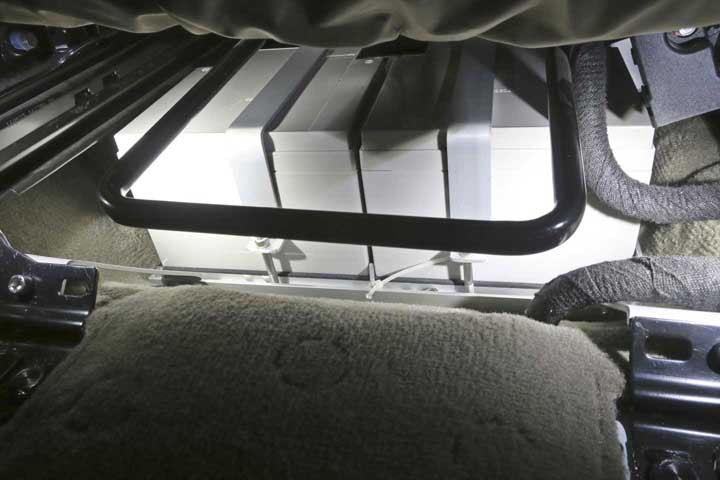

I have very limited space in the car for batteries, two of the three 26ah batteries shoehorned under the seat, so I did some tests on the 28L Waeco going in the car so it would use the least amount of power possible. 28L is the largest fridge I could fit without taking over.

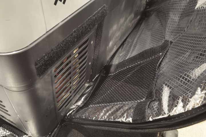

28 litre fridge per hour, ambient 35°C, fridge set at +2°C 0.0140 kW/h The uncovered fridge. 0.0132 kW/h Standard cover. 0.0116 kW/h 30mm XPS foam. 0.0082 kW/h 60mm XPS foam.
So cover up your fridge, except vent, & keep it out of the sun. If you have to run it in a locked car leave the windows open a few mm. I can get my fridge to 45°C below ambient temperature & it still does not use that much electricity. A well packed & covered fridge you can turn off for a day if you have limited battery capacity without too much increase in temperature. Throw your sleeping bags over it during the day if not running the fridge & or keep the vents clear.
I have stuffed a minimum of 2 thickness of 10mm sleeping mats between the fridge & cover & on the lid. The fridge cover is a bit tight but the extra insulation helps a lot. Macpac sell grey sleeping mats which match really well. The rear handle had to be removed to fit the fridge in the car so I filled the gaps with more foam. Last photo is a custom aluminium & stainless steel bracket to reduce height as the original bracket was too high. I did use the feet that came with the original bracket & machined them down to reduce height.

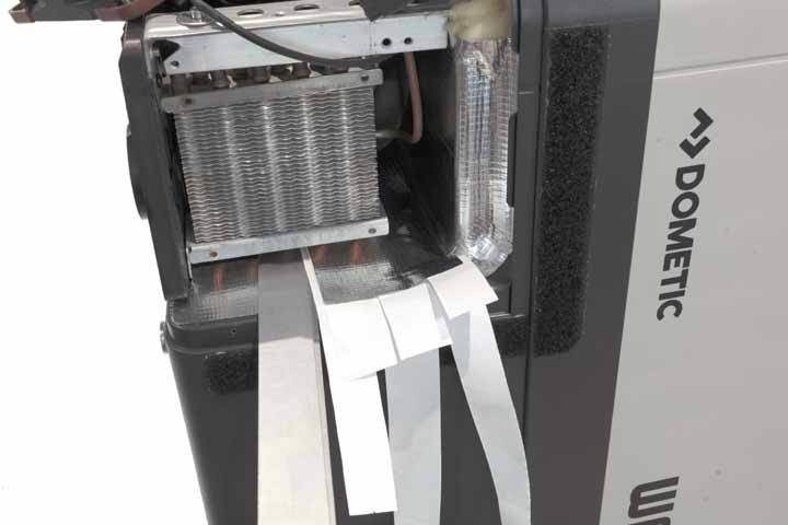

Update: A few alterations
I have replaced the original 80mm fan in the fridge with a Noctua 120mm fan.
Now have replaced the Noctua 120mm fan with another Noctua fan which not only has a higher volume it has better pressure.
Now I can feel the air being pushed through the fridge to a greater degree even with a dust filter. It also barely used any more power to the first one I installed & less than the original fan as Noctua fans are really efficient. Well worth spending the money to save energy.
Anderson plug on the fridge & a filter, it's surprising the amount of dust that would otherwise cover the condenser. I still blow out the fridge with airgun after every trip & it is quite amazing the amount of dust in the fridge covering the condenser & everything else.

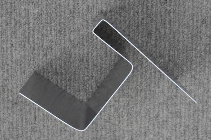

I have had a temporary piece of aluminium folded over the divide in the fridge to get the butter department cooler when running the fridge as a fridge. I have replaced it with a neater job! Works well, there is some sail cloth repair tape on the back of the aluminium so the evaporator coils don't get damaged. I used a 1.5mm thick baking tray (4028574815277) as the aluminium is a bit softer, (unfortunately not anodized but the heatsink itself has more value than being anodized) but not too soft, hopefully 1200 alloy which would be nice, which would have better thermal properties having less alloying elements, but nevertheless easier to bend by hand than 5005 alloy off the shelf sheet.
I can pull the heatsink out for cleaning both sides. Have been testing it for a week now and it works really well, wish I had upgraded this modification earlier. The tail edge of the heatsink gets considerably cool. Even a bit cooler than I was expecting, which now makes this area actually useful when running the freezer as a fridge.
If you notice there are 2 thicknesses of 10 foam sleeping mat stuffed down inside the fridge cover for additional insulation, there are 3 on the opening end, the compressor end does not need it.
Fold the front bottom edge of the butter compartment first, rear bottom corner of butter compartment second, then rear top edge of divide third & top front edge of the divide last.
Any heatsink over this divide will be better than nothing, even a couple of aluminium disposable baking trays will help make the butter compartment a bit cooler!

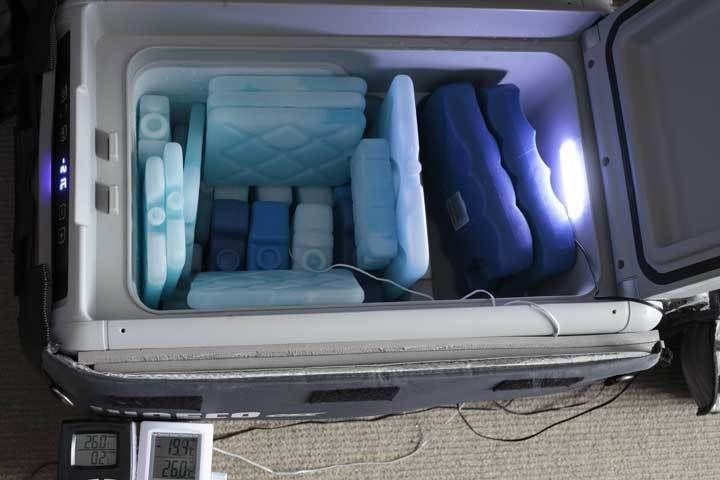

A torture test to see how long it takes to freeze to 10.5 kg of ice bricks to -22°C (lowest fridge setting. On previous tests thermometers I stuck in the fridge showed -24°C). Ambient over the days was 26°C morning & night, including ice bricks at the start. I also put a thermometer in the centre of the ice bricks as this area is slower to freeze.
24 Hours: fridge -11, centre of ice -2
36 hours: fridge -16, centre of ice -10
44 hours: fridge -20, centre of ice -16
46 hours: fridge -22, centre of ice -19
The fridge started cycling at 46 hours.
The bottom of the fridge looses more cold than the sides so I think I will be battling to get the centre of the ice to -22°C until I can come up with thicker insulation & mounting mechanism.
The back of the fridge near the internal light only got down to 0.2°C but the ice brick closer to the freezing area was frozen solid.
About half the time it was running off my old 80Ah car hattery (still in good condition) which was around 12.4 volts with a 1 amp charger trickle charging. Fridge current was 3.1 amps. So 1.768 kWh for the 46 hour test. I could hear the compressor running a touch faster on AC but not a lot in it, maybe maximum 10% faster.
Exhaustair from compressor was about 30°C (this was with the slower Noctua fan, not the last one I installed with higher capacity & pressure, & I have added a little bit more insulation).

A 120mm fan is the largest I could fit, & it runs continuously when the compressor is running, & off when the compressor is off.
The original fan had a thermostat so it would increase speed as the fridge needed more cooling.
The Noctua fans are so power efficient it's fine that they run the entire time the compressor is running. I just cut the wire, soldered & heatshrink.
With fridge efficiency my issue was because we are in a car only everything had to be as compact as possible. Insulating the fridge ment I needed less batteries, & insulation is light weight.
I think the next best thing was blow the dust out of the condenser & the rest of the compressor area. It was filthy. & that is a bit like the condenser having a blanket on it. We have 3 ARB compressors, & an air tank, that we run in parallel (up to 90 amps).
Third or even in second place was the very poor design where air would circulate back around the fan. A 2 cent design failure, just needed a simple baffle.
The fan. Getting more air to flow through will help a bit. It's hard to say how much, but the exhaust air always felt a bit cooler with the larger fan. So maybe that helps a degree or two within the fridge.

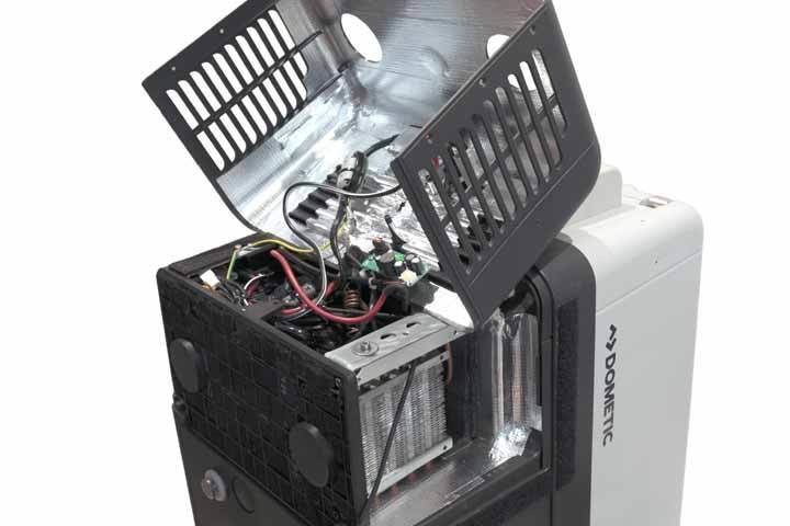

I also rewired the 12volt wire inside the fridge with 12awg. The original wire was barely 16awg. Also replaced the standard 2 metre cable which was 16awg as well. So there was about 0.17 volts saved. Shoved in a 7amp circuit breaker while at it.
I have modified the aluminium angle since these photos, tapering it down a bit towards the condenser fins. But it is splitting hairs looking for efficiency.
This was the only spot I could fit the circuit breaker on this fridge. The Anderson plug is permanently bolted on. Now I run 12awg or heavier to power the fridge.
I looked at the fridge today to see if there was anything useful I could add. Not really other than I washed the filter I put in & it was pretty dirty. It's a pretty open filter, but it is one layer of dust defence.

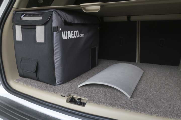

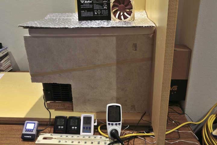

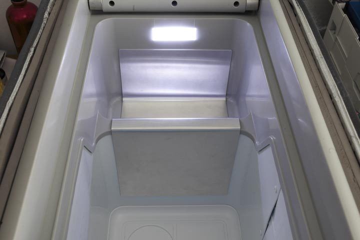

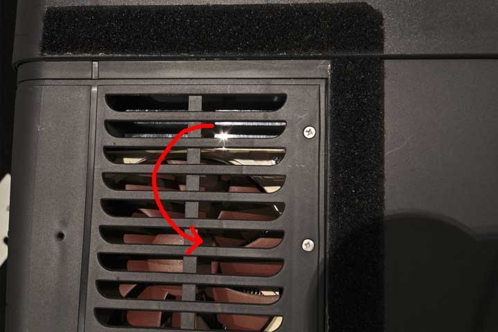

I heated a bedroom in the house for about 3 days to 35°C with three heaters (pretty horrendous electricity consumption) & tested the fridge with different levels of insulation. I also installed a very efficient Noctua fan in the fridge from an old computer. Put a baffle around the fan as well, as the fridge design was recirculating hot air. Added velcro as hot air was traveling up between the fridge & cover reducing thermal efficiency. With foam sleeping mats added efficiency is better than 30mm of XPS foam but I didn't have accurate figures.
