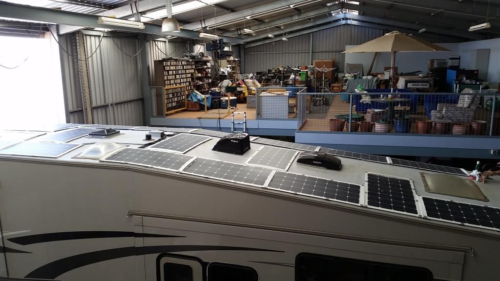

There is 1900w of solar on there. The idea was to be able to run the 3.5kW dual head split system air con 24/7, the big part during the day and the smaller head unit over the head at night. We ran it 24/7 for 3 days and it was back to 100% SOC by 11am on sunny days and 3pm or later on over cast days.

But it begs the question - 11 panels @ 100W = 1900W ??????
T1 Terry said
02:58 PM Nov 28, 2018
You can see 12 panels but the sun reflection makes it hard to see the other 7 panels up front, maybe they are easier to see from this angle, there are 4 panels across the front you can just see.
