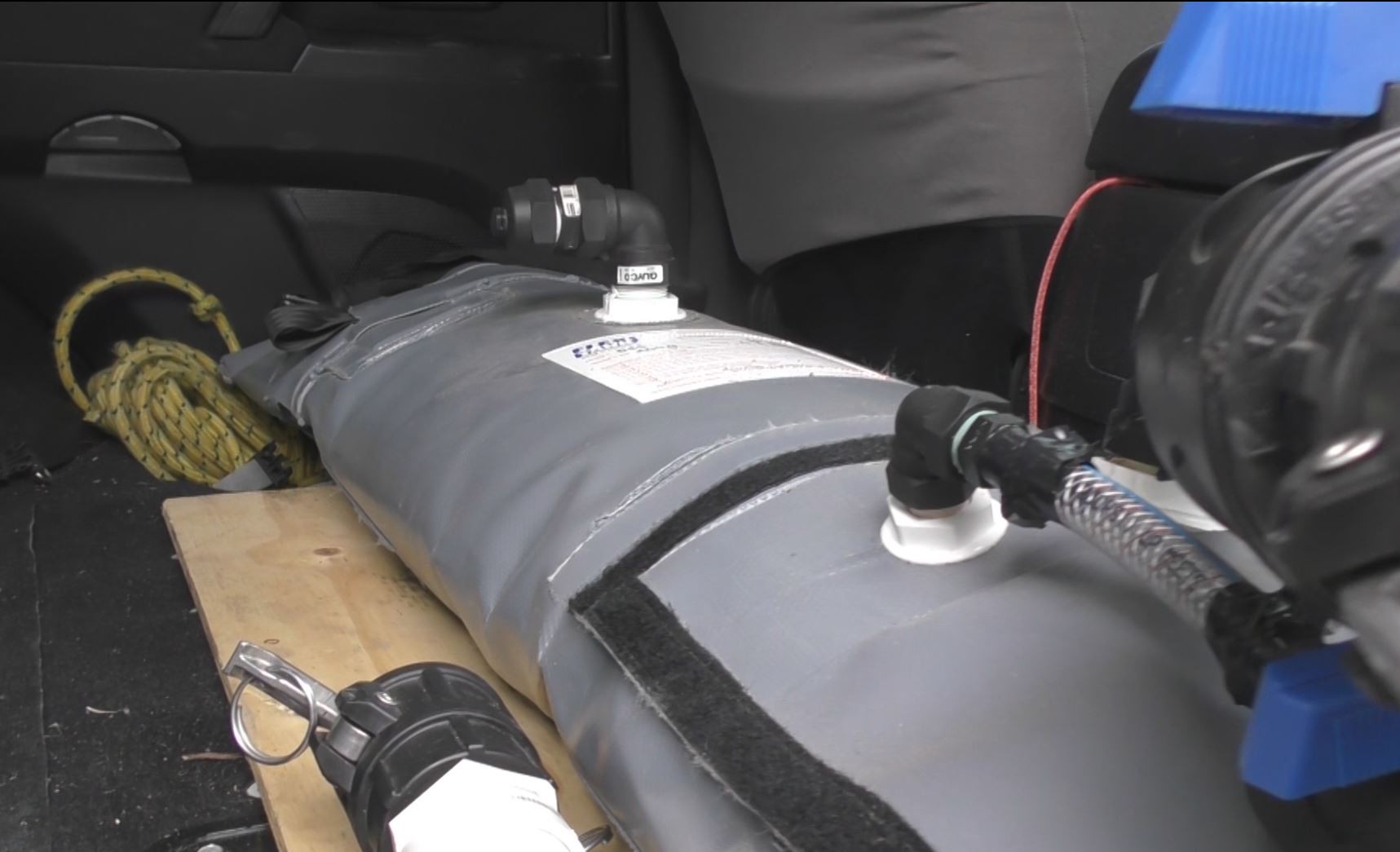

This thing is solid as and very well made. With all joins and mountings being top notch

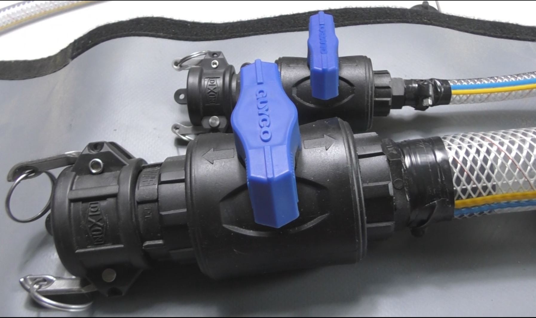

The tank itself has an inlet and outlet with the latter being the smaller of the 2 . All connections are fitted with cam lock type fittings which make for a positive join avoiding leaks
It also has a servo type nozzle for filling the car and a small but large volume inline pump making the job easy
Whilst I only went to 40L on the fill due to its first run and some improvements required from my technique. It went quite well.

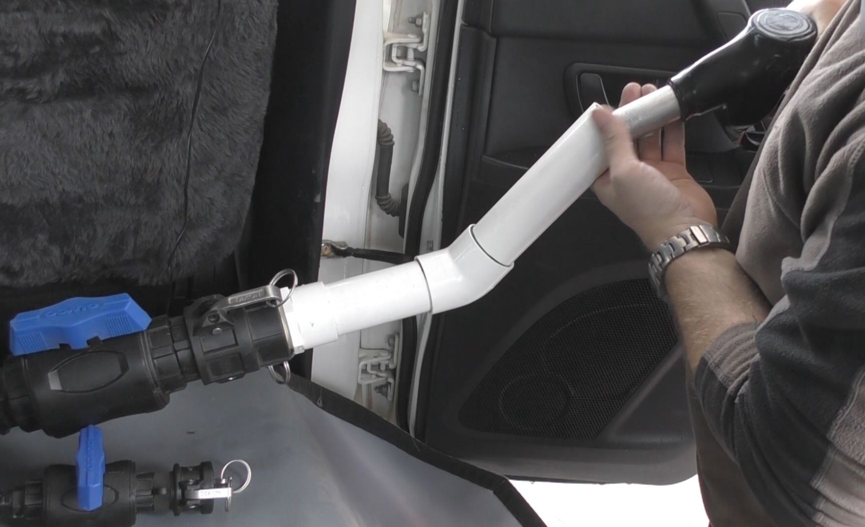

The owner had made a fill extension from some pvc that made getting the fuel in that bit easier and cleaner.

This what it looked like behind the front seats with 40L in it.

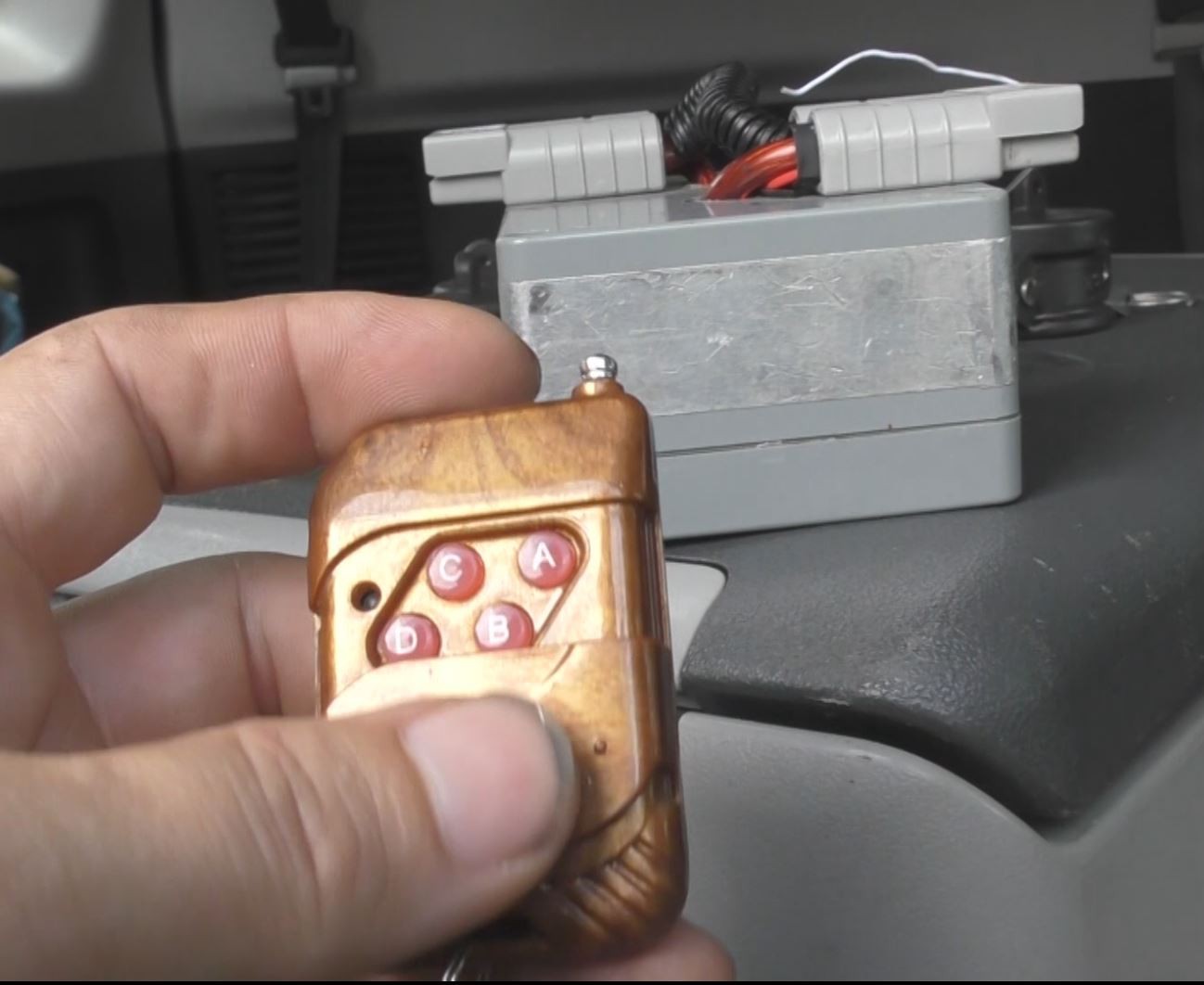

I had to remove the busted inline switch from the pump and chose to use my DIY remote anderson plug switch box, which allowed me to control it from outside the vehicle.

The bladder will hold 55L so that's an equivalent of all but 3 jerrys. I think this is easier for me to store and tie down than 3 of those.
It's also easier to empty than 3 jerrys as I can do it in one shot.

I cannot find any written information to support or refute my next question but years ago I was setting up spray tanks for chemicals that would be mixed or diluted with diesel and at that time we had to use aluminium camlocks as we were told that the black plastic ones were for water only. The seals as well needed to be Viton and not the standard rubber. Fuel delivery trucks use aluminium cam locks.
My question is; Are those camlocks approved for use with diesel?

I reckon if you only use the fitting for a short while and in a transfer use, who cares if they are approved or not. They are obviously made from Polyethylene so would be as tough as they come.
I mean would you doubt the use of a funnel made of plastic? As we are talking gravity fed here, it would matter little.
I reckon most o rings would take diesel pretty well and if they do leak, next time get some better ones as replacements.
We used to use elcheapo clear plastic to siphon petrol which has 10 times the solvent capacity of diesel. I can not remember ever being asked if it was a safe hose.

Re the cams. I guess so. This is a retail unit and flexitank make fuel storage bladders for all manner of applications.
I'd have no reason to see how they wouldn't be.
Do the trucks use the aluminum locks due to the fuel type or because of their constant use due to their application?
Either way, I don't know but know jerry cans and some long range fuel tanks are plastic based, so I reckon I'm ok here.

All in all, I would say my experience with it was positive one for sure but there is room for improvements.
I was unable to get the last of the fuel out but will work on that next time.
Emptying was pretty quick and under 4 minutes for the 40L
I think I'll also build a box to stick it in for some additional security and protection at a later date.
The little pump can also be used to stick in a jerry can and pull fuel that way.
This would make it so much easier than lifting the can up to empty.
If anyone has some suggestions on techniques for emptying or filling such bladders, even water ones, I'd be interesting in hearing your tips.
Any questions let me know.
If I had the means to store jerrys on the outside, I think I would have went that way myself.
