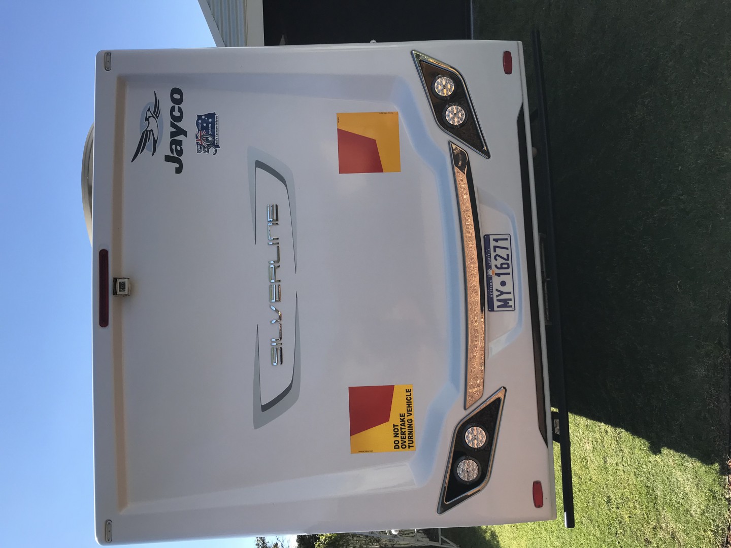

07:45 PM Oct 2, 2018
This is how mine are.
<edit> No idea why it is side on, not so on my pc.
