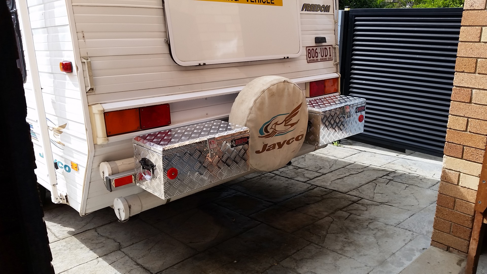

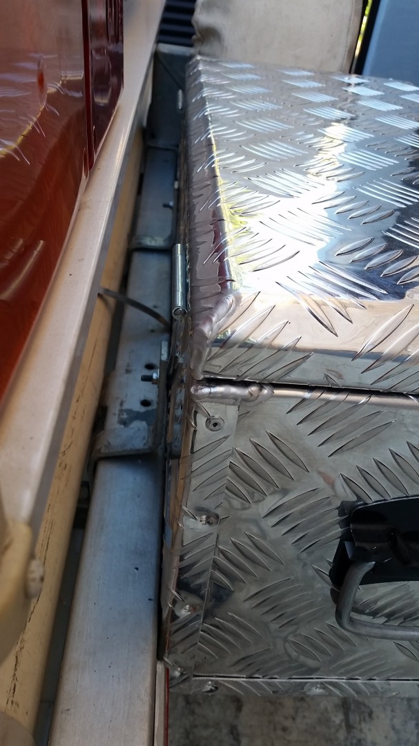

I fitted 2 aluminium boxes (Bunnings) and shaped flat steel to suit and bolted them to the rear bar (Jayco Freedom Tandem Axle.)
Needed space in the front hatch, too much clutter.
Only light weight items go in the boxes, also fitted on rear bar are PVC pipes holding aluminium poles, be carefull of the weight back there.
Bikes racks are a different thing again, they need holding in several directions as there can be a fair bit of weight swinging around with a back, (the pendulum effect) good luck with that part of your query.
