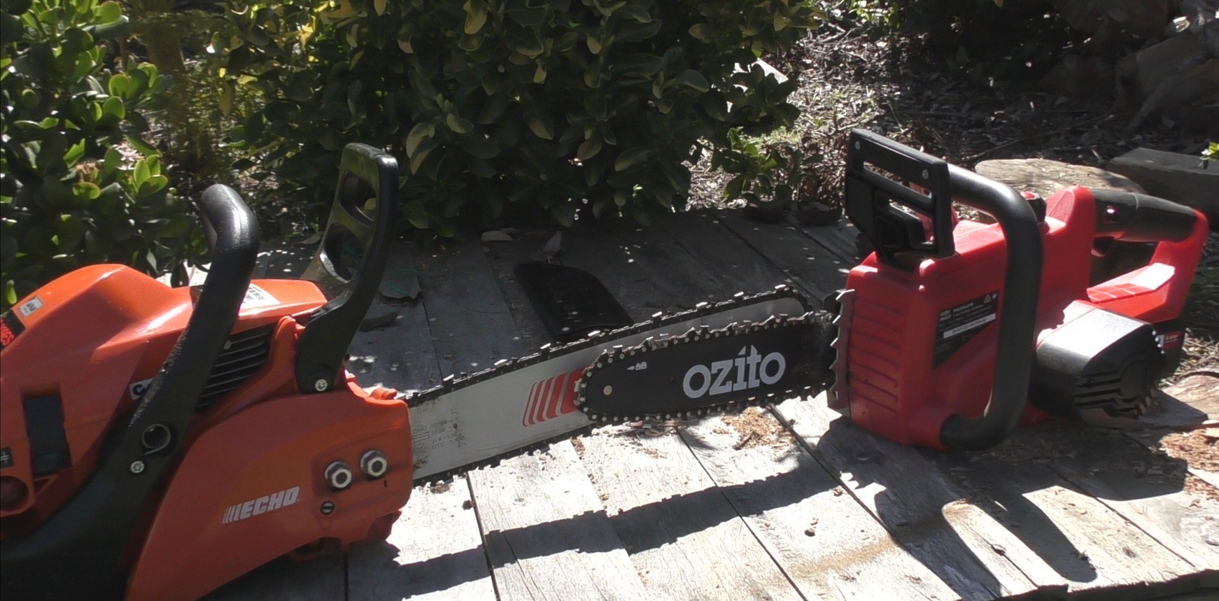

Now I'd heard that these are a rebranded Einhell product which seems to get good wraps. Word on the street is the red power x change Ozito stuff is a step up from their grey branded items at bunnings. I can't speak to those 2 points, but I do have a heap of their grey tools and haven't had any probs anyway.
The saw is only a 18v, so you can't expect the power out of one that comes from a 36v 2 battery variant. What I was really interested in was, where it sat between my silky big boy hand saw

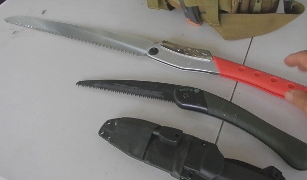

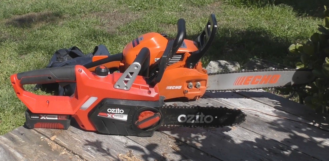

and my little 14 inch echo petrol chainsaw
These make up my usual equipment for camping, depending on location and fire wood or track clearing needs. I had a mate along as we were having a quick over nighter and thought it would be a good chance to test out the saw.

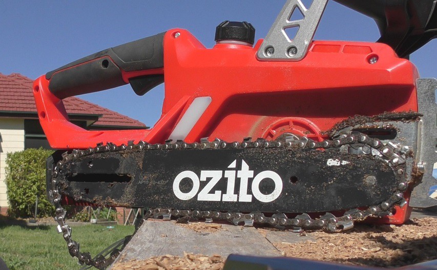

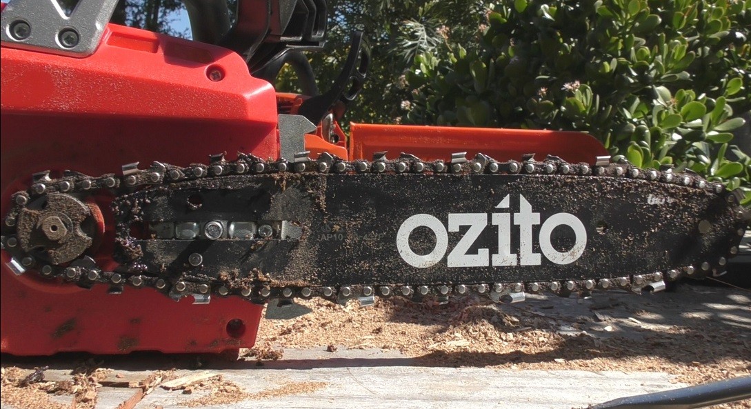

Specs wise it has a 10 inch bar which is easily removable (no tools) to make a smaller package for sticking in the car.
But the bar does look tiny compared to even the small bar of the echo
It's still a saw though in its own right and has requires bar oil and has a safety break mechanism.

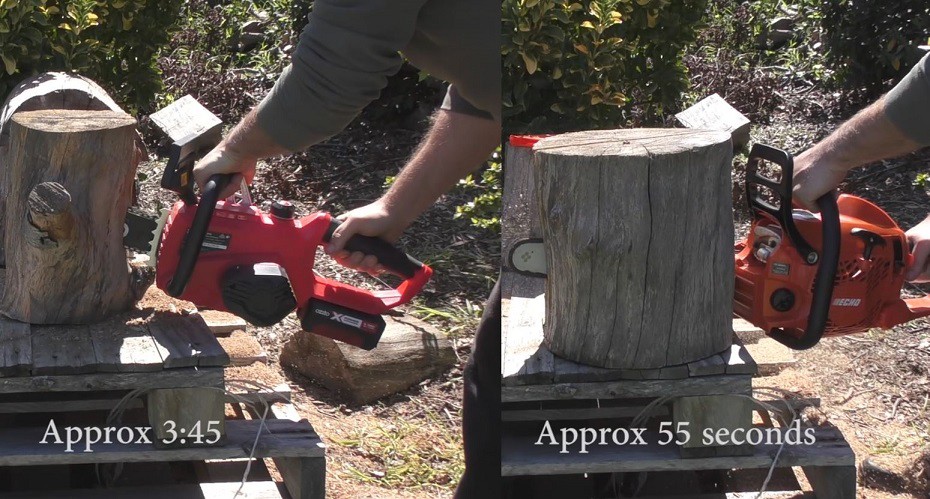

I did a test with both saws for speed, trying to make it as fair as possible picking wood that was near their bar length. The pics below tells the story there

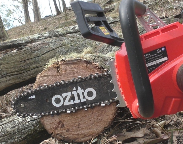

Still during our camp test, it still went through some decent sized timber
So overall, this will probably get duties from this point on for camp fire wood or just chucking in the car where I 'might' need a saw. I found when I was considering taking a saw just in case, I often wouldn't because of the hassle with storing fuel. No such probs here, so it will get thrown in more often now, when I otherwise might not have taken one. The silky big boy will still be there for back up.
