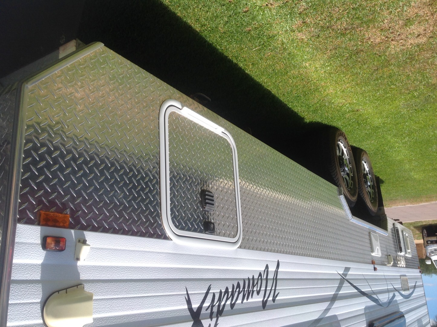

As well as aluminium chequer plate (normally 5 bar pattern) you could use propellor plate chemically polished finish it is lighter than chequer plate. If you keep it clean and rinse and wipe dry straight away, dont let water marks dry on it, it will stay good for a long time. I have not polished it on my van for 4 years now. For the first time this week I used Purple polish and deoxidzer on the front boot doors that get a lot of handling.
Thanks Moonraker, yours certainly looks good, can't believe that's been on there four years! The workshop that are going to do the job did mention propeller plate but I wasn't sure what the difference was except in pattern. So, it's thinner and has a better wearing finish? Mine's a light Euro van so something lighter and thinner would be suitable.

Mamill, Cheque plate would be stronger and possibly more durable as it was used orginally as floor plate and can be called aluminium floor plate where as Propellor plate is used mostly for cladding, I would say.

BushTracker caravans use chequer plate it looks tougher and probably is but some others such as Spinifex and Kedron use mostly propeller plate as it looks better and is tough enough for most use.
