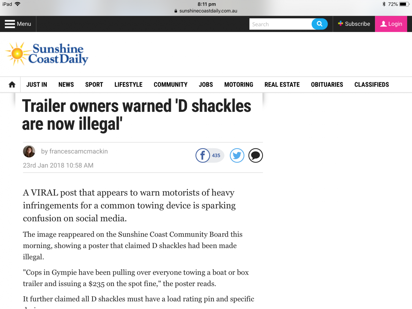

it was mentioned in post, vehicle towing capacity changes in general section that inspections for shackles were happening in gympie. Can anyone who was stopped please confirm this and tell us the date or is it just A furfy. I have never been stopped. I am not interested in chinese whispers, only fact By someone who was stopped. Thanks everyone.
Dave1952 said
06:20 PM Aug 21, 2018
Hi Rocket,
It was published in the Sunshine Coast Daily. The towing capacity changes do not come into effect until early September. Apparently the Gympie Police, according to the Sunshine Coast Daily, were also checking to ensure that people towing trailers, horse floats and caravans were using rated shackles, and not the mld steel unrated shackles which are also available at some hardware stores such as Bunnings.
I use rated 2.5 tonne bow shackles, as four years ago, when I checked the National Towing Guide, there was clear reference to shackle sizes to be used. Unfortunately, I lost all that data when my two external hard drives crashed, taking with them almost 2 terabytes of data and safety related information. I have been unable to find that reference since the hard drive crash.
Dave

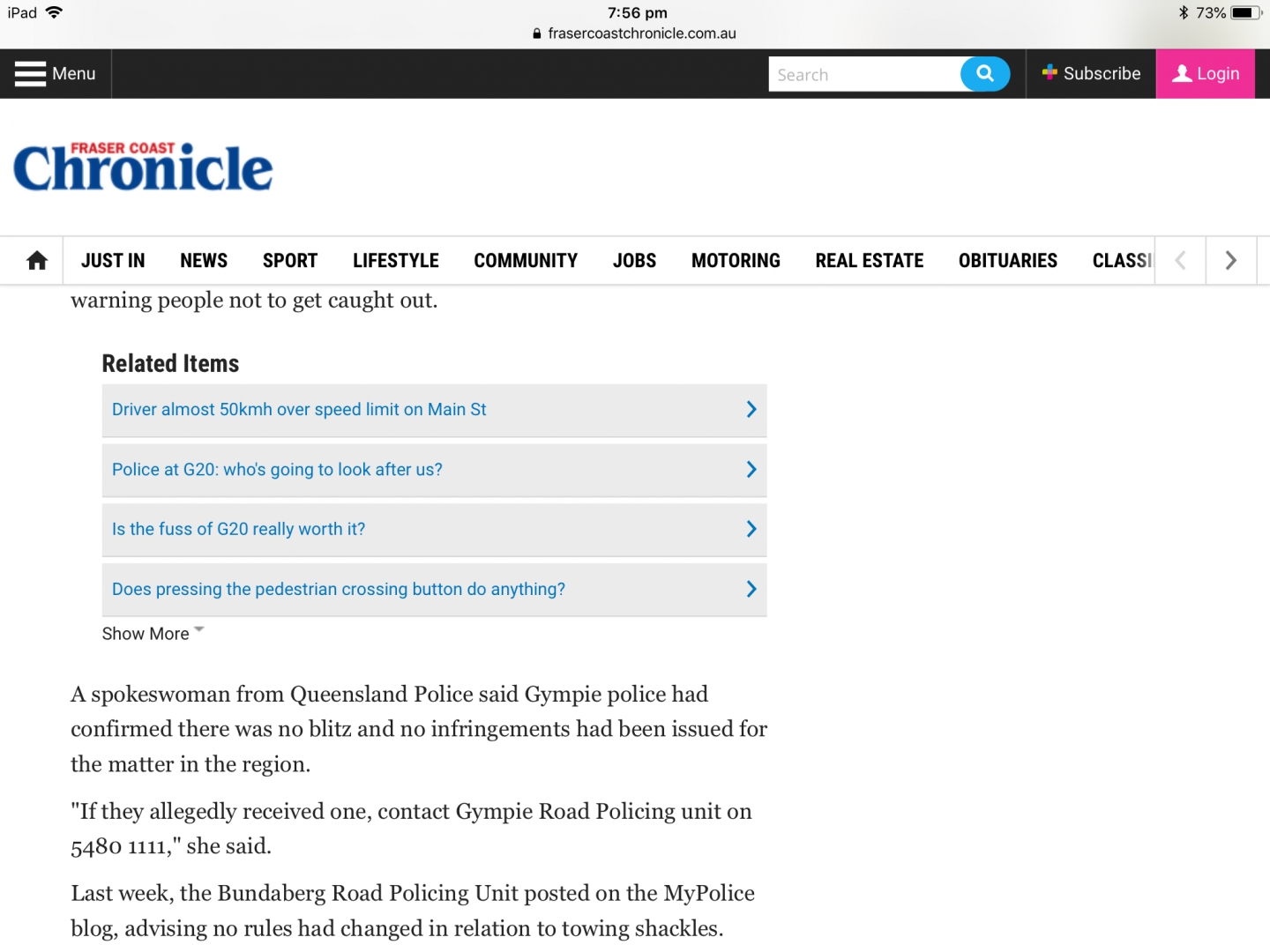

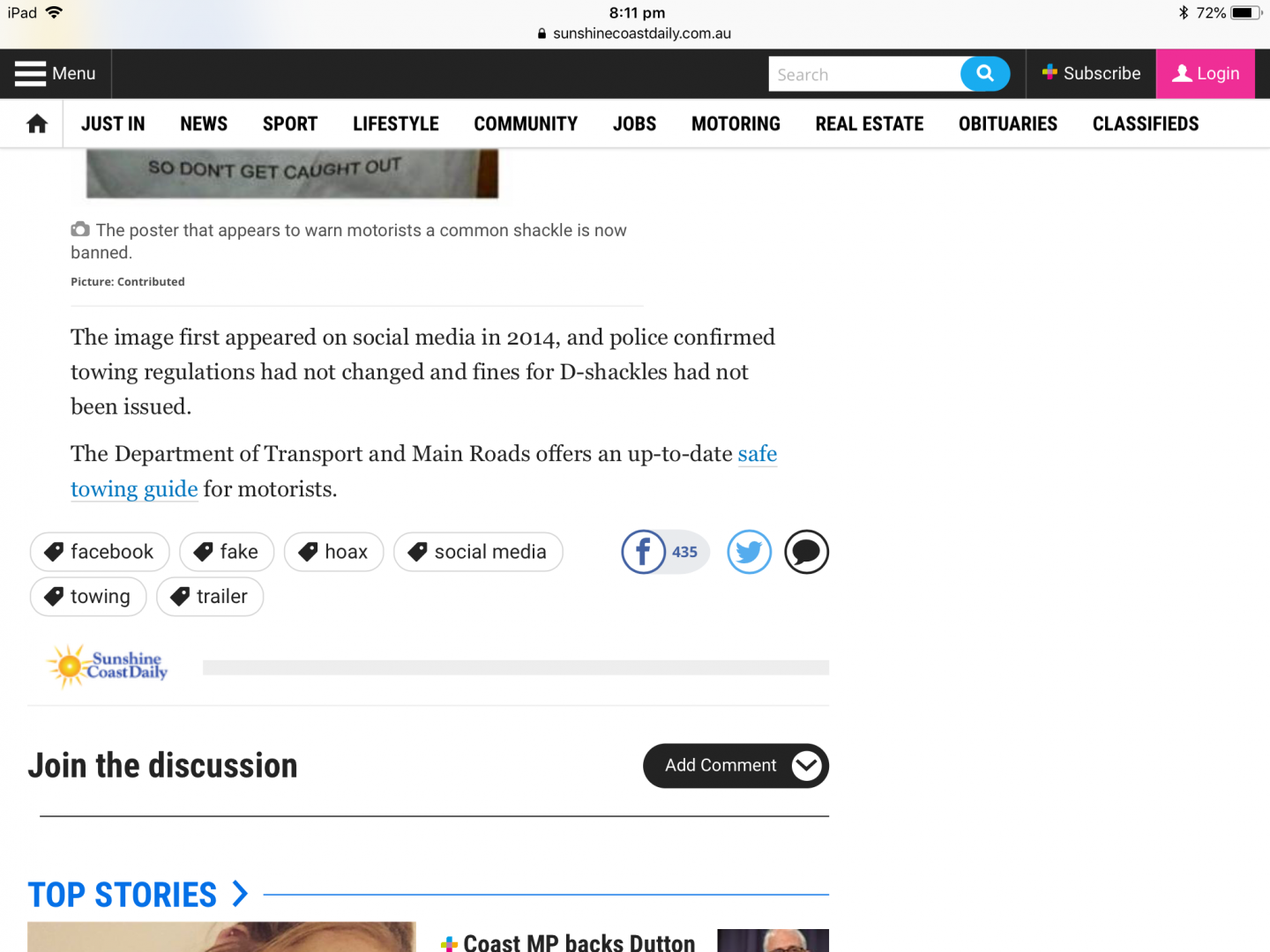

07:29 PM Aug 21, 2018
I understand what you are saying Dave. However, there was NEVER any bookings of drivers for having trailers/vans/horse floats etc connected and for not using rated shackles.
The standard actually states that the shackle needs to have markings that demonstrate it has the same 'rating' as the chains used on the van.
Let's look at other sources -
"Although there do not appear to be any specific requirements for shackles, the CIAA recommends shackles meeting the AS 2741-2002 standard be used to secure rated safety chains up to 3500kg capacity. In addition, they recommend that shackles should also have the following characteristics:
The shackle grade is S or 6.
The working load limit is 1000kg.
The shackle diameter is 10mm.
Either a bow or D shackle may be used.
So there you have it. Although there arent any specific requirements for the use of a rated D shackle when towing your trailer, boat or caravan, its still advisable to adhere to guidelines. After all, you want to make sure the components are up to the task."
"While there is an Australian Standard relating to shackles (AS 2741-2002), it only relates to the use of shackles for lifting purposes, such as lifting an engine into a car bay, not for towing. "Our understanding is that there is currently no regulation requiring shackles used on trailer safety chains to comply with the Australian Standard," the CIAV reported."
"Rumors about specific requirements for D-Shackles being enforced by police have been circulating around the country. These rumors claim police were issuing infringement notices for non-load rated D-Shackles used to tow caravan, boats and trailers. This information has spread throughout caravan parks and camping grounds and is now coming to the attention of dealers, manufacturers and state associations. Research by the Caravan Industry of Australia Technical Team shows police and state departments have denied these rumors, and advised that there is no specific requirement for D-Shackles."
So back to the original question of , was anyone on here stopped and on what date. And now another question, if stopped, what was the outcome?

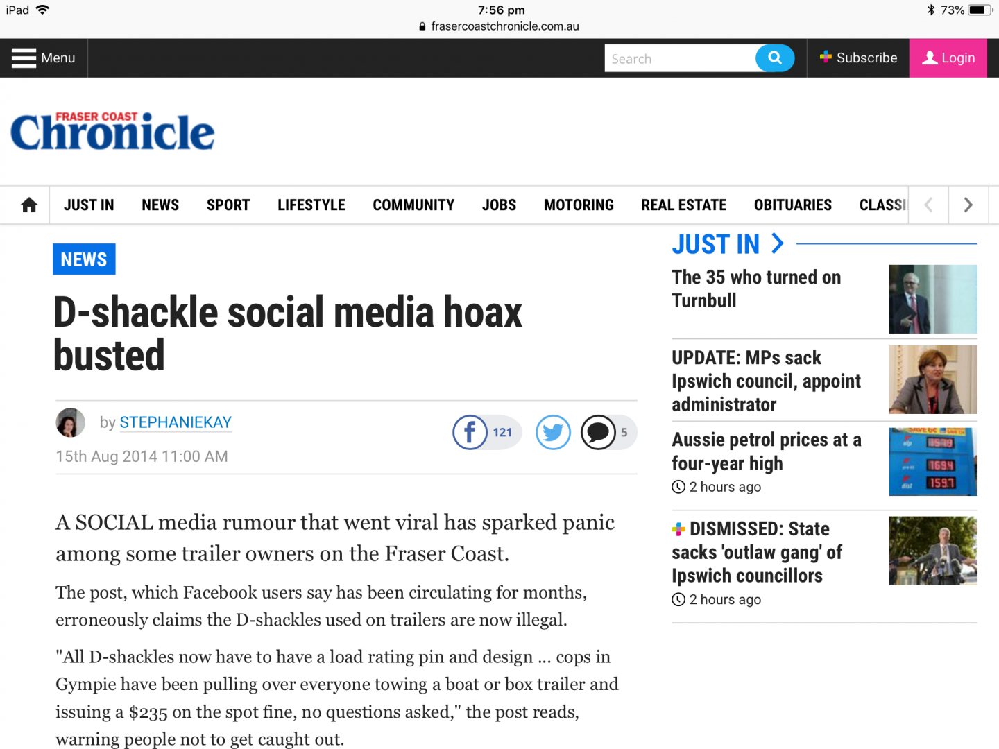

the rocket said
08:04 PM Aug 21, 2018
Dave1952 wrote:
Hi Rocket,
Dave
Hi dave, had a look online and this s what i found dated 15th august, 2014
-- Edited by the rocket on Tuesday 21st of August 2018 08:05:45 PM

Not too sure it was actually hijacked rocket ....
Your question was ".....inspections for shackles were happening in gympie. Can anyone who was stopped please confirm this and tell us the date or is it just A furfy."
I would have thought the information I had provided clearly demonstrated that the "inspection for shackles happening in Gympie" were 'fake news' and over four years old. There were never any inspections for shackles, no-one was ever booked, and it is NOT mandatory to use rated shackles to secure the safety chains on a caravan.
https://www.timetoroam.com.au/rated-d-shackles-towing/
An interesting article from 2017 maybe this answers your question Rocket it pretty much backs up what Rocky posted earlier.
