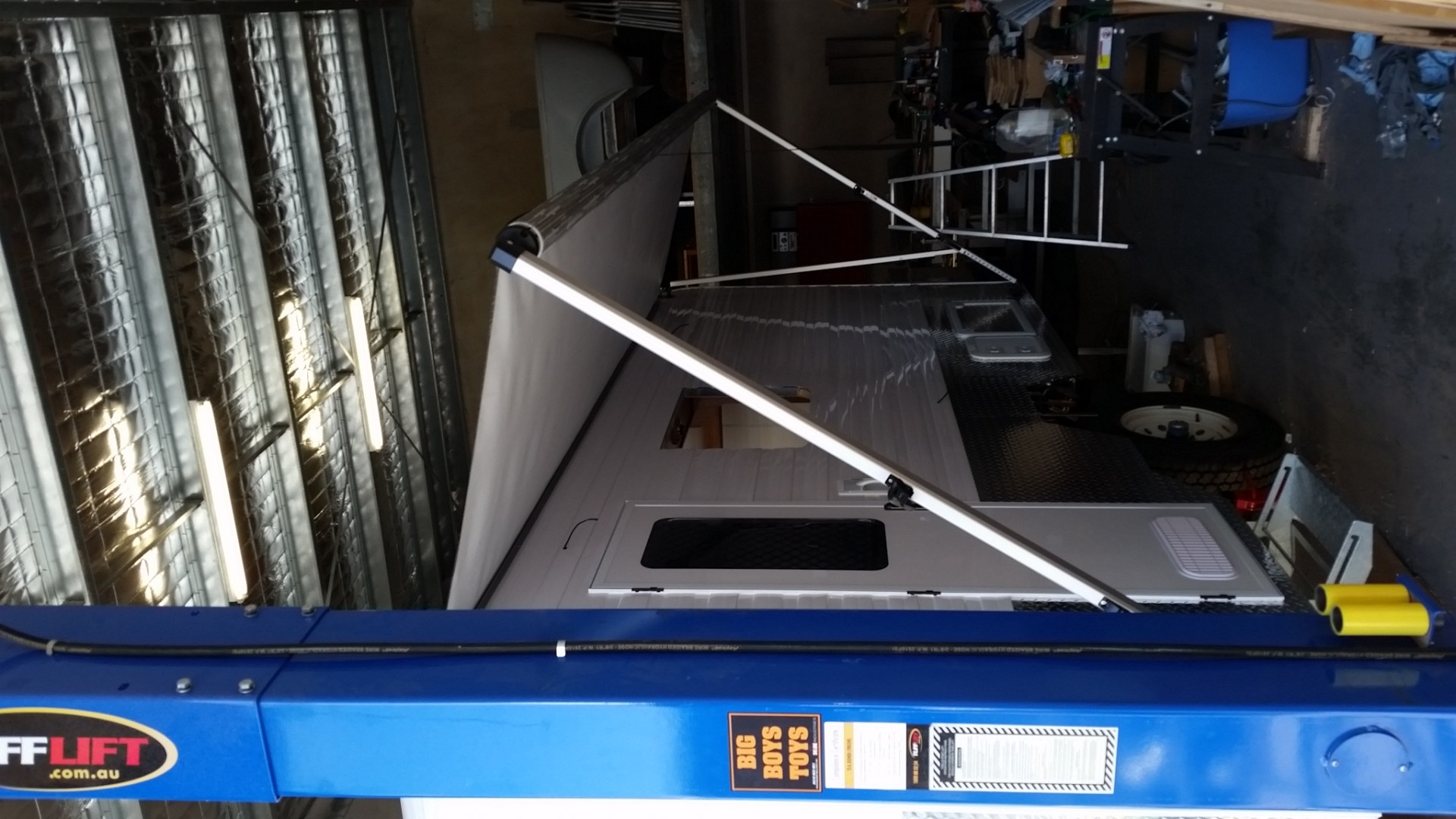

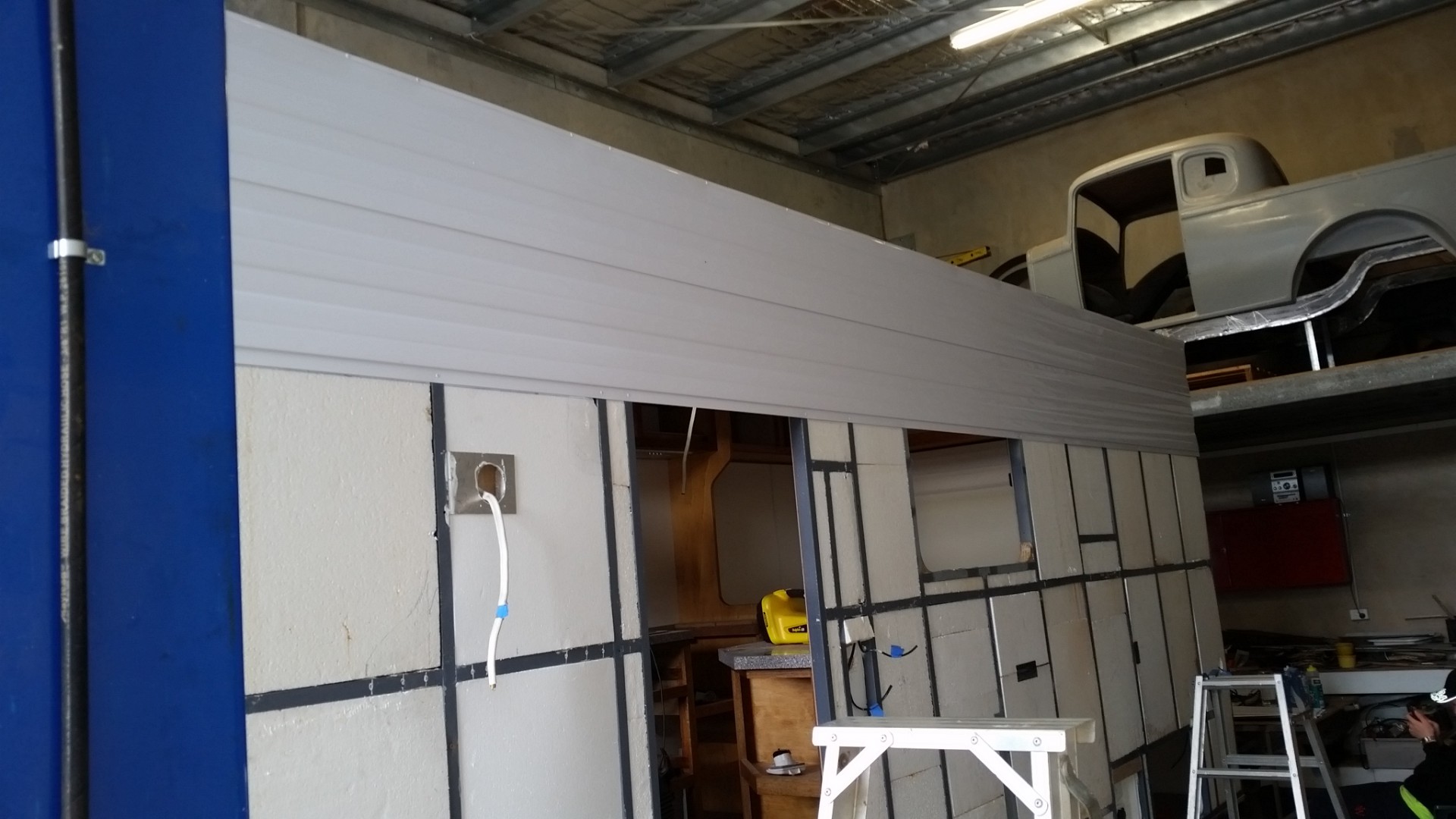

Hope everyone is well, ive been reasonably busy on the old van in the last week or so fitting the propeller plate, door, step and awning etc. The propeller plate is glued and screwed where you can't see, i then trimmed the roof sheets and bent them over the wall cladding trying to reduce any chance of water leaks that was followed by the fitting the true line j moulding which i sealed with boston v 60 and screwed in place with self drilling screws and nylon washers. The door fitted quite well within the tolerances set by the manufacturer i only had to skim the welds in the top corners of the wall frame so the door frame will fit in place other than that i was happy with the way it went together, i opted for a single galvanized step with checker plate for the step to reduce the chance of slipping and i must say it sure beats using a milk create.
The awning i have fitted is a 14' care free fiesta i am still deciding whether or not to put a support in the middle even though its only 14' there is still a bit of weight in the middle unsupported and when travelling down heavily corrigated ungraded roads may cause it to bounce in the middle who knows. i am currently sorting out parts for the windows which i have taken out the glass and replacing that with poly carbonate which has a 10 year guarantee, scratch resistant etc the chap who supplied it is one of the nicest people you may come across and very helpful too he has over 30 years in the plastics industry. So if your thinking of changing windows his company is Golden West Plastics in Kelmscott WA.
