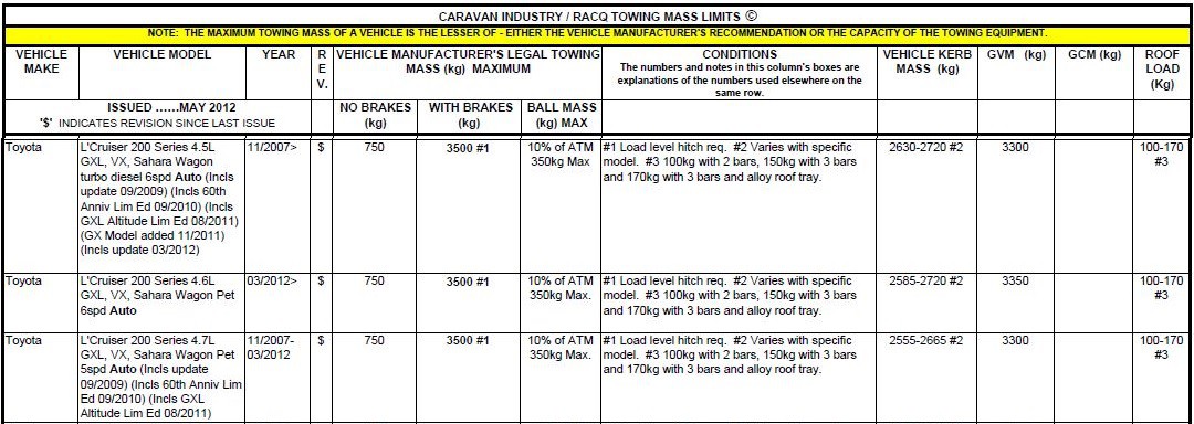

Landcruiser 200 has between 100 and 170Kg carrying capacity on roof - dependent on configuration.
See #3 note in this table -
As per earlier comments, Toyota 200 series has not much payload and therefore easy to reach/exceed GVM ... also it is quite easy to put too much on the roof.
A couple of lightweight tinnies worth a look include the new 320 and 360 Wanderers (50 and 53kg) and the Stacer 319 Seasprite (58kg). The boats can navigate lakes and estuaries and their modest weight makes them easy to launch and load from the roof of a 4WD.
Whichever way it is counted, carrying a tinny and loader on the roof of a 200 series is heading to having GVM problems. The "170Kg" that is 'allowed' on the roof is part of the payload as is the towball weight, passengers, knitting bag, Waeco fridge, extra pair of boots, bull bar etc etc

Available roof top weight = 170Kg (with conditions)
