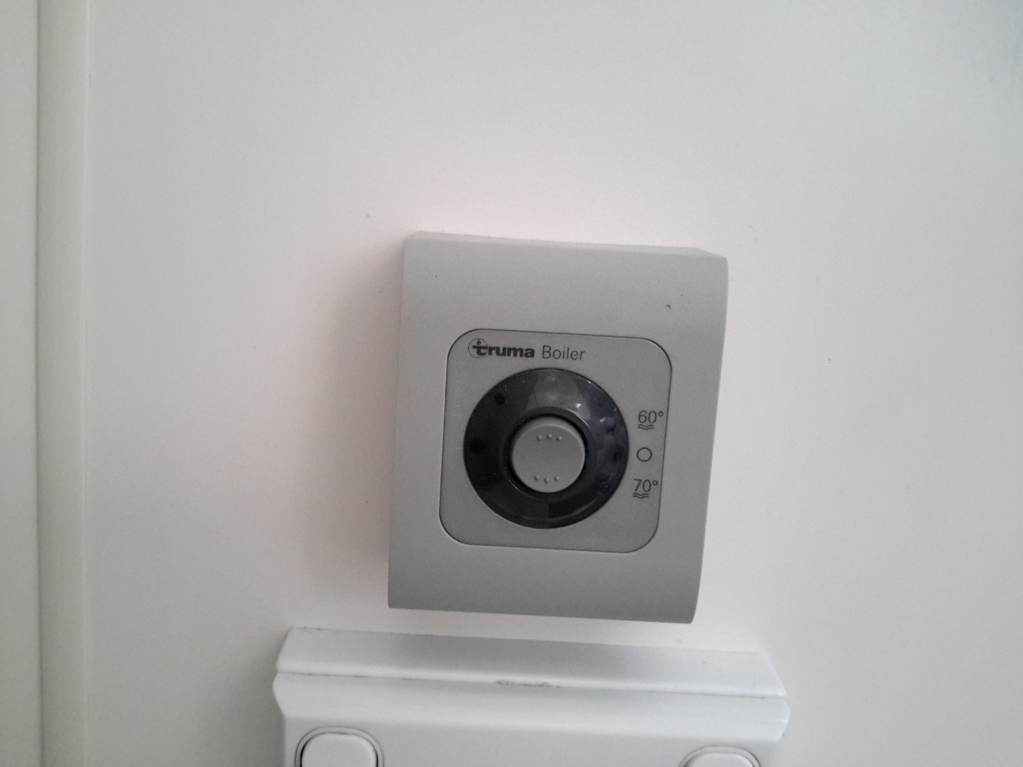

You have fail to mention the gas tap near the boiler which we turn on and off depending on use.
Second maybe is the temp switch set on high, we did have a faiure here when I switched it to high but found it was working ok on the lower temp which is all you are going to get anyone because of the tempering valve which will lower the temperature to lower then 70 degs.
If there is air in the gas line (like after changing bottles) it can take a dozen or more tries to fire up. Keep trying. It may also help if you light the gas stove to purge some of the air out.
It should not make any difference what temperature it is set to.
14L of water at 70C is more usable hot water than 14L at 60C. Cheers, Peter
