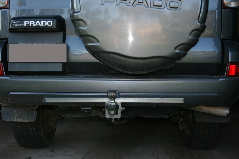

They are not a waste of time! Even with a guard fitted, I destroyed the end cap of the water tank (100mm seer pipe) on my camper trailer years ago (got two buckets of rocks up to 65mm out of it in Adelaide). Fitted a new cap & reinforced the guard - the rest of the trailer was unscathed. That was from a not so good road via "Old Cork Station" in the Diamantina NP.
I'm on Mk 4 stone-guard at the moment. Home-made Stone-Stomper didn't like my hot exhaust (with gas injection) - current one is "similar" but not adjustable to the Rock Tamer. Is bolted on to the car, U-bolted to towing hitch. No stone damage yet to the van but have replaced a couple of the mud flaps (ex SuperCheap) due to stone damage. Cost to build was 4 heavy duty mudlaps, a piece of 25mm square tubing, some angle iron & a former springs U-bolt from my "junk" box.

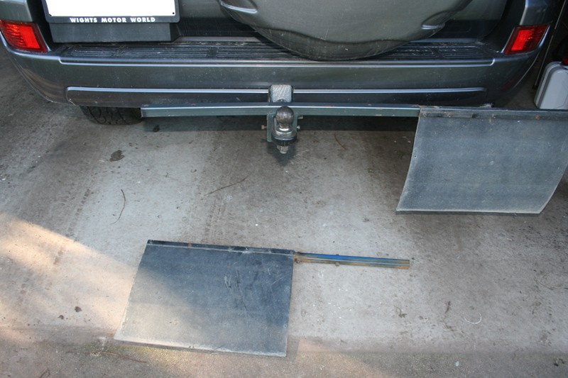

They are a great help.Made mine out of square tubing,and was given a strip of old conveyor belt for the mudflaps.
Just slide the mudflaps out when home,got the exhaust place to redirect the hot fumes to the side,that cost $30.the rest cost about $14.
But the best protection would be the Stone Stomper.
I'll do a bit more research to keep my pretty van pretty

If you do decide to make your own (mine are similar to Plain Truth's except the quick ability in removing them) - don't feel you have to fill in the whole width of the car with rubber (you do see them occasionally) - that reduces the ability to cool the diff in hot weather.
The previous police senior constable at Birdsville suggested to a friend that the flaps should not be solid - slotted reduces the speed of the stones better.

The damage to the car is caused by stones being thrown by the car & rebounding off the van (gas bottles, etc) & smashing the tow's rear windows - which are expensive. I believe the rear window on a 100 series TLC is somewhere around $800 while the small one on a Patrol is $1100!!! Any stone guard is better than that!
The guard I had on my camper (tent) trailer - I made with square steel tubing, shade cloth & two mud flaps. As the shade cloth was not as tight as the bought ones, it collected a lot of the stones without throwing them back & the cable ties that I used to attach it with kept getting cut from the stones - wire was the best! I hinged that guard so that I could access my spare tyre, etc. With the commercial ones, you'll see that they are placed on an angle to deflect the stones down. But if you go that way ensure you can access everything you need to. A friend had access problems to the boot of his Jayco Eagle.
I would suggest that the best type is the one that attaches to the car. You didn't say what sort of car you have but Plain Truth's (Pajero) guard & mine (Patrol) are similar, a friend has a home-made one on a 100 series TLC & another friend has one on his MUX. With a bit of thought & mucking around, one can design something that will fit. With the depth of the flaps, allow for any drop of the car's suspension when the van is fitted otherwise you'll be sweeping the road!

Thanks for that Warren I have a Challenger (Pajero)
i can weld and we have a mine just out of town and they have
a belt that I can use the rubber off
so looks like I'll try to chuck something together this weekend
to keep the pretty van pretty
thanks to everyone for there help
