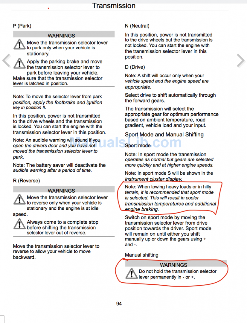

This is the Ranger manual I was referring to, they cover their butts by saying "use S mode in hills or heavy towing" then go on to say "don't use S permanently".

Think you need to reread the manual carefully Delta 18 .the section between your red highlites needs to be included and understood . With the ranger and bt50 ( same box ) when you select sport mode it drops out 6th gear and changes the shift patern slightly , but still acts as an auto BUT as soon as you use the + or - to manually select 1- 2-3-4-5 ( yes they do have them on the dash cluster) etc you override auto altogether.

So in short the manual is saying dont use the plus and minus continually not dont use sports mode

The manual is telling you not to hold the gearlever in the plus or minus position, just bump it to change gear & let it return to its normal position, been towing for years with ford boxs & never had a problem, carnt say for the ranger but the territory will lock you out of 6th. If trans. reachs a certain temperature, keep driving as normal & in 5minutes or so it returns to normal, happened to me only once flogging up the adelaide hills on a 40deg. Day towing the van.

Guys ,just wanted to share the email I received from Ford re towing in S mode .
Thank you for your e-mail to Ford Motor Company of Australia Limited (Ford Australia).
In relation to your enquiry about towing with your Ranger. In the owners manual it is stated as follows :
When towing heavy loads or in hilly
terrain, it is recommended that sport (S)
mode is selected. This will result in cooler
transmission temperatures and additional
engine braking.
Switch on sport (S) mode by moving the
transmission selector lever from drive (D)
towards the driver. Sport (S) mode will
remain on until either you shift manually
up or down the gears using + and -.
