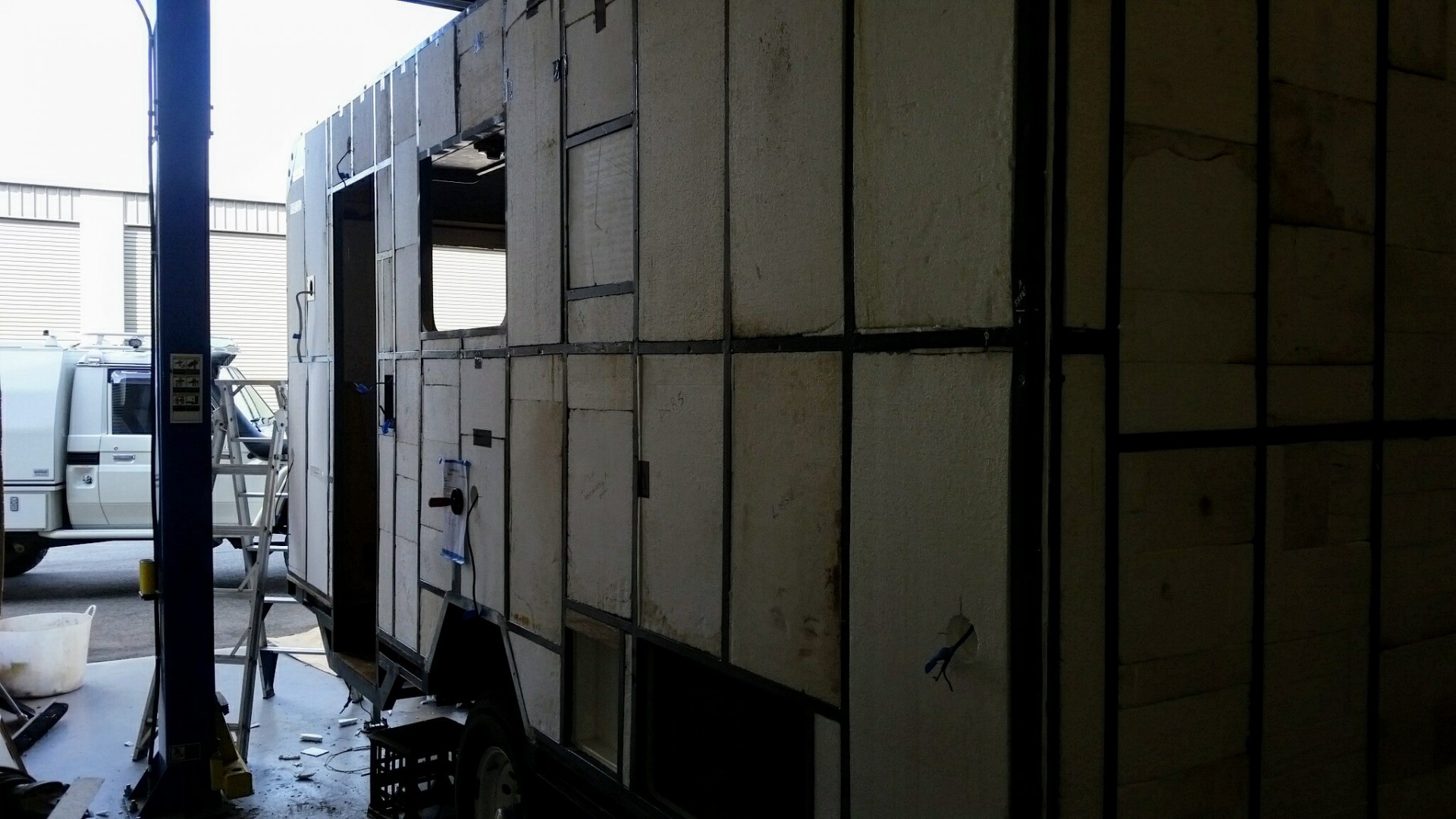

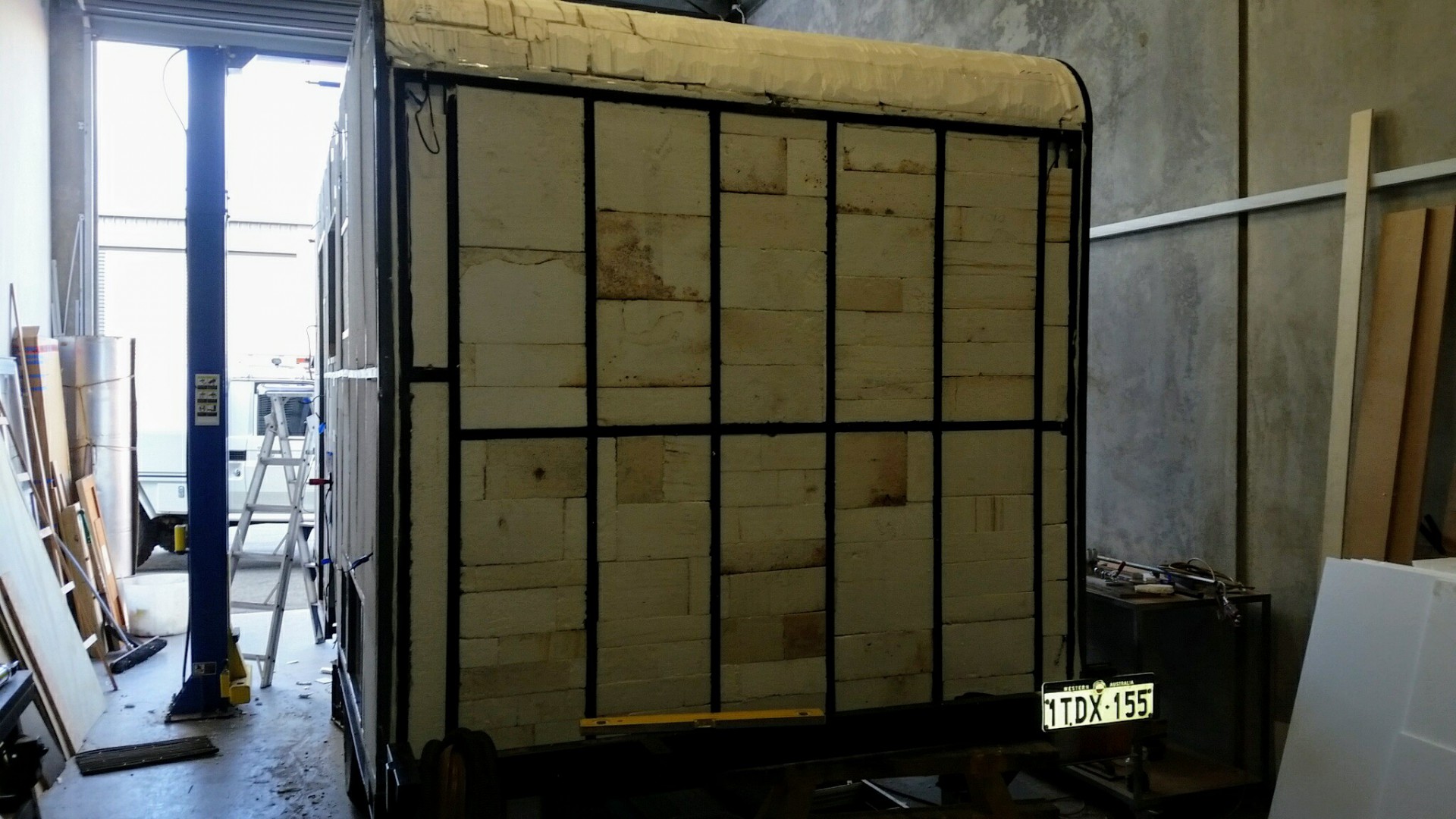

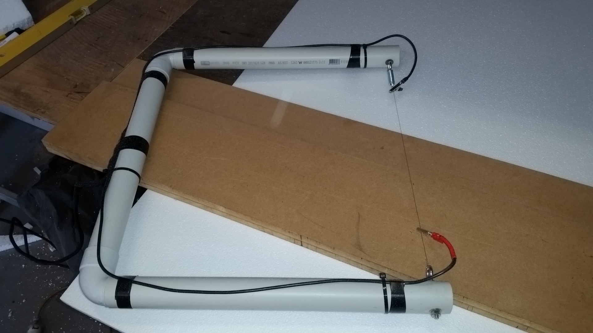

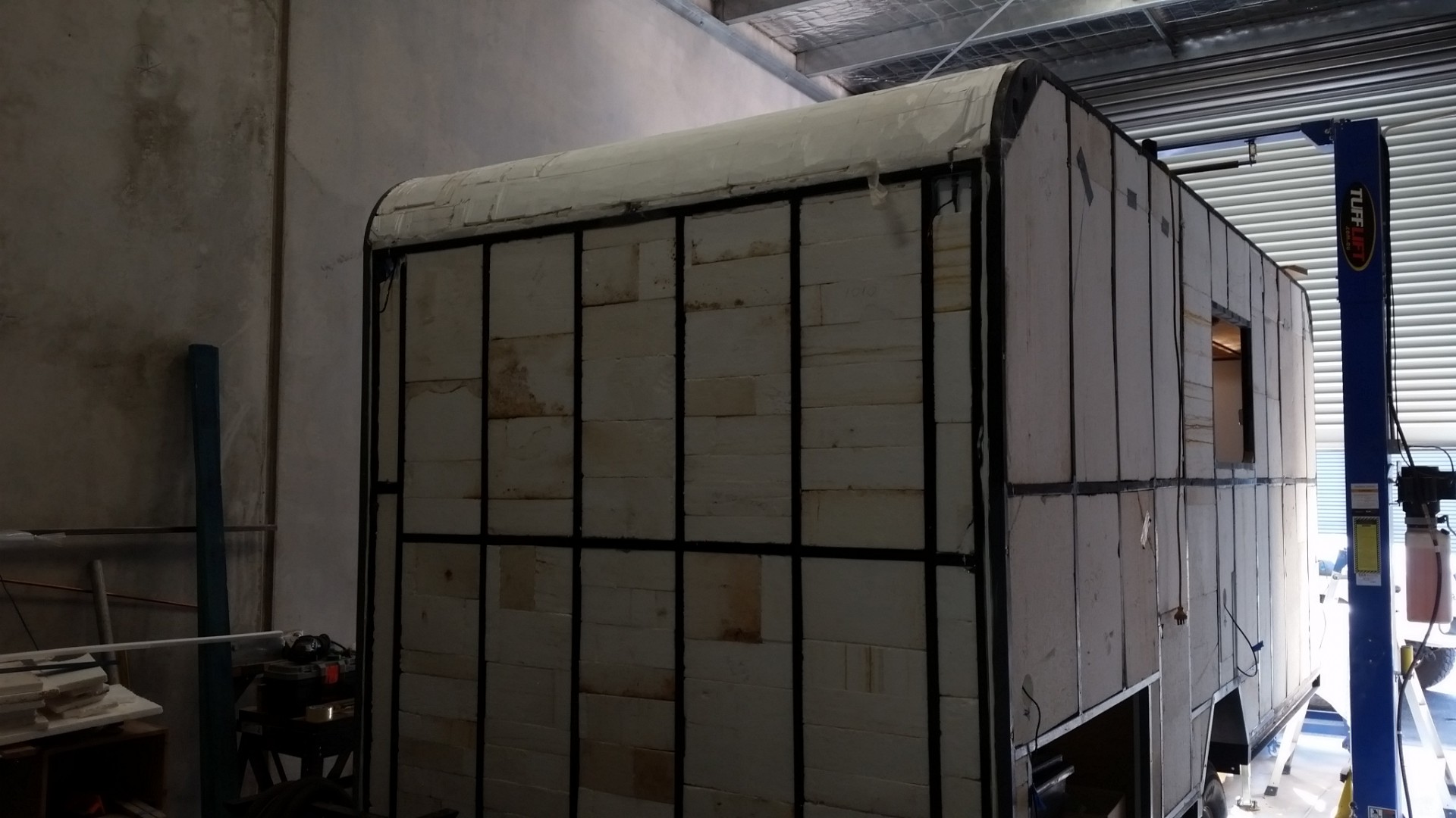

I had said that this post would be in a few days but i kept on forgetting to take pictures of where i am at on the rebuild, in this post i am finally putting the insulation back in the van. The insulation is polystyrene the original poly used on the van is 25 mm thick so i added another 10 mm to it to give me 35 mm thick leaving 4 mm in the cavity not that you can see it as the frame is 39 x 25 mm tube. Speaking of tube i love looking on you tube if i am not sure of things as they have some great information, well i was curious how to cut the polystyrene with minimal mess i have seen hot knives and hot wire cutting machines on ebay before so i thought i would look at you tube. I came across a video of a hand held hot wire cutter similar to the one i made in the following pics, i was a bit worried when i saw it hooked up to a battery charger but it seemed to work and did a good job as the fella was making model glider wings pretty impressive i thought. Well i thought i would make one, i figured that it will work or i would probably get electrocuted but gladly it worked you will see to alligator clips on there so you can a just the resistance or heat in the wire. I used an old charger which i had and made the frame out of pvc pipe from bunnings making sure that the throat was deep enough to cut the widest panel i needed, the wire is ni-crome from memory and attached to a spring to help keep tension in the wire.
In the pics you will also see that i have finished insulating all four walls and i have also finished the roof, i shaped the round corners on the front and rear of the roof with the hot wire then smoothed them off with a belt sander. Tomorrow i will start fitting the exterior wall cladding to the van and see how that goes.
Once again thanks for the kind reply's as they are very inspirational.
