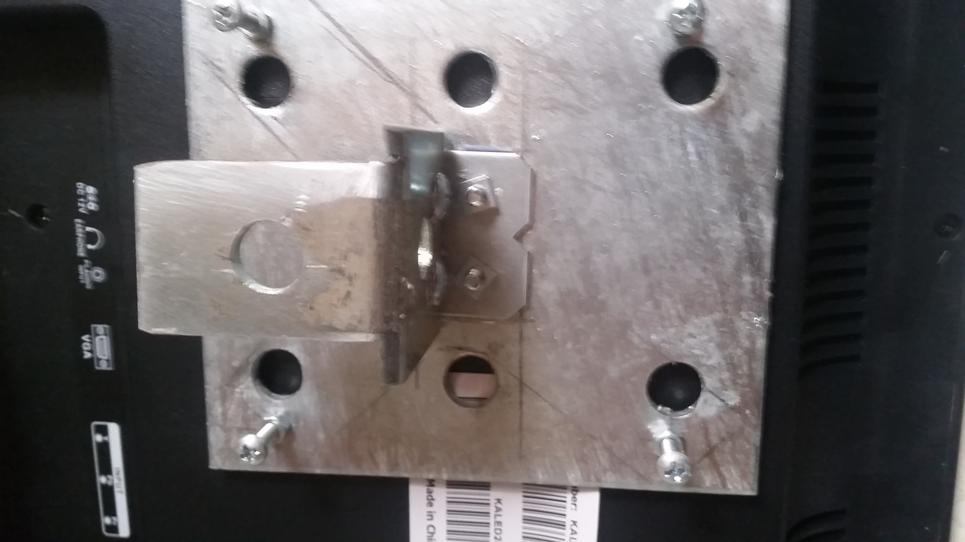

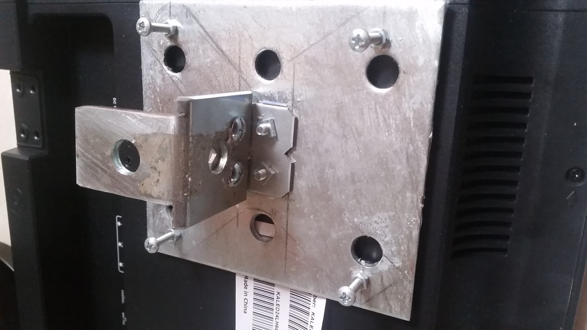

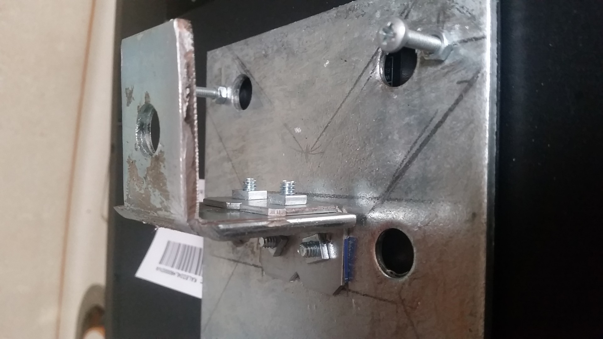

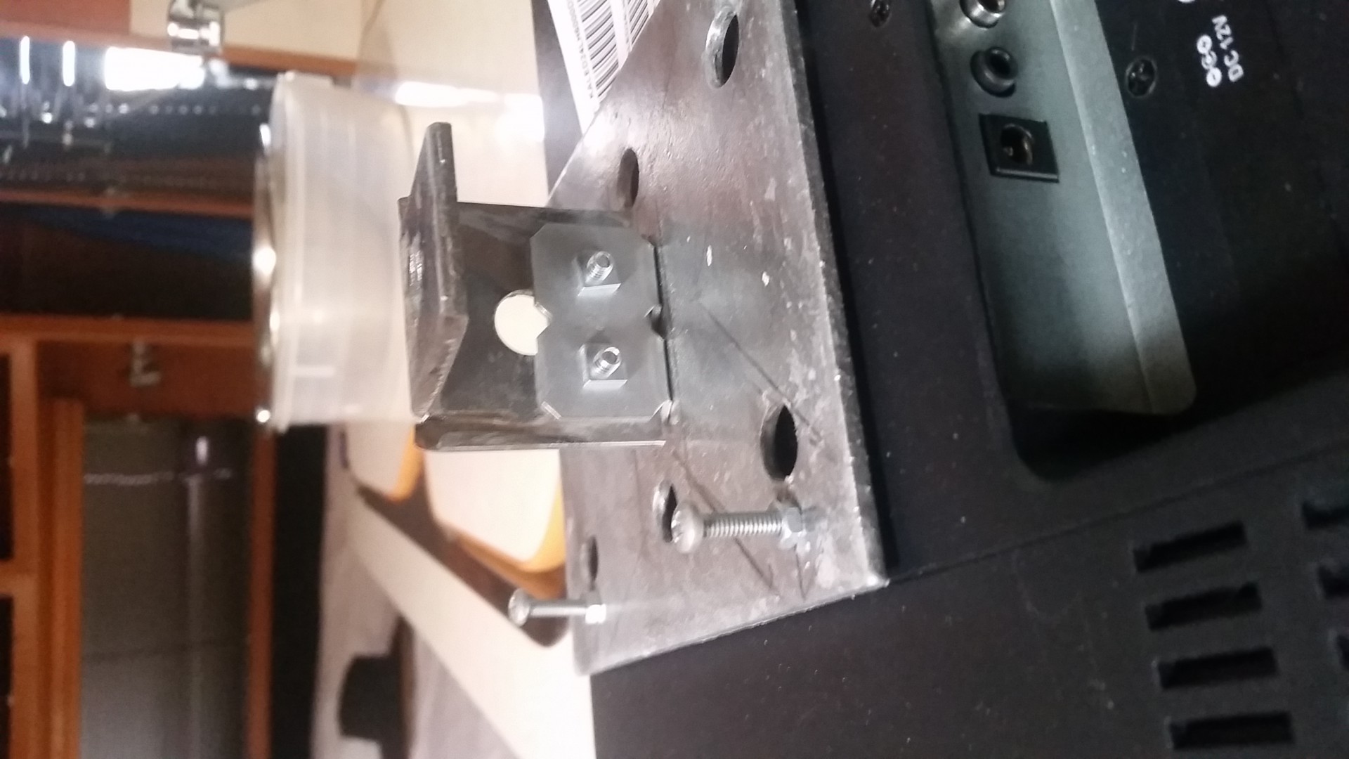

Hi Bill, we had to do the same thing, depending on make of tv bracket, some you could buy just the end bracket but for ours you couldn't.
went to Bunnings and brought the pieces and made my own, cost about $10 to make. pictures attached. hope it helps.

Thanks, for the info Ross, I have probably got enough supplies in the shed to make it. I will certainly give it my best shot as the Co-Pilot wants it above the bench.
Bill
