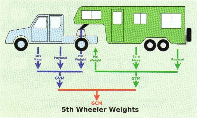

The suggestion to go and look at the Winjana range is a good one. If you are getting one of their models then a twin cab ute would be a good choice. Look at this page to see the tugs they suggest. If you are settling on a van 27' or smaller then there is a selection of twin cabs that will cope well.
1.. The pin weight of the 5th wheeler will vary. Download some specifications of the models you are interested in and check out the pin/hitch weight. Winjana's biggest model has a hitch weigh of 420 kg.
2.. The newer twin cab utes are much more efficient than the old antiquated lumps of cast iron that you are considering. They last well as well. My Disco tD5 ran over 260 km with plenty of towing and it was only a 2.5 litre motor.
3.. The only reason for upgrading the suspension of the tug is if you are going to overload it.
4.. Other suggestions - many of the manufacturefrs web sites have good suggestions as well as specifications for their vans.
The ATM of the van you choose will determine a lot. Under 4.5t you require electric brakes. Over 4.5t you need air brakes.
The pin weight (download on your hitch) of a 5er is 15-20% of your ATM and is included as payload. The tow vehicle needs sufficient GVM and GCM. Neither of these ratings can be exceeded.
If buying 2nd hand I thoroughly recommend using a 'vehicle compliance engineer' recommended by the Caravan Council of Australia.
Do your homework and research and verify everything you are told. Some authorities claim that up to 90% of RVs have some compliance issue and my research would tend to confirm this.

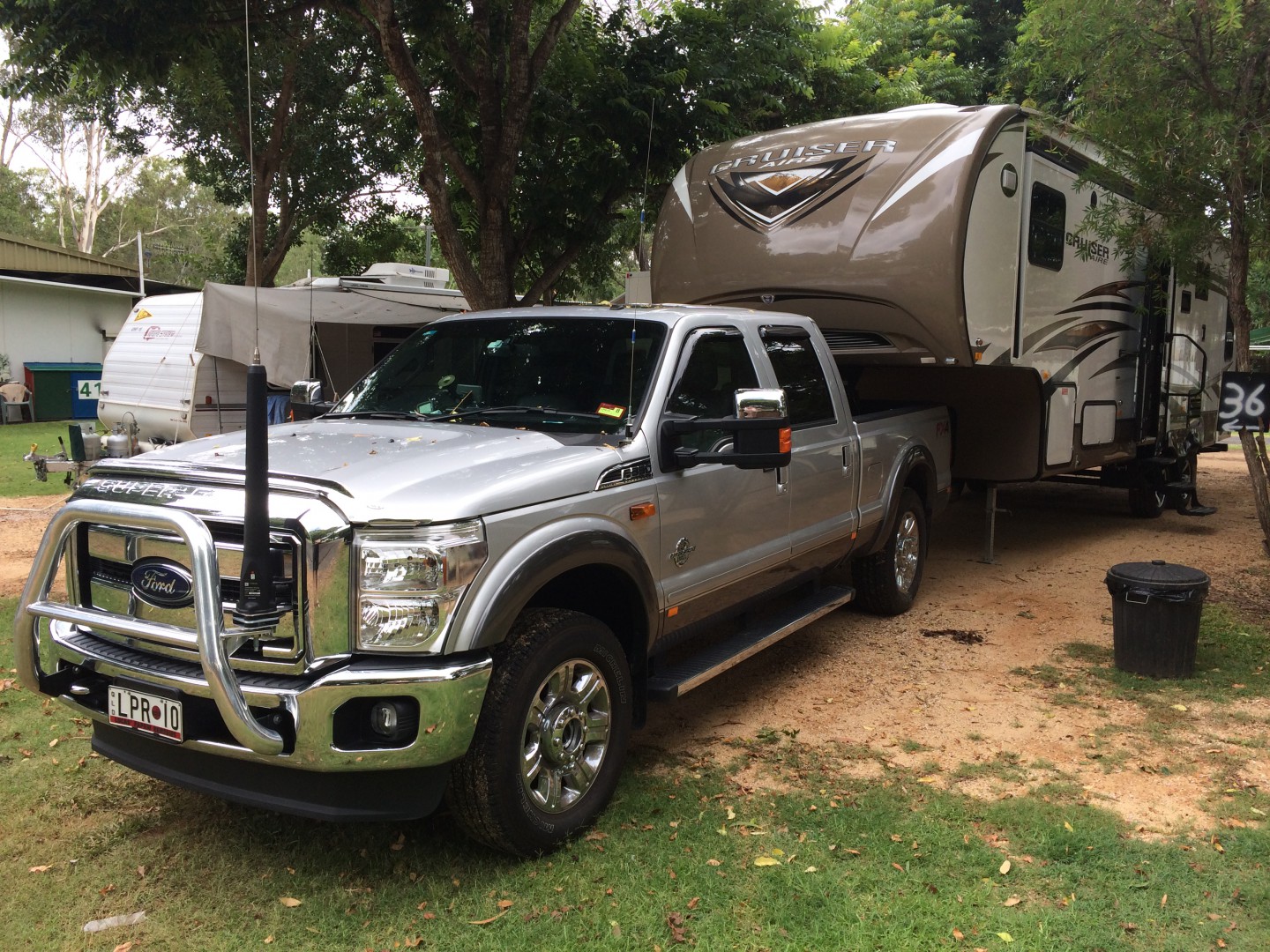

Hi Paul & Orlean. We own a Crossroads Cruiser 29ft, three slide outs and all the mod cons. We tow with a 2012 Chev Silverado 2500 LTZ.. The rigs are a breeze to tow, and are very stable on the road. I thin for memory my dead weight on the Chev is around 300+ KG
Ours is FULLY Australian Compliant. in fact it has just passed its Vehicle test for Qld, as we have just moved across from WA.
We are looking at selling our rig, which as I said is fully loaded with all the mod cons and extras, like Sat King Satalite dish, Smart TV, Wine fridge, Dishwasher, Leather recliner rockers, Twin 110 amp/hr Batteries, Front loader washing machine, 6 Brand New tires.. the list goes on.
If you are interested we are on 0418220449, my wife phone (Elaine)
