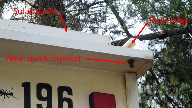

We catch water from the roof via a QC hose fitting that connects directly to the tank filler via gravity. A few hours of drizzle can harvest a large volume of good water. All our water is chlorinated and filtered anyhow, so we have no contamination concerns.

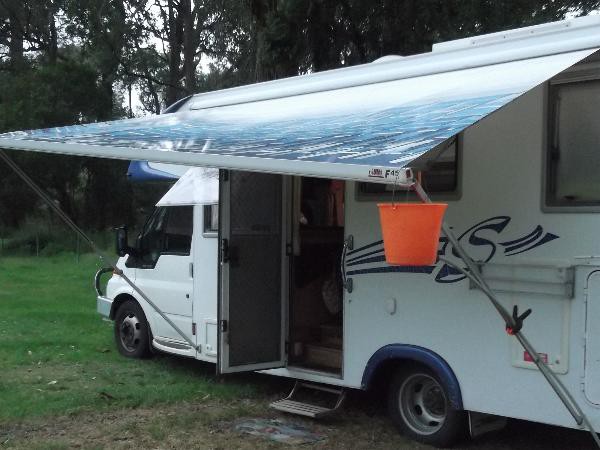

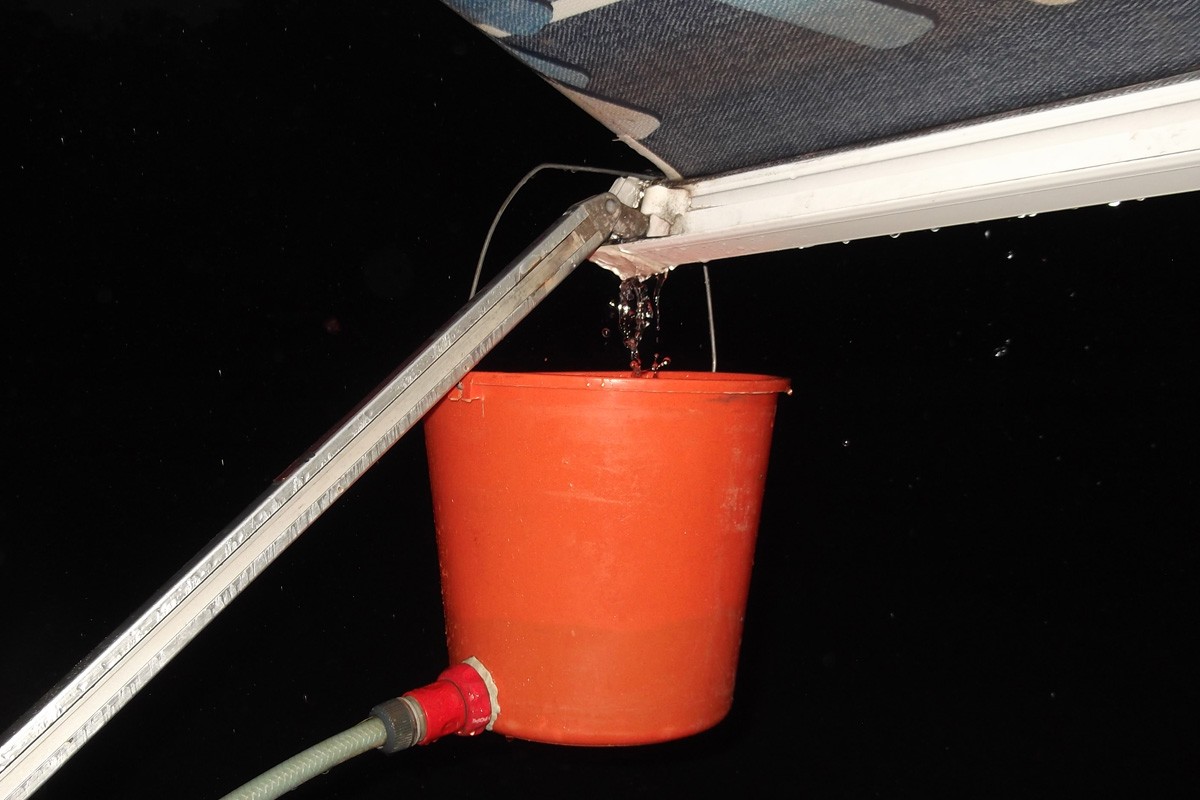

We do our [occasional] water collections from the awning as well. Here's some pix
The system works quite well, esp once the water starts running. Also because of the slope of the bucket, dust & debris is held in the base of the bucket while the water drifts off thru the hose
A great idea Phil, I shall steal it :)
In design, simple is always good. I'll raise the bucket outlet about 50mm above yours to give a little more of a reservoir for dust collection.

Ozzie_Traveller said
07:37 PM Jun 13, 2018
Mike Harding wrote:A great idea Phil, I shall steal it :)
Thank you for that.
G'day mate
No need to do that - I just swivel the bucket handle a smigen sideways to raise the outlet and leave the debris to run down into the lower corner. You will notice in image-1 the clamp I have for the hose onto the awning support - by pushing this clamp up towards the bucket that also tips the bucket sideways a bit as well
Phil

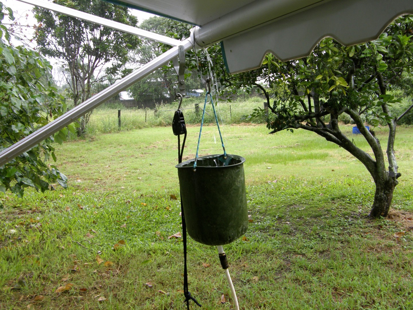

Gooday, Here is what I have done with great success-: Canvas shower bucket,, screw off the rose, fit a brass fitting that will take a snap on hose connecter, attach hose to this outlet and other end to water filler inlet, ( in our case this is located on the rear Bumper Bar of the Caravan, should also work if you have filler points along the side as long as the collecting vessel outlet is higher than the water tank filler point.
Make sure you drop the awning at one end so the water mostly runs to there. Have filed our tanks in a short time during a good downpour.
