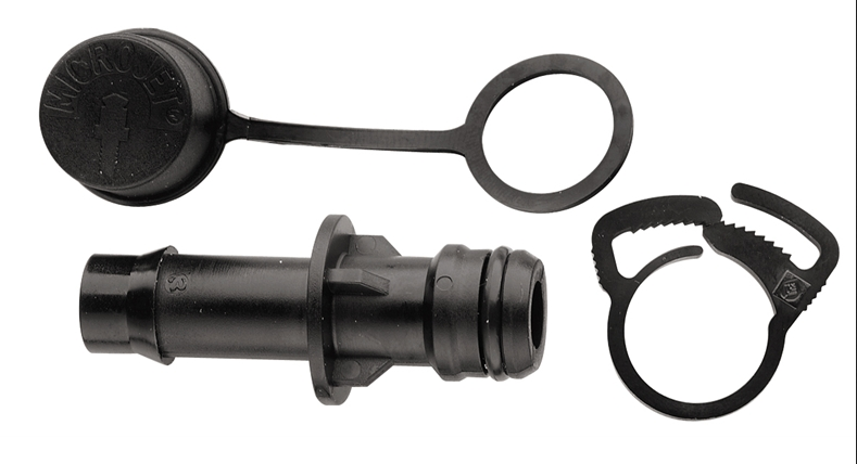

Neil, I have found that I get better filling if I use a hose without a fitting on the end. I poke the hose down the filler pipe/hose around 200 - 300 mm. This provides just enough pressure to blow out any water that collects in the breather tubes that cause an air lock. It also provides enough pressure to force the supply water through any airlocks in the filler hoses.
Have you tried that? I use the pictured fitting to join a short length of hose onto the water supply hose and poke that down into the filler.

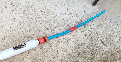

Here is what I made up, hose down the filler with some taped around for sealing. When the water starts flowing out the breather it is full. Have to be careful breather is not BLOCKED as could rupture tank. Common sense needs to prevail.

Hi Neal, most problems with water filling are due to the return air line having some water in it and stopping the new supply entering the tank. particularly if filling out of jerry cans as this is a low pressure supply.
Aussie Pauls excellent pic shows some tape around the hose. This is the best trick yet, as it prevent the water coming back at the filler upper, you.
It makes the tank slightly pressurized and clears any ting out of the air line.
