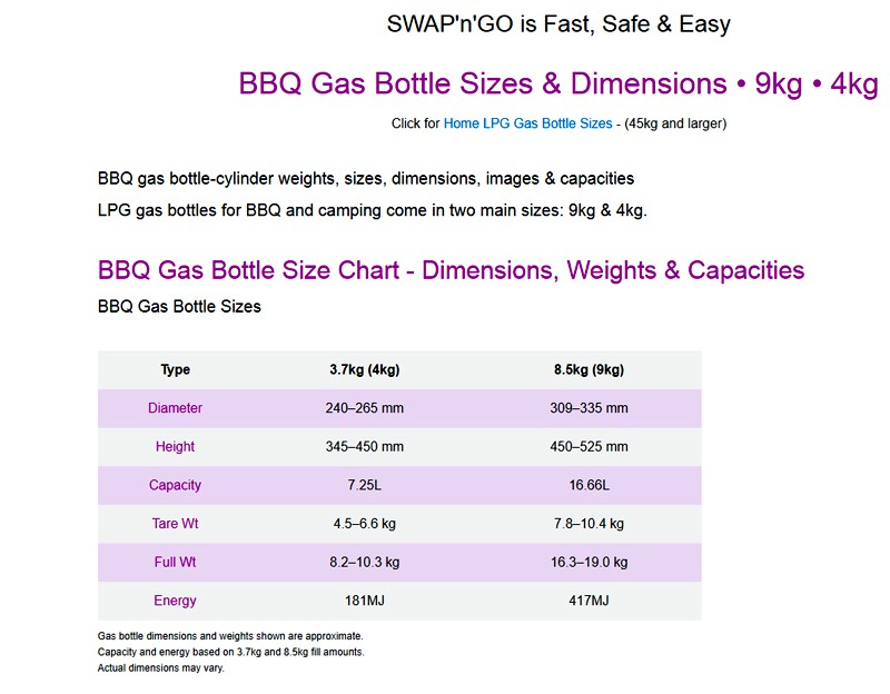

We were advised 6 years ago when we bought our new caravan not to swap them & keep refilling them as gas bottle shapes vary a fair bit in height & diameter.

The Gas bottles do vary a lot in size
