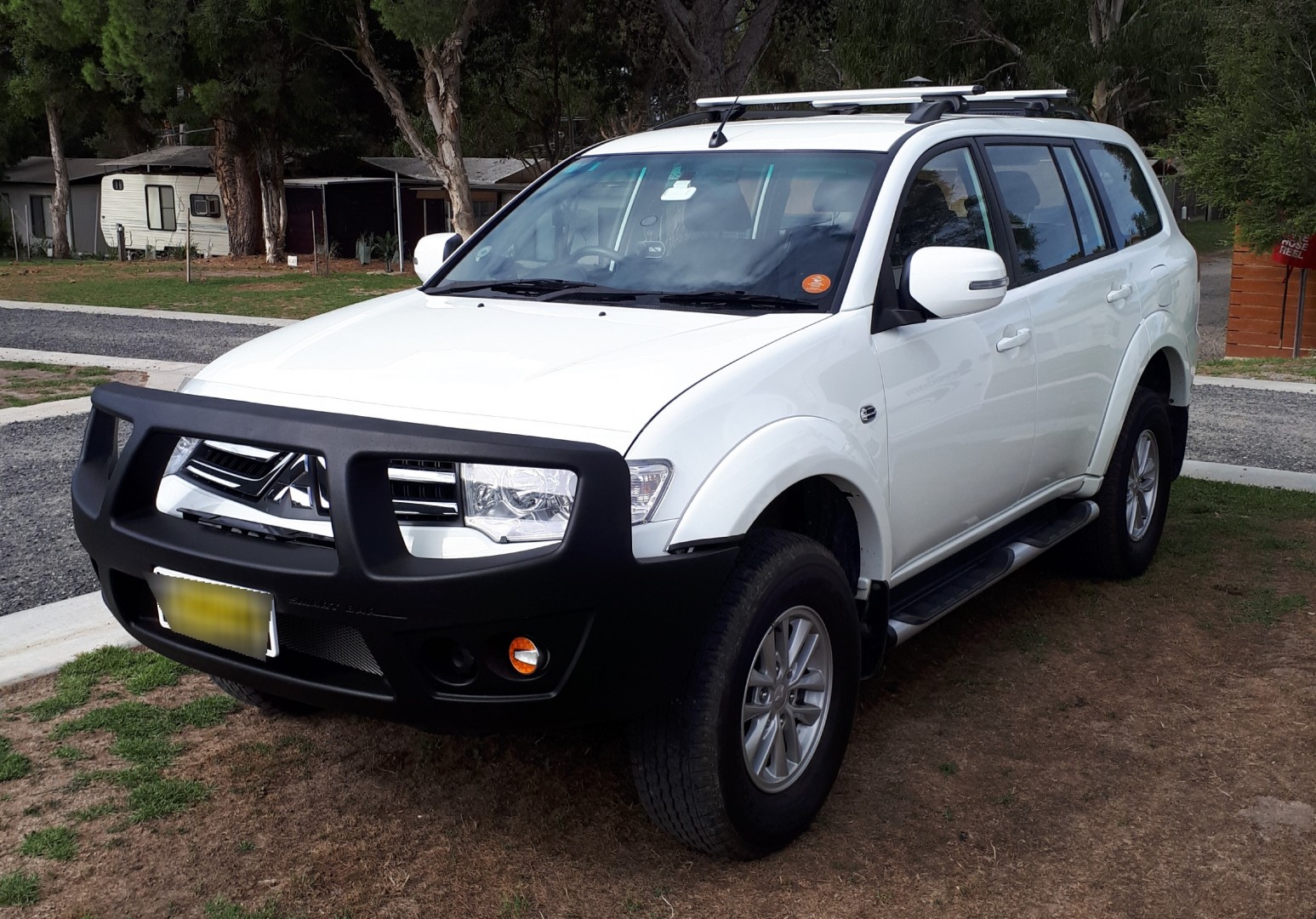

I fitted a Smart Bar to my Mitsubichi Challenger 3 months ago and am very happy with it. 34 kgs fitted. A steel bracket is bolted to the chassis and the bar is bolted to the bracket and it comes with provision for driving lights and UHF arial, mine is not winch compatible, didn't need one. The bar's appearance is not for everyone but they are light and practical. They are also pedestrian compatable, whatever that means. The front bumperbar will have to be substansially cut to fit the bar but no suspension upgrade is required. I found the cost of the bar was considerably cheaper than other bars (steel and aluminium), not including a suspension upgrade which is required for steel bars and some aluminium bars. All the best in your choice.
