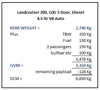

With a TARE of 2,750Kg, add 250Kg TBW, 140Kg fuel, 150Kg (2 passengers), bullbar and other accessories ~100Kg, takes GVM to ~3,390Kg or 110Kg payload left.
As can be seen, despite how the "marketing" numbers are pushed, it is very difficult to tow anything more than a 2,500Kg van - and even then only with carefully chosen payload.
It is ludicrous to suggest, despite their advertising and printing of brochures, one is able to legally attain the GCM of 7,000Kg stated by Nissan - more likely only 6,000Kg.
One could be totally unkind and suggest the Patrol is 'not fit for (advertised) purpose".
And even the much praised LC 200 fares not much better. Indeed, there are very few vehicles available that can genuinely tow anywhere near their "advertised" maximum capabilities.
When ... not if ... the authorities begin to check the compliance of rigs on the road, there are going to be many owners who are going to be furious - and out of pocket.

So that would make the figures look like this -
OH .... and of course, if the Patrol is AT GVM ... then the maximum mandated tow ball weight must not exceed 250Kg.
Feel like it is a merry-go-round?
As I said, the ACTUAL figures that Nissan should be promoting is that the maximum towing capacity is 2,500Kg and a TBW of 250Kg because if the GVM is reached (and it seems damned near impossible not to) then it is not allowed, ipso facto, to have more than 250Kg on the ball.
-- Edited by rockylizard on Sunday 20th of May 2018 01:53:20 PM

Yep HandyWaltear - there seems to be no rhyme nor reason to the numbers that they all come up with.
These are the numbers for the Discovery 4 (assuming the same usage as the Patrol) -

Discovery 4 numbers -
09:40 AM May 21, 2018
Yeah ... I know I know ... only a fool would put this up.
Feel free to shoot the messenger - I can take it
I guess it is almost impossible to get a legal tow vehicle to tow a caravan.

09:51 AM May 21, 2018
Ya probably rite Bill ... so ya got an extra 10>12 Kg back for payload ... making only about 110Kg over GVM

Yep ... gotchya Bill ... check this link - I have updated the figures.
Am I glad I have MR licence and motorhome !! Looking at the numbers & weights . I think back when I towed a 3 horse float all over the country . In 1400 kg vehicles! Floats Unbracked . Wander us old codgers are STILL alive !!
A D4 does not have a GVM of 3500kg, so to tow a 3500kg van it would be heavier than the D4, which most people think is unacceptable, even though LT specs say it can legally tow such a weight! That is why my payload is only 682kg.
OOPS .... my bad
I will plead that all these confusing numbers for vehicles/vans addled my poor liddle brain.
