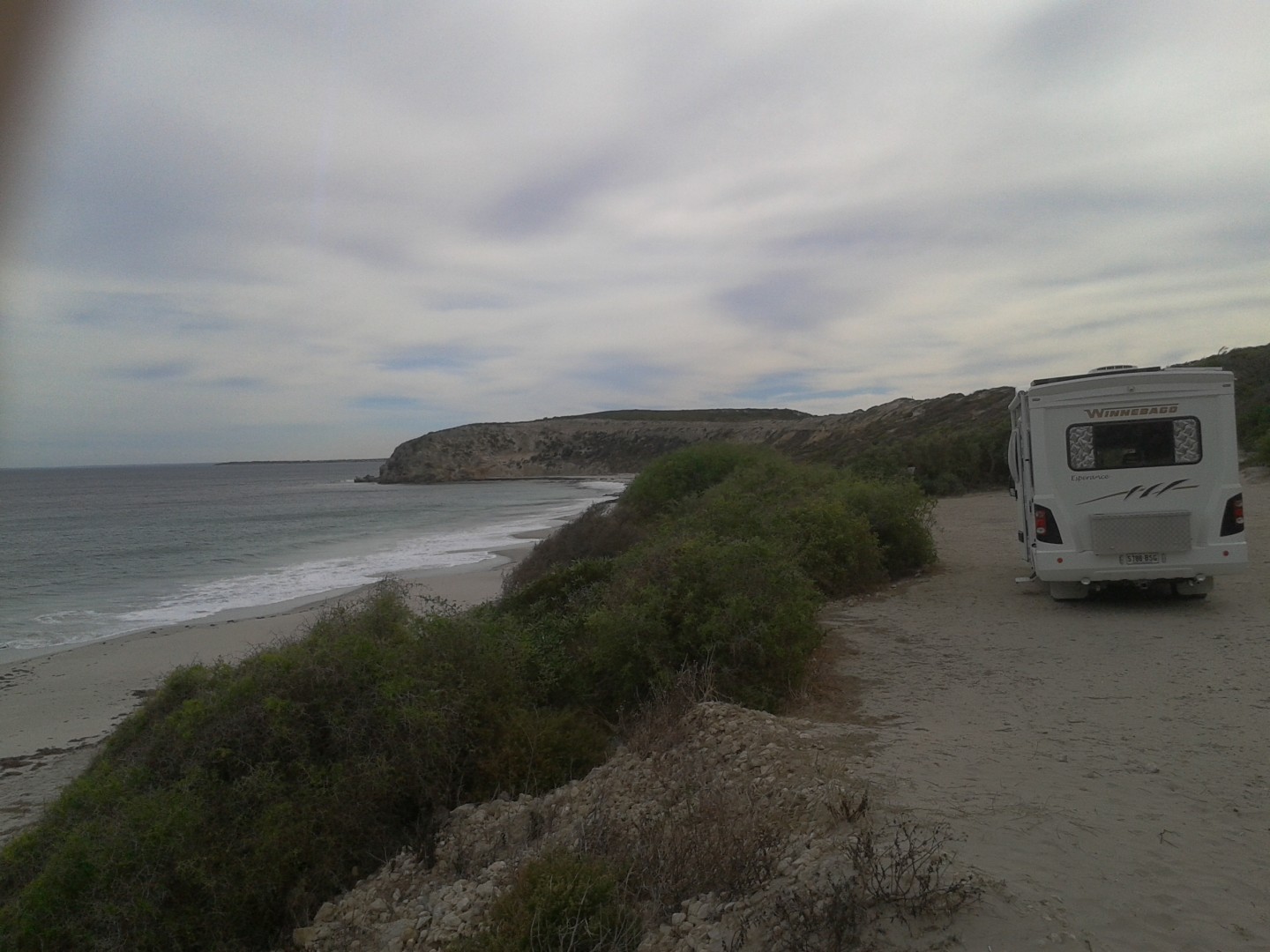

pic is an isolated spot on the YP SA... very rough road.. took 1 hour to do 27ks....
