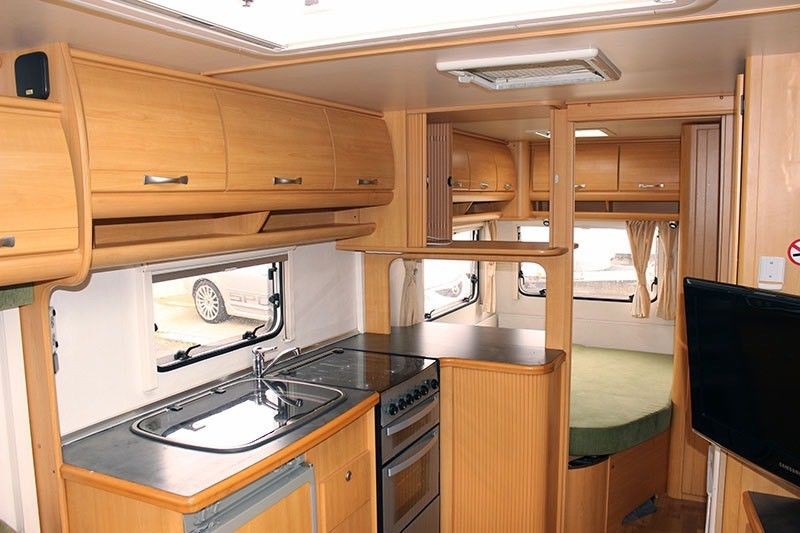

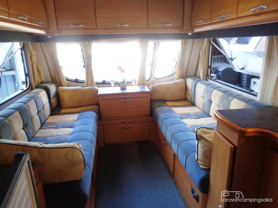

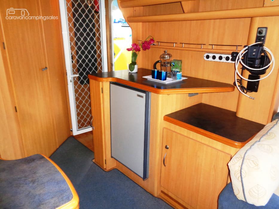

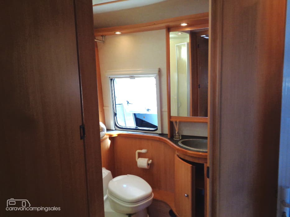

Van A: Tare 1200, GVM 1350, ATM 1400, 16 ft (interior length), 75kg ball weight. see pics VanA
Forward twin (or double) bed/couch's, centre small kitchen, rear toilet & shower (seperate). Fold out awning.
Pro's - 1. Smaller size = easier tow (under 85% car weight), less fuel. 2. Cheaper on Tassie ferry by $100 each way. 3. Dry toilet area. 4. Listed at $4k less. 5. It's in Vic (saves a fare on the ferry).
Con's - 1. Have to make up bed each night, uneven mattress (couch cushions). 2. Smaller interior (claustrophobic?). 3. Tighter kitchen, stove against side wall.

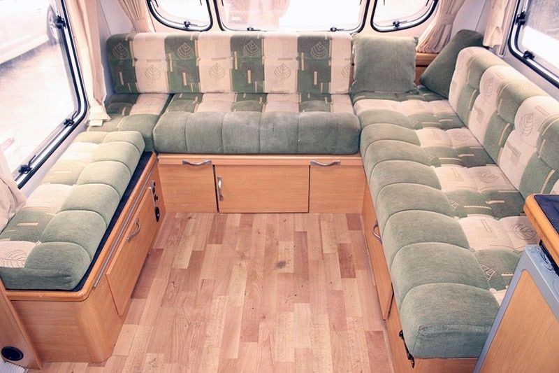

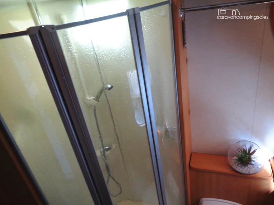

Van B: Tare 1340, GVM ?, ATM 1500, 17.6 or 21 ft (not sure). 85kg ball weight. see pics VanB
Forward twin bed/couch's, centre medium kitchen, rear fixed double bed, toilet in shower. No awning.
Pro's - 1. Permanent flat bed. 2. More spacious, big windows both ends - good light. 3. Nice bench area for kitchen. 4. Possible good couch, big TV arrangement.
Con's - 1. Wet toilet (from shower). 2. Heavier = more fuel, borderline towable weight for car (91% car weight). 3. Bed more difficult to get out of. 4. Ball weight 10kg over. 5. It's in Perth!

Van A seems the best to my little male mind for a single traveler for the reasons you list , but being one who likes a comfortable bed my surgestion would be that a single person will not need two couches not even sure that two people would so why not alter one of those couches to a permanent bed with a proper mattress , would this then make your choice much simpler as the other creature comforts seem a better fit to me than van B especially the dry toilet

I agree with Woody that making a permanent bed up on one of the couches in the smaller van would seem to be a good idea. You could look at changing over the cushion on it for a proper mattress.
