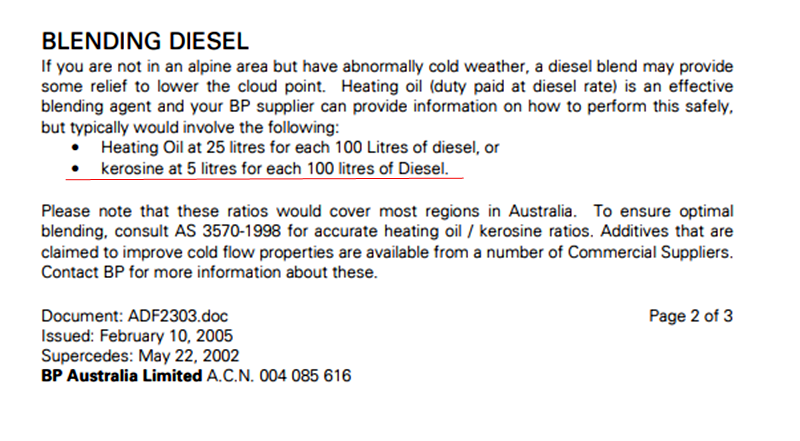

That was interesting thanks. I googled a bit on that info and here is a reference to the complete BP statement for those more interested in the subject !
The Australian standard has Australia divided into 6 zones for the supply of suitable blended diesel for the temperature expected there at various times of the year. So there is more than just "winter fuel"

BP recommends this
Hi Plain Truth
https://www.bp.com/content/dam/bp-country/en_au/media/fuel-news/winter-diesel-problems.pdf
