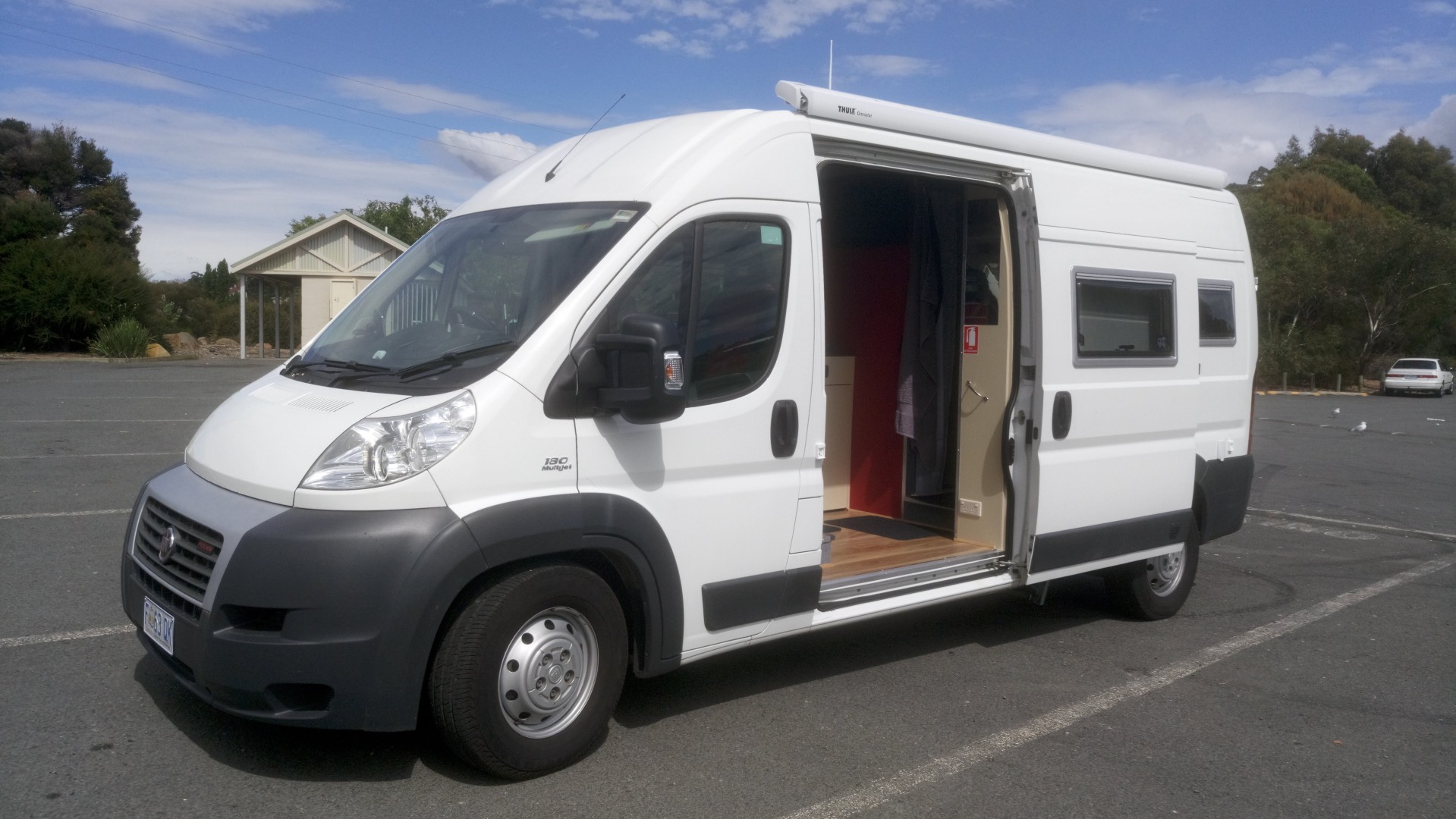

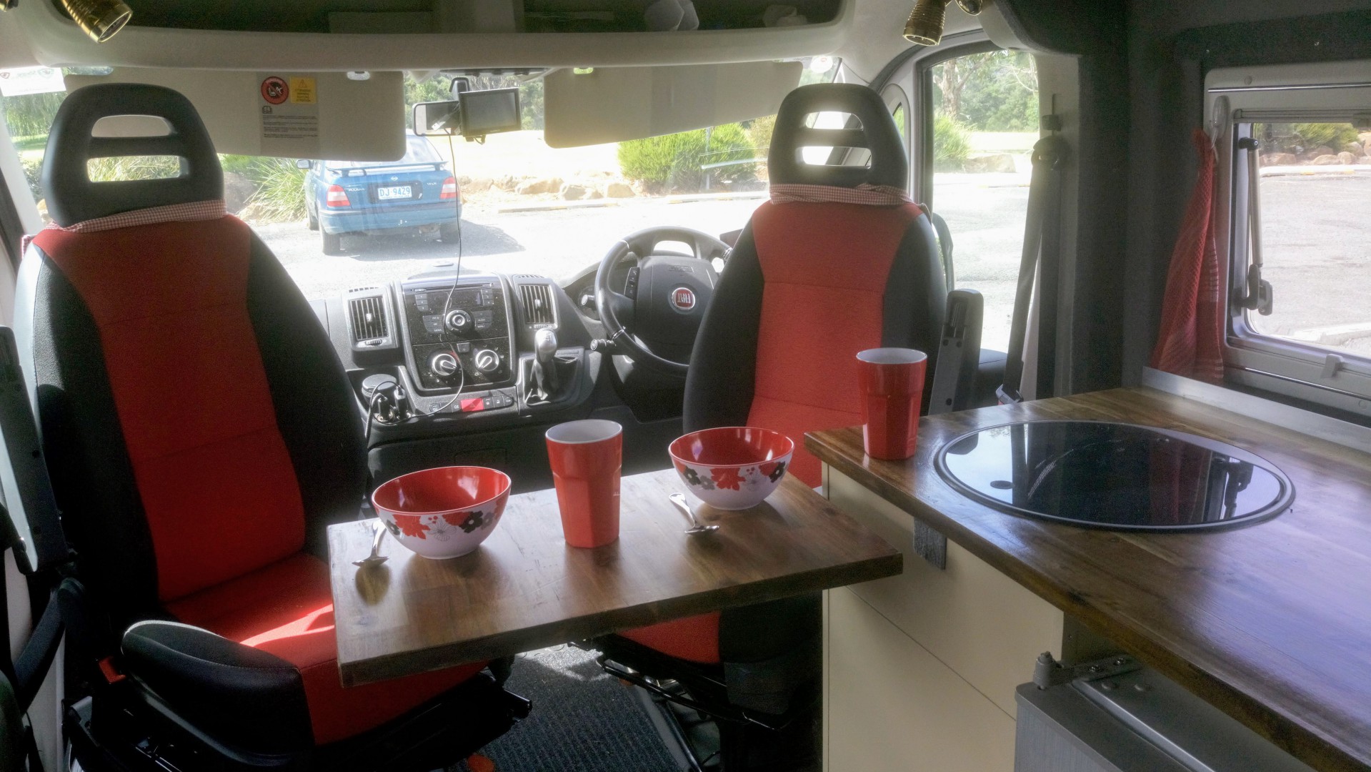

Our latest Motorhome is a 2014 LWB Ducato, just converted to a Motorhome in Feb 2018. 3 litre engine with auto transmission. Lucky to find a base vehicle that has now done only 29,000 kms

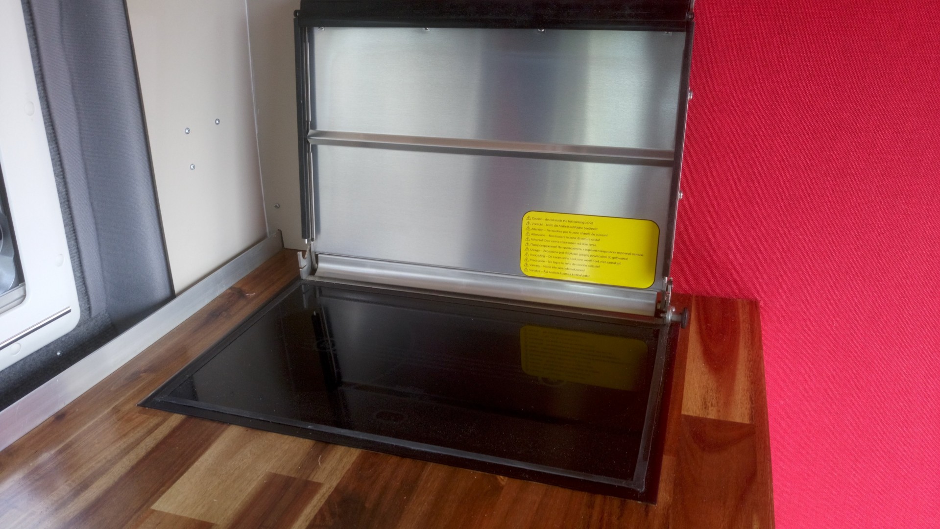

No, we never do anything the same, and this time we have included a Wallas diesel stove, with an in-built heater - something new and I had bever seen such a setup before. The stove looks like those in the Trakka motorhomes.
The heater uses the stove top and fresh air is blown over it beneath a heat resistant cover - produces a lot of heat.

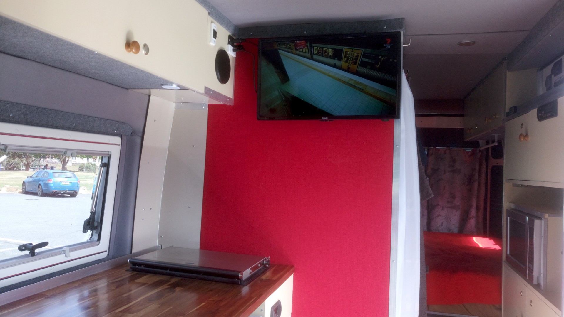

This time we have a separate bedroom with the shower/toilet coming out from the driver's side forming the wall.

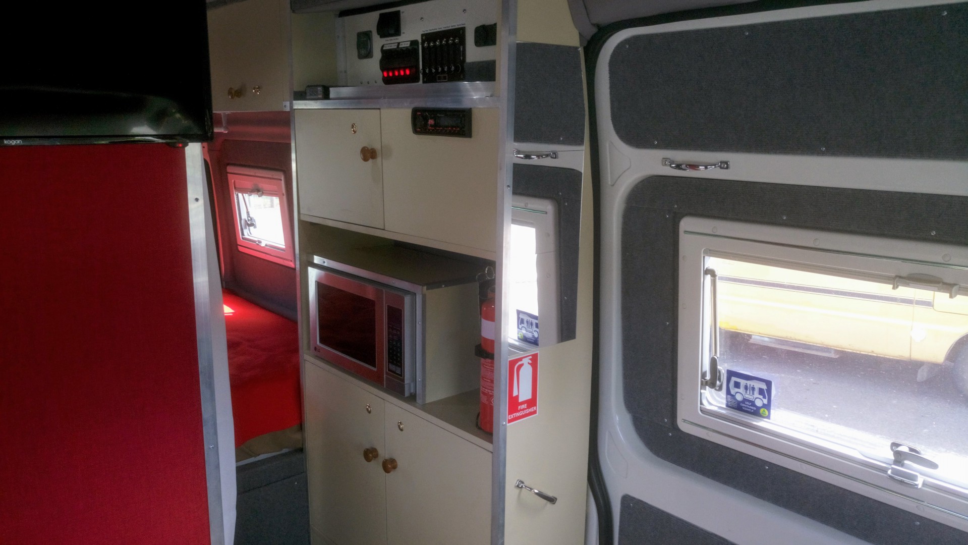

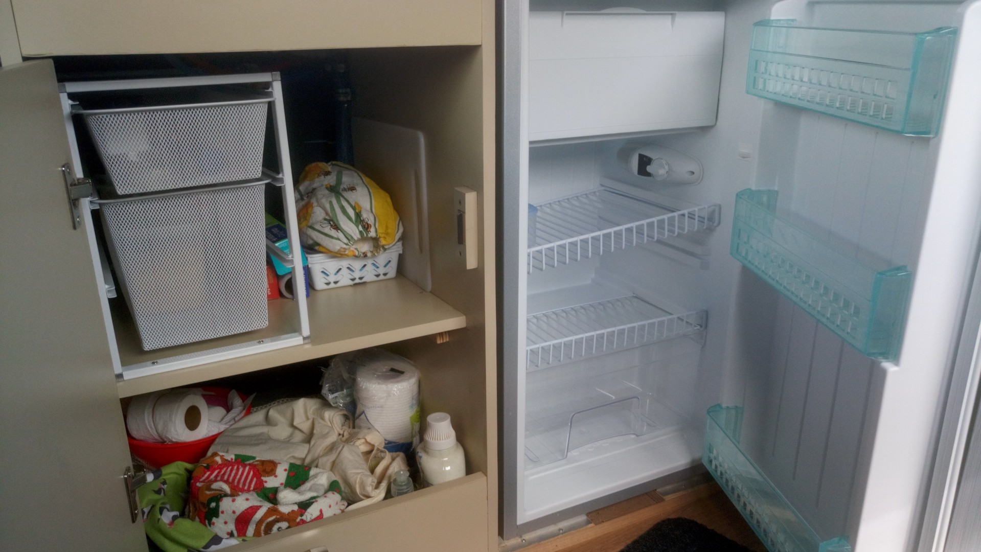

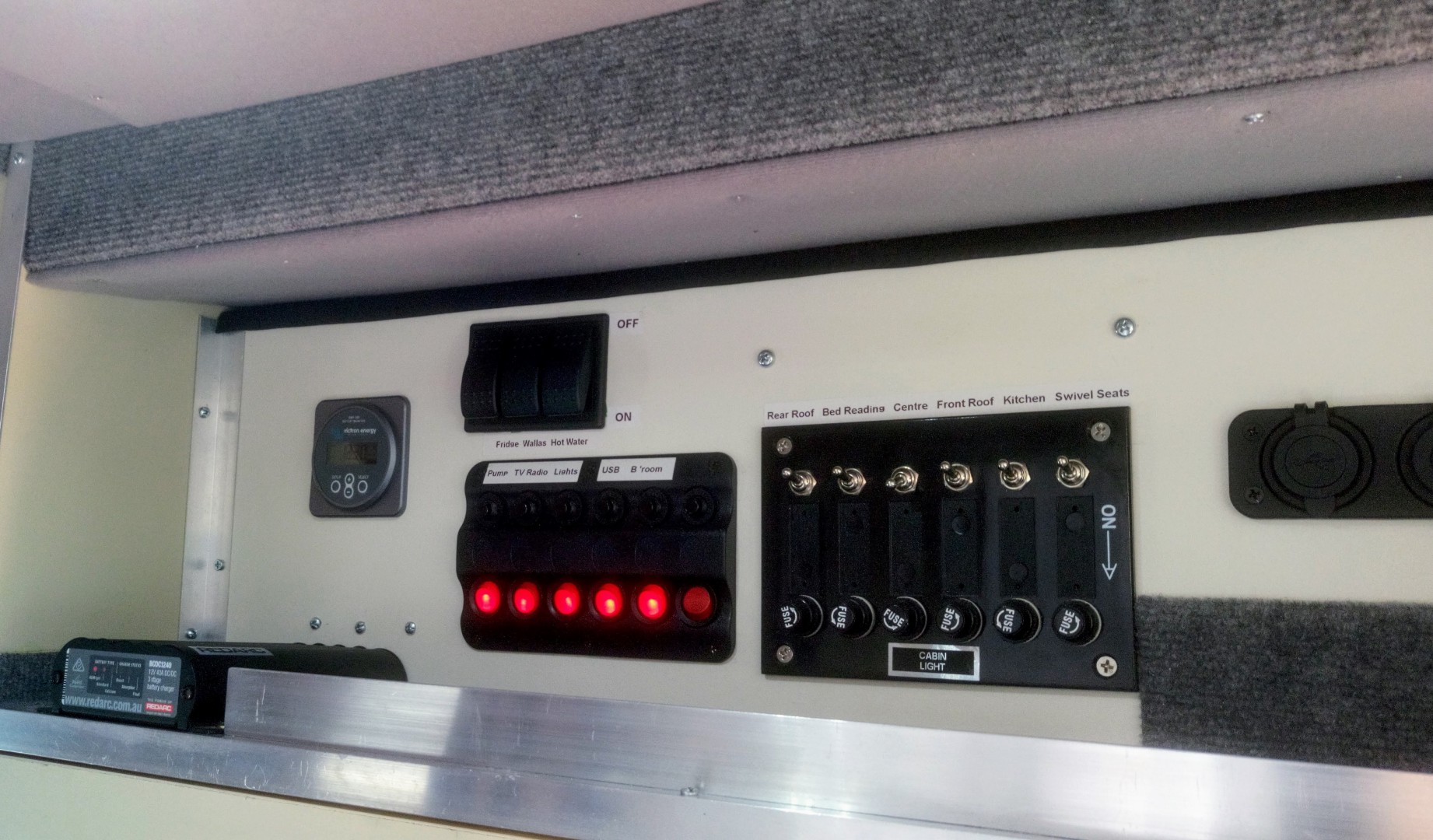

We also used a Saturn amplified TV aerial, 24 inch TV, a 3.5 metre.Thule Awning. 170 litres fresh water and 80 litre of grey. 110 litre compressor fridge/freezer, 320 watts of solar, 224 ah AGM house batteries. diesel hot water system.

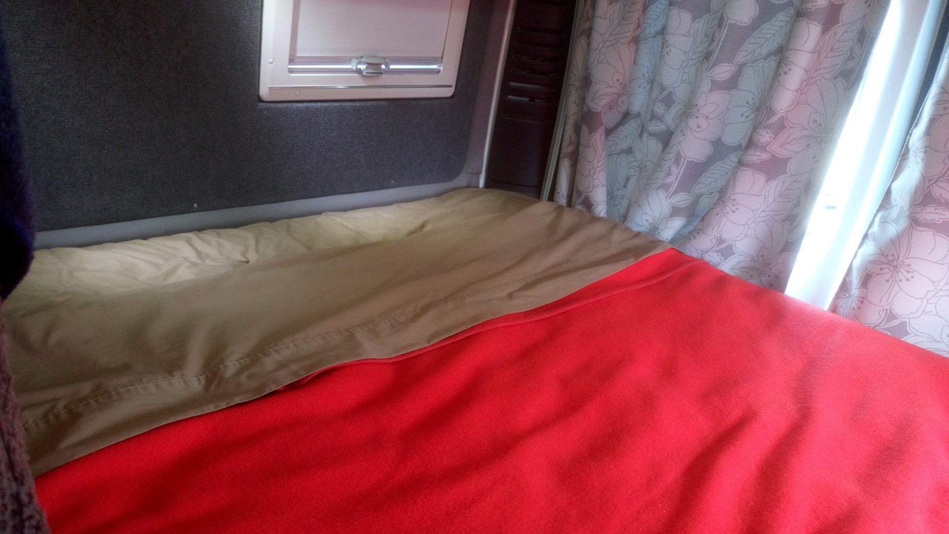

Two electric bikes fold and fit under the bed
No - none of the big manufacturers make anything like it.
