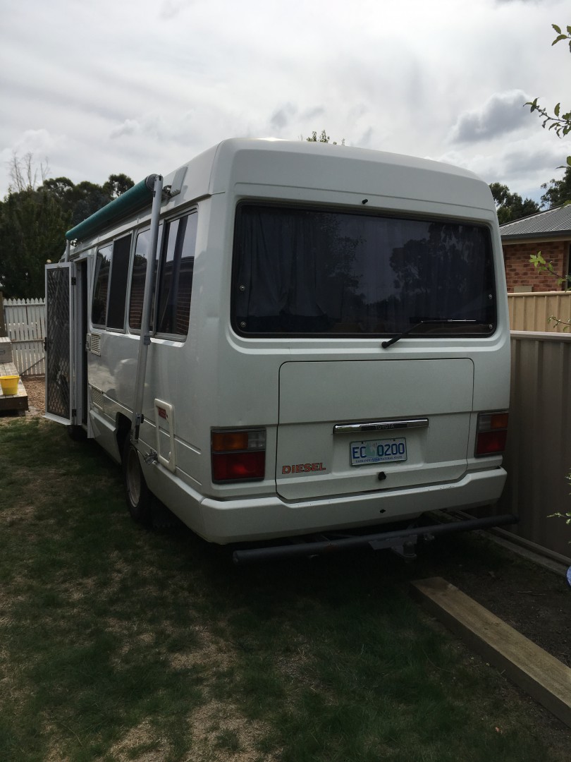

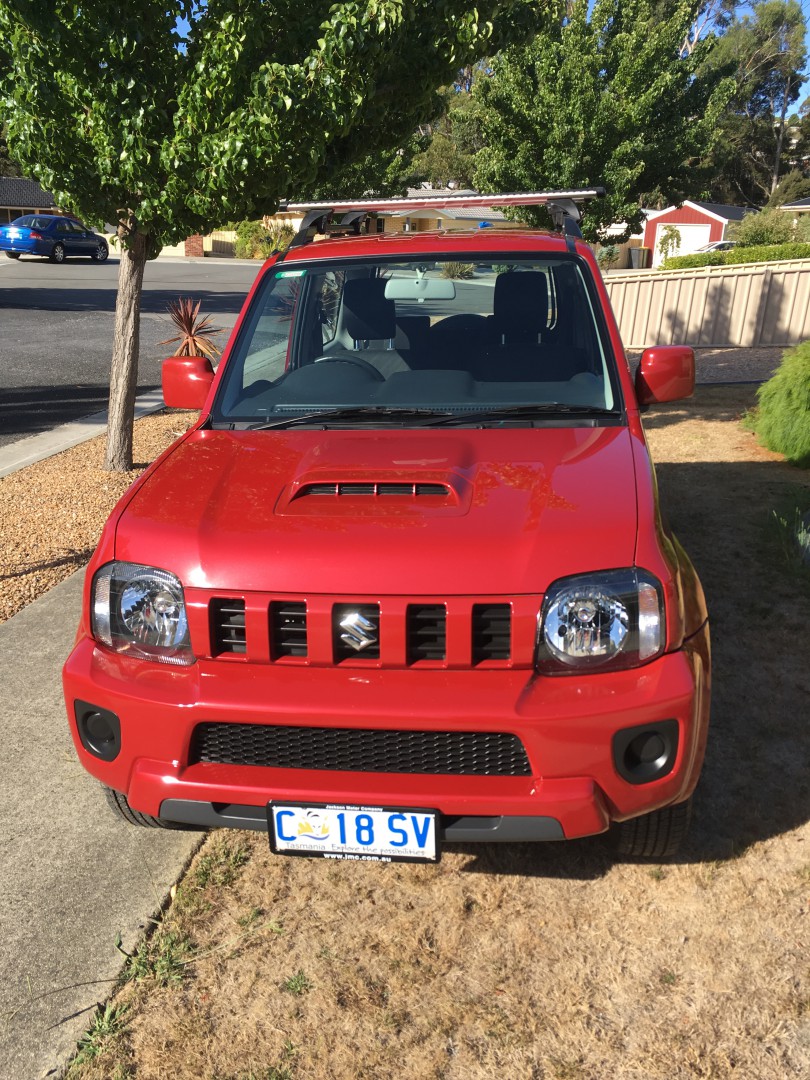

I have a question on Towing for our Coaster. We have an '89 Coaster converted to Motorhome, it has a 3.4 litre diesel engine coupled to a 5 speed gear box. We also have a Suzuki Jimny 2013 model, 5 speed manual. How well will the Coaster pull the Jimny?? We will add modifications to the Coaster towing area because whats there now is pretty frail and Jimny as well needs modifications to bumper area for this to happen. I saw a motorhome today towing a Jimny up a fairly decent hill on the Bass Highway near Deloraine and it iooked to be going very well but it was a fairly new looking Motorhome.
