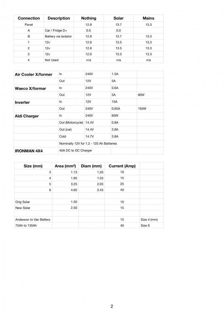

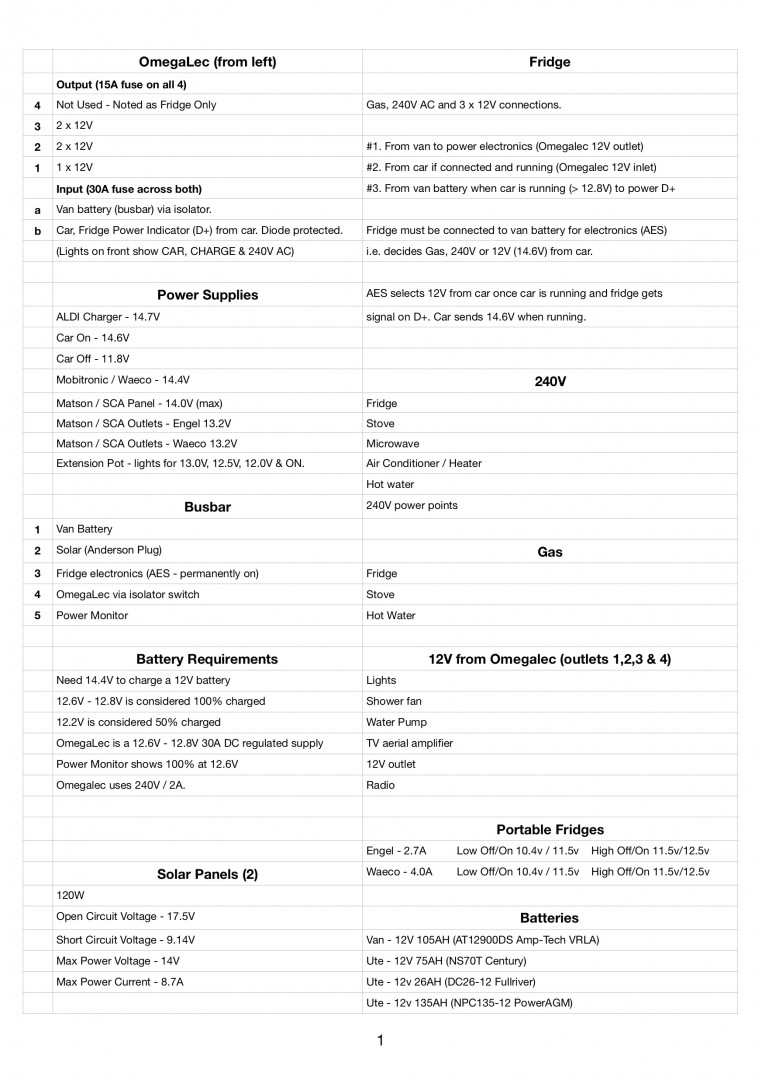

My Omegalec manual, a page I found on the internet and what I have electrical-wise in my van & ute (Jurgens Sungazer & 2015 Ranger XLT 4dr).
