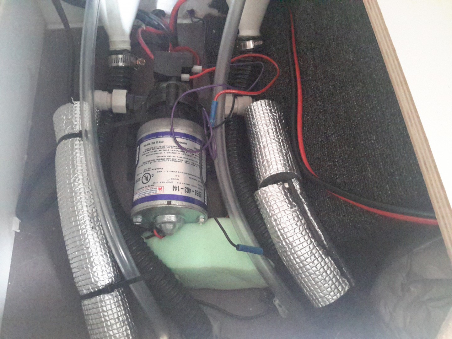

Our water pump was seriously noisy, followed the forum pages looking for answers, extra rubber under the pump, soft hoses. No real luck.
Had a small block of good quality sponge rubber in my hand when Cheese and Kisses was using the pump, guess what. The pump noise was some what quieter after placing the sponge under the pump, into the garage found some water pipe rubber insulation and placed that over the water pipes. The rubber hose and sponge block has taken out the druming of the pump.
We now have a seriously no noise water pump, it is so good.
