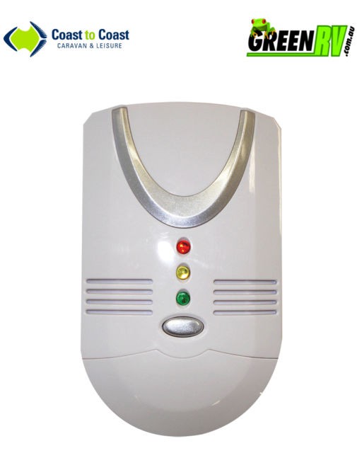

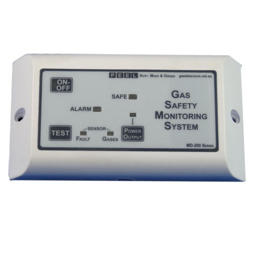

Yuglamron said
08:00 PM Apr 3, 2018
Both of these were found on E Bay the first one the Peel version is top of the range at $389 and the other is one available through Green RV at around $68. The Peel company have their own Australian website
Just a piece for information.

could you give us a few pointers towards them Yuglamron?
and there are a few models.
https://www.mtiindustries.com/products.asp?cf=1&ti=0&ci=1&si=1&pi=50
https://www.rvpartsexpress.com.au/gas-equipment/gas-detectors/12v-gas-detector-gk-601.html
