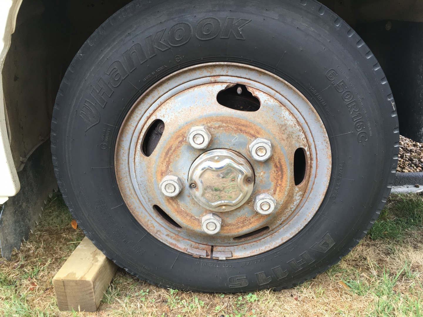

Our Coaster has six of these on it. I haven't checked the spare for brand but can see it has a full tread unused. Tyre has 73psi near the rim.
We need the full information from the tyres. Check each and every one. It will say max load single 1000kg at ....???... psi Max load dual ..... at .... psi. Then we need the actual load on the front axle and the actual load on the rear axle measured on a weigh bridge.
I would also advise that you check the age of the tyres - every single one.... You will find a 4 digit number on each - something like 2806, which would mean the tyre was manufactured in the 28th week of 2006.
Cheers, Peter

Proportion the maximum pressure as a % of the actual weight compared with the maximum weight marked on the tyre. plus about 5psi for single wheels.
For the dual wheels, the load ratings are lower, but still shown on the tyre.
The 6.50R16c tyres on the OPs Canter are a smaller section and lower load rating than most I have seen on Canters which are typically 7.00R16 or 7.50R16, so I suggest he also needs to check that the correct size is fitted too. The vehicle will have a tyre placard.
But I agree that if they are 15 years old (or more, they could easily have been several years old when fitted), they should be replaced immediately. Check the manufacturing dates on the tyres to confirm that.
And PLEASE get it weighed first, one axle at a time while fully loaded.
