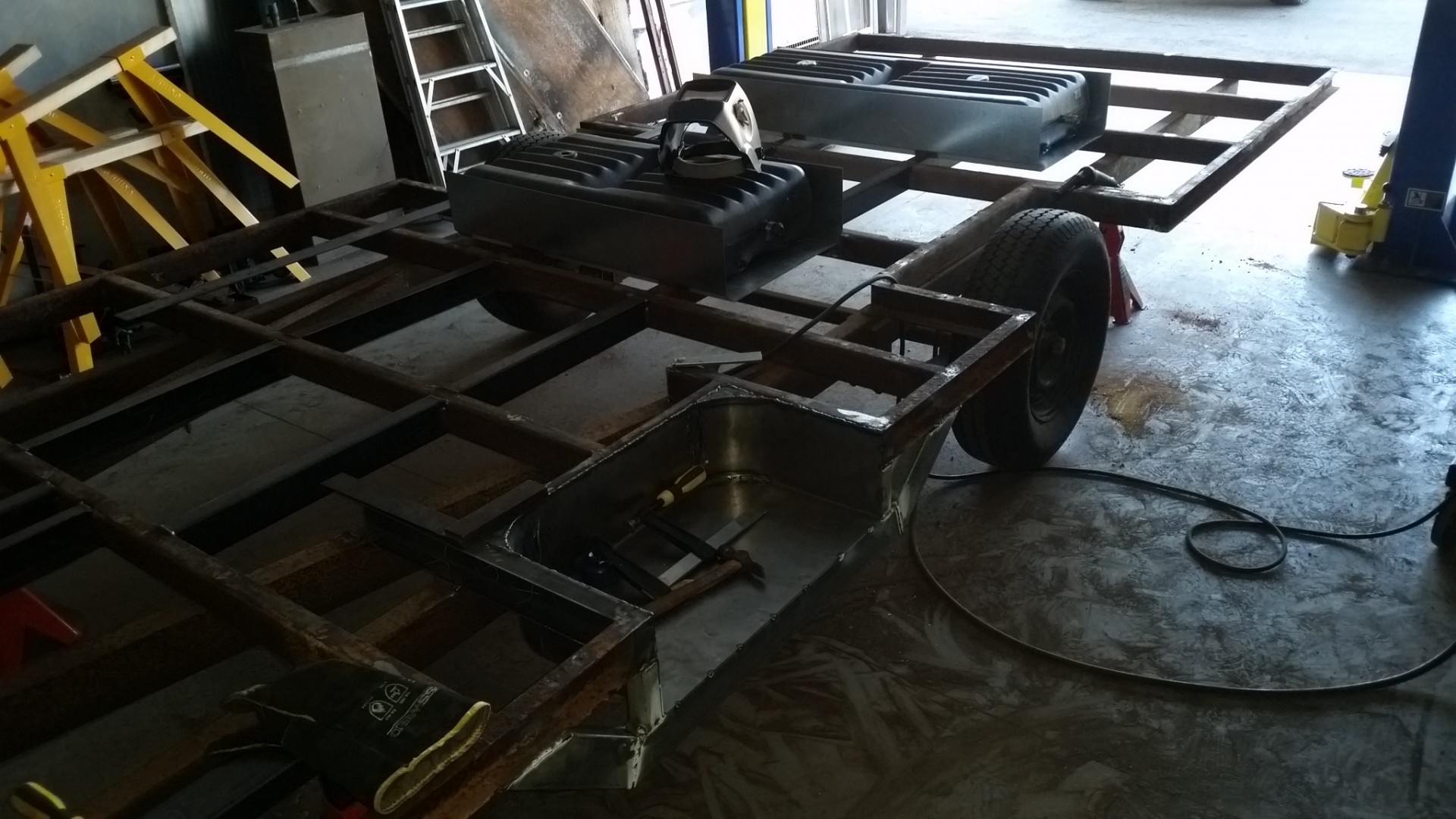

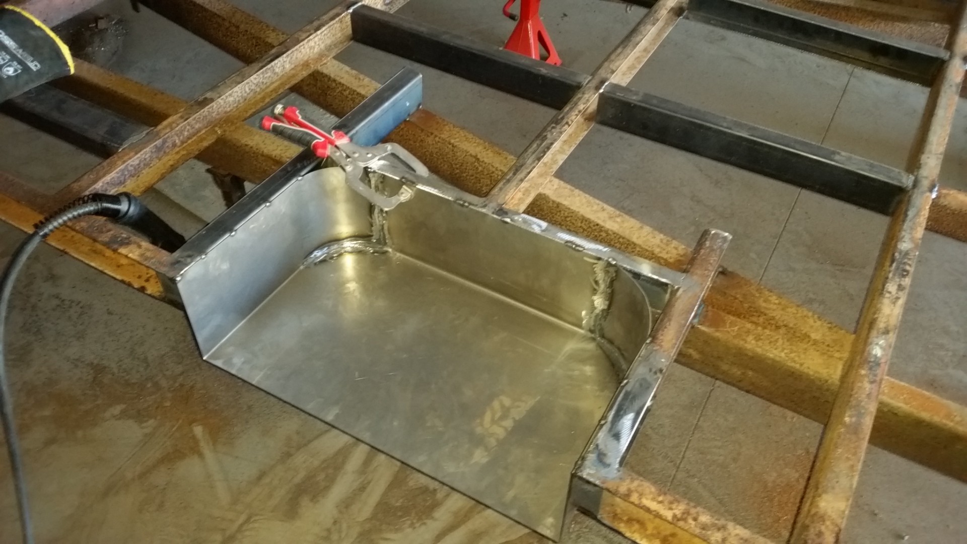

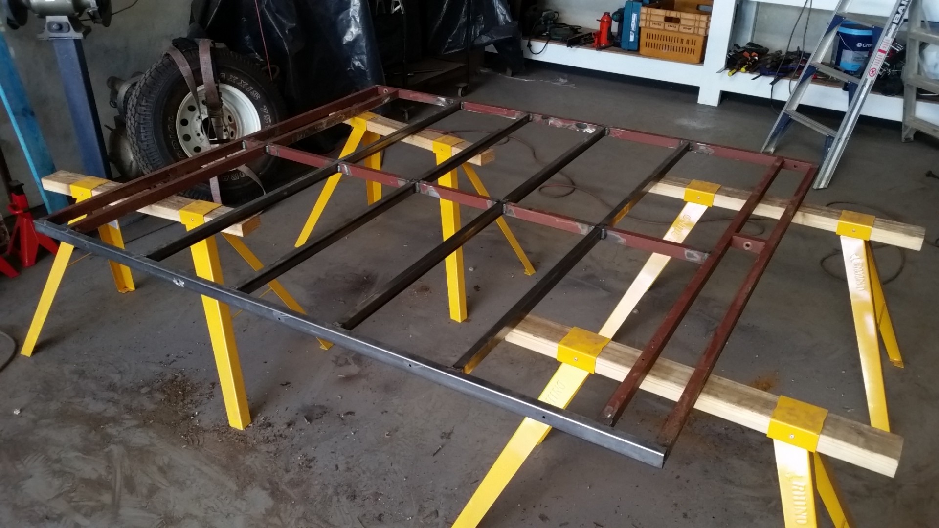

Thought i would give you another update on the old lunch box, i am now starting to do the rebuild. i have just about completed the chassis i am waiting on the new suspension to turn up so that i can run the same tires and rims as my tow vehicle, i decided to go with a 50 mm solid axle with leaf springs and 12" electric brakes. it was a hard decision as i was going to go with independent coil suspension but i had a nagging worry about getting parts to the outback quickly if i damaged anything when looking for new ground.
Once i have fitted the new suspension to the chassis i will remove it again so the chassis can be sandblasted and coated. i am currently working on the wall frames, cutting out the serious rust and replacing that with new tube, the not so serious rust i will treat then paint the frames with red oxide paint. There are a few pictures to look at if you like.
