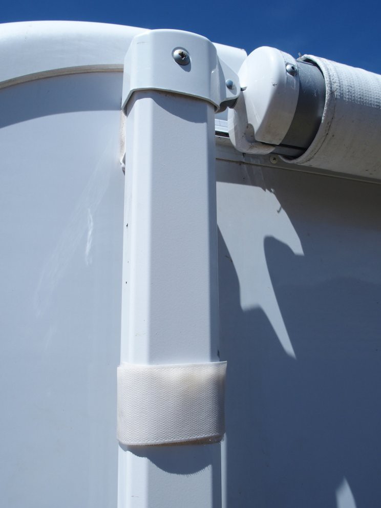

The other week we went on a trip, and I wasn't all that happy with the rear post of our awning security wise, so I just wrapped a bungee coed around it as extra. When we got to our spot, our friends rolled in, and looking at his awning, I saw he had extra Velcro straps on both posts.
I am wondering if anyone else is doing this, or are the existing plastic clips a satisfactory means of keeping the awning in place.

I would think that if your locking parts are plastic a set of Velcro straps would be a good idea. We all know how badly the sun damages plastics here in Australia. It will damage the Velcro but every time you use them you will see if they need replacing.
Peace of mind is better than worry!

G'day. Always velcro ours and also use velcro on the screw pins on the arms. Have not lost one of them since.

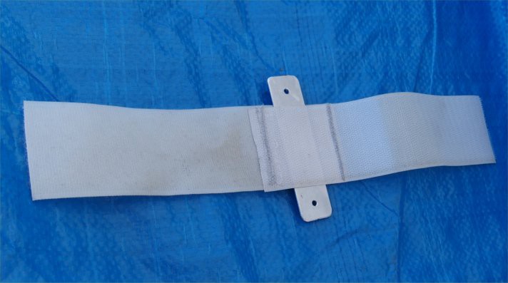

I have a Carefree awning and the rear plastic clip which holds the awning in place whilst travelling actually broke on a VERY windy day. I botched a repair which to this day still works quite well, but I also bought two velcro straps. These straps seem to be fitted to later model caravans (not mine for sure). I have lost/misplaced a few of the straps, so I have now tied them onto the bracket so they don't get lost.

Thank you for the info, out comes the sewing machine and pop rivet gun.

He showed me his velcro straps and so when I got home I made up a couple that I still use to this day. Just double sided velcro hand sewn to a stainless steel ring. I think that I left a bit extend past the ring so that it doesn't rub on the paint of the awning arm.

Always Velcro mine.

Even though Jayco said I dont need to velcro my awning, I still do when travelling.
I use the short velcro straps that came with the awning deflappers ( mine came with two straps each clamp) and if I need them for the deflappers it is only when the awning is out so the straps are 'dual purpose'

I am paranoid about the awning when driving, so we have Velcro and also a small dog collar around the awning arms. Overkill, but at least I feel more relaxed.

All done, easy peassy. Two struts done of course.
