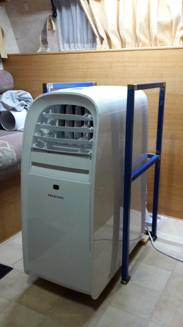

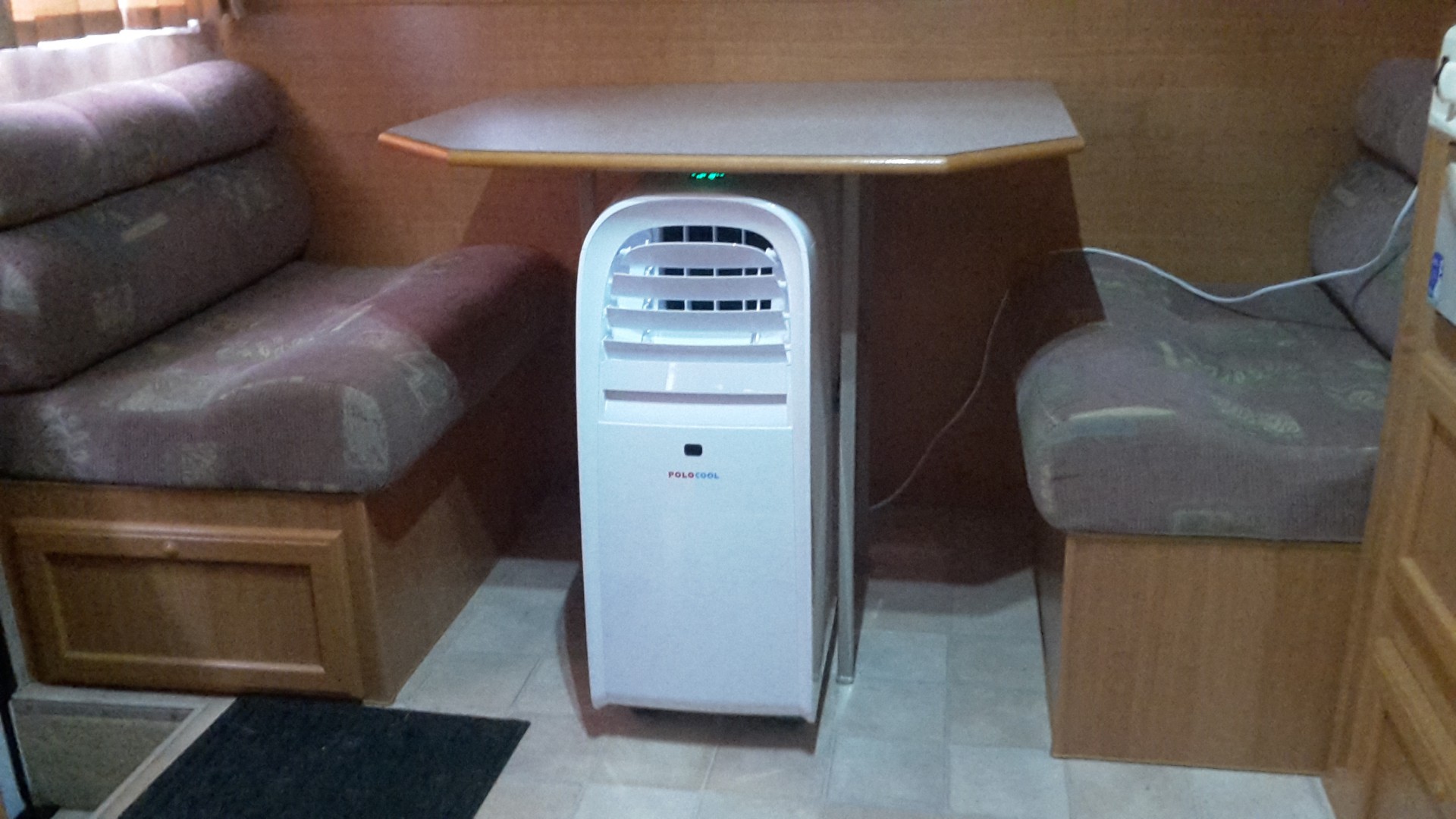

I didn't want to pay a fortune to air condition my van as I do little summer camping.
I thought about a portable unit, but they were all odd sizes. I was in Joyce Mayne a couple of weeks ago & they had an air conditioner sale. There was the perfect sized unit to go under the table. $649 down to $379.

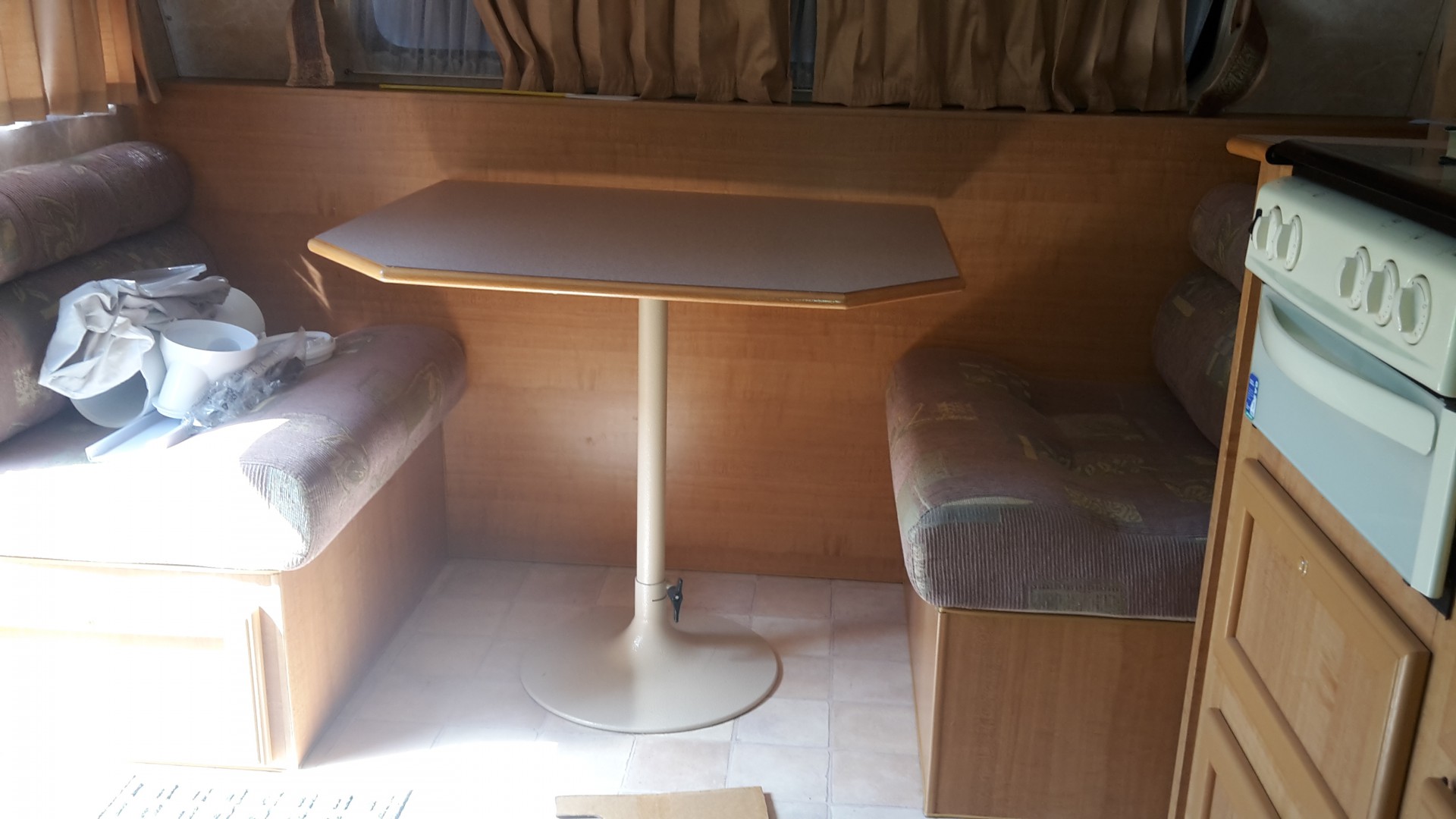

I made up a new mount for the table so the unit could go under. It's a 2.9 kw unit. It brings the temp down to 23 degrees, on a humid 35 degree day, in around 30 minutes. 15 ft van.
i can remove it in winter & replace it with a small oil heater I've got, (no noise)
Only drama will be if it fails, I'd have to find a unit the same size.
