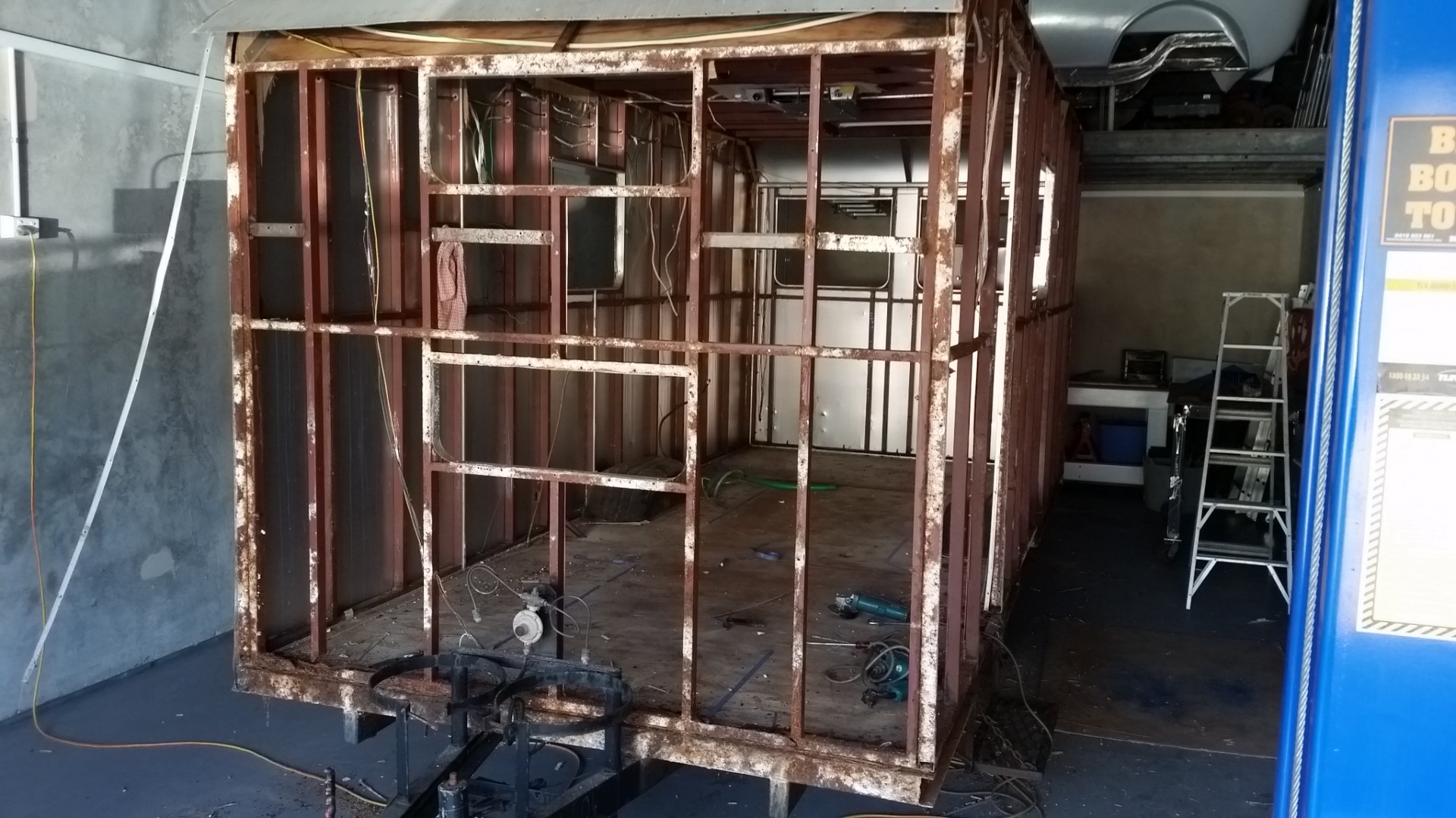

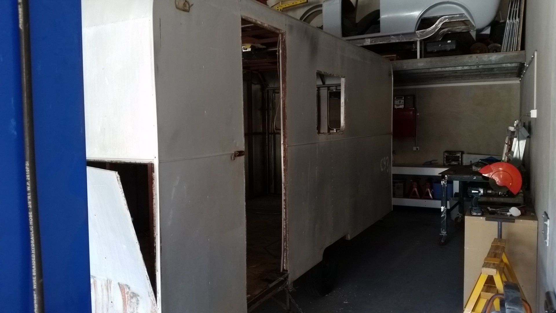

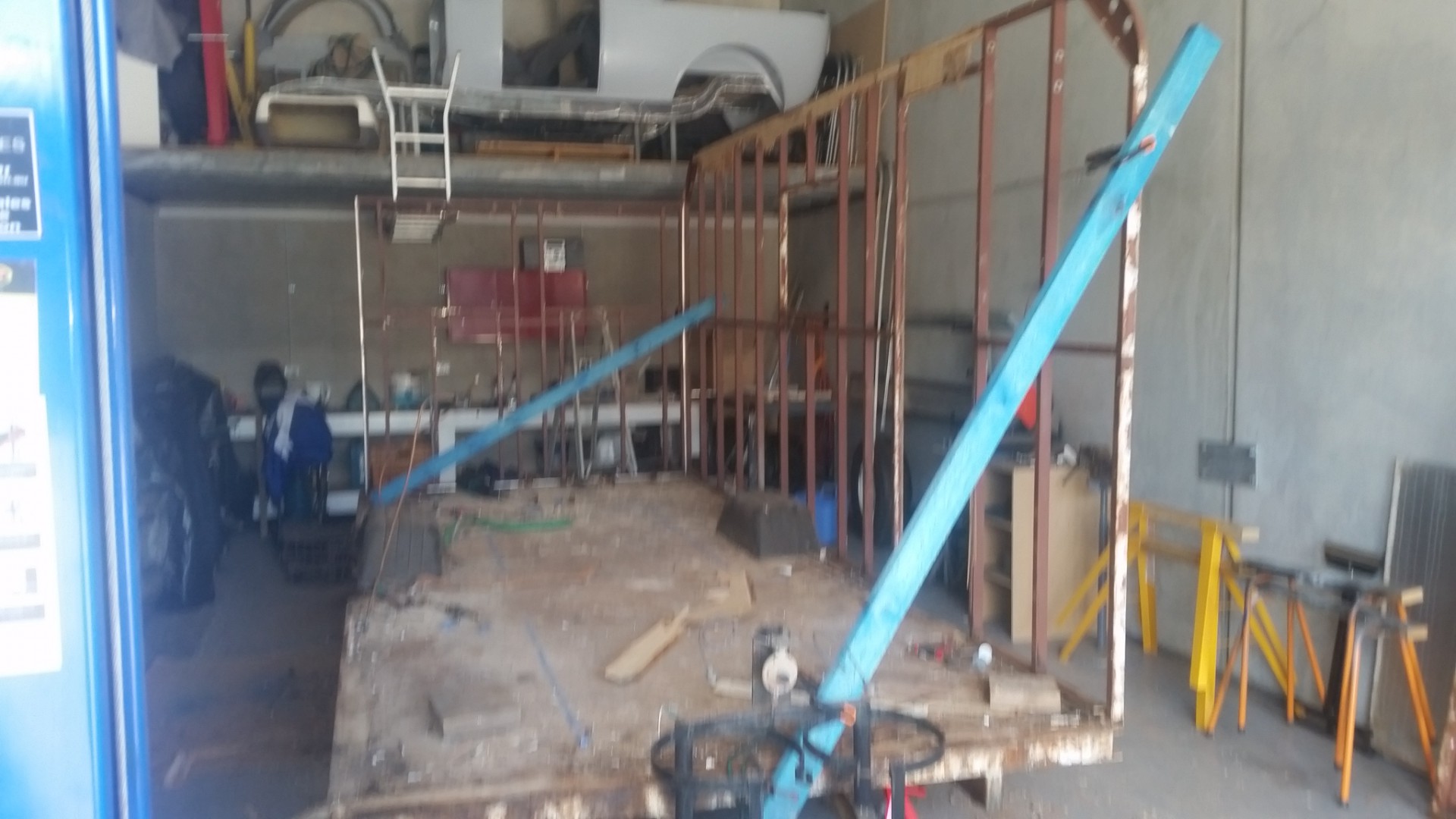

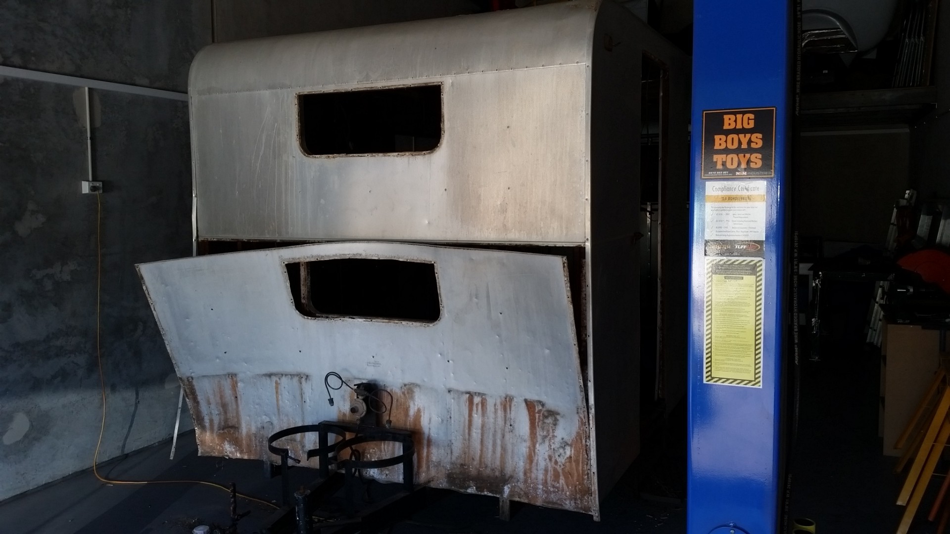

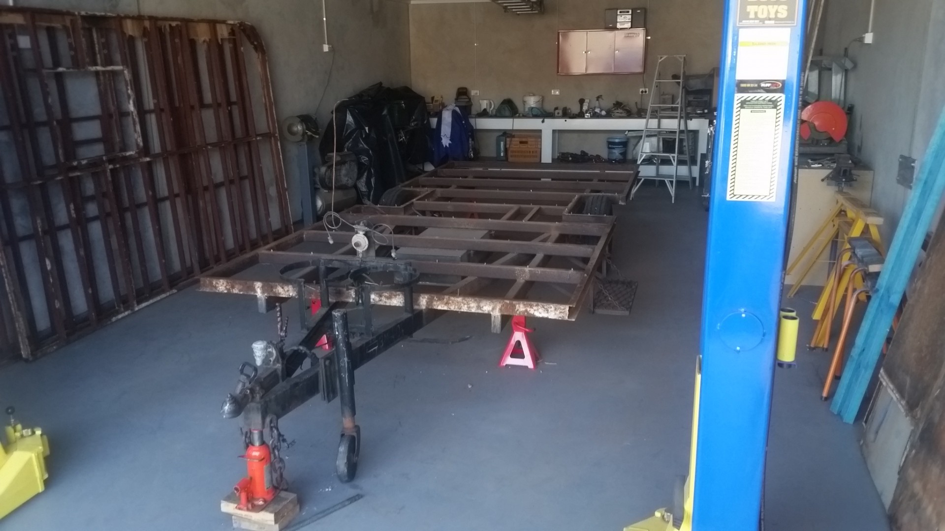

Just a quick update, i have had a productive week since moving into the factory unit and have stripped the the lunch box down to the chassis. I have started to removed old junk which has been added on by previous owners that i don't require and will start welding new brackets for fittings etc and sort the suspension out before it goes of to the sand blasters for blasting and undercoating. Although there is no serious rust in the chassis there is surface rust which needs cleaning up before painting. I have added a few photos of where i am at now. The windows and door are removed then the air con and 4 season vents and then it was onto removing the small diamond ally cladding off rivet by rivet and there was a lot of them. I removed the wall and roof framing and then the floor which was rotted in some spots.
The wall frames have some serious rust in spots which i will start replacing sections once i finish the chassis and send it to the sand blasters. Some of the pictures are not in order (still trying to work that one out) but you get the idea.
Kind Regards,
Alan.
You can see the windows and door are removed and i have started to take the cladding off.
