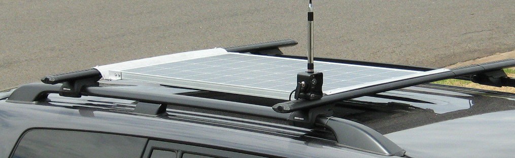

Finally got the 130watt panel between the roof racks. Abandonded the full tray idea and just used 3mm end plates, at a slight angle to assist with moisture runoff.

What is the length x width size of the solar panel?

G'day Phil,
1010mm x 670mm wide x 30mm deep. Vic Offroad in Altona, around $130 I think from memory. Just fitted inside maximum roof rack spacing on Landcruiser gxl 200. cheers Craig

Thanks Craig.
