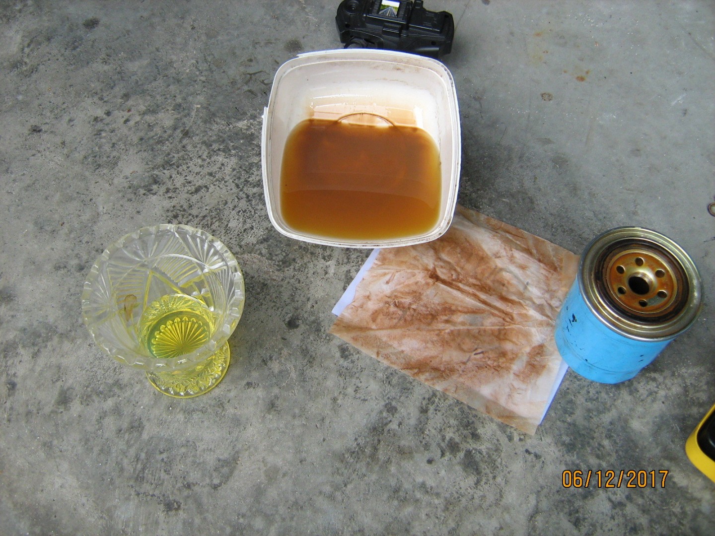

Results from a former farm truck, 2004 nissan patrol 4.2; turbo diesel. removed tank, tank attached breather etc. scrubbed inside tank. now all good. But a common rail high pressure modern unit, I wonder? This was from new until 2013, couple of new filters then the build up was too much. Stopped and on the back of a tilt tray.
-- Edited by Craig1 on Wednesday 21st of February 2018 08:08:25 PM

Just to repeat my assertion that a prefilter is the most important IMHO. The factory filters are good and satisfactory to catch the rubbish down to the size required. BUT it will become overwhelmed by the crap IF you get a bad tank of fuel and some may be forced through. Mostly crap comes with the water, and straight fuel is not dirty in my experience, until you use drums
. So be warned drums cause dirty fuel by poor handling practices.
So having a suitable prefilter that settles out the water and dirt by centrifuging the flow and slowing it to make it settle in the bottom bowl is the universal long standing design used for longer than I have been working on diesels.
Having a clear bowl with a drain tap is a waste of time after the main filter, because if you can see ANYTHING IN THERE the main 5 mictron filter has completely failed and you are already in the sh*t. Refiltering it again down to 3 micron seems a waste of effort to me and might upset the rail recirculation flow of the fuel in some engines.
