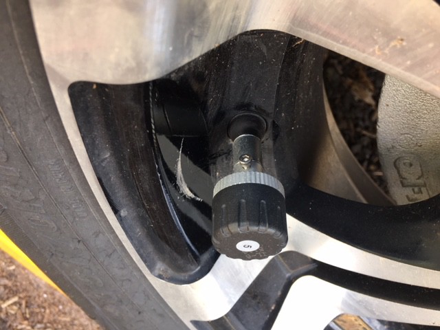

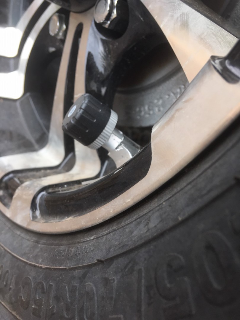

I recently purchased a Safety Dave TPMS system for the tug and the van. All worked well until one of the batteries in the caravan wheel monitor died. Easy to change . BUT while I was removing the unit from the wheel I noticed a happy face on the rim around the valve area. On closer inspection I found that the TPMS had been flapping around and hitting the rim. When the wheel is stationary the unit is at least 1 cm from the rim. This concerned me because the rubber portion of the valve stem has started to split/crack in several places close to the rim. For safety and my peace of mind I have had all the valve stems replaced with new ones. Not a big cost at $10 per wheel.
I had been driving along a unsealed road which had small corrugations before hand. This is what probably caused the flapping, At least I hope so. I will monitor this more closely from now on.
So has any one else had this sort of problem with the valve flapping around when a external TPMS has been fitted.
Also has anyone had the tyre deflate because of this cracking of the valve stem.
If so what can be done to remedy this problem of the valve flapping because of the extra weight of the TPMS unit .

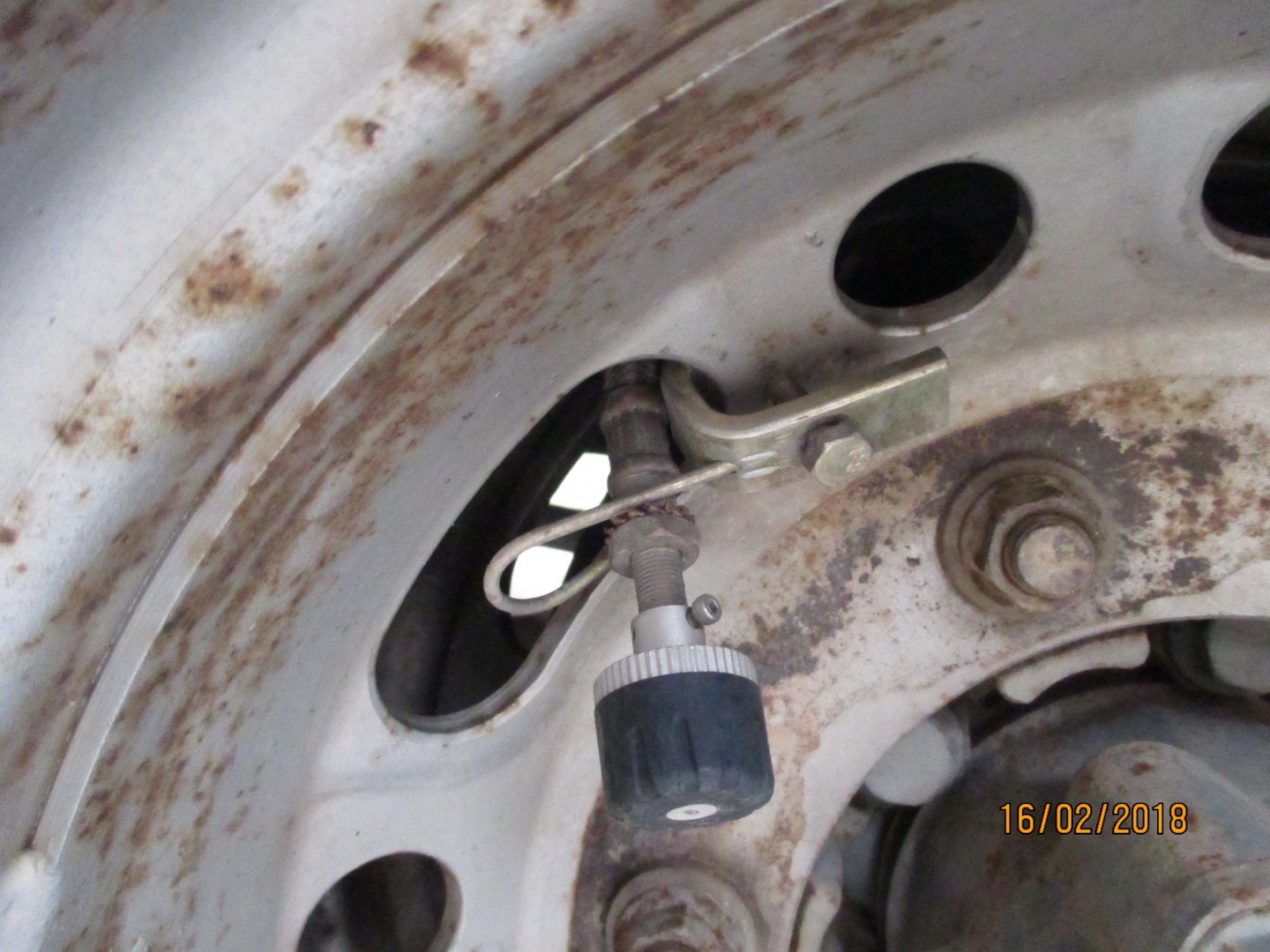

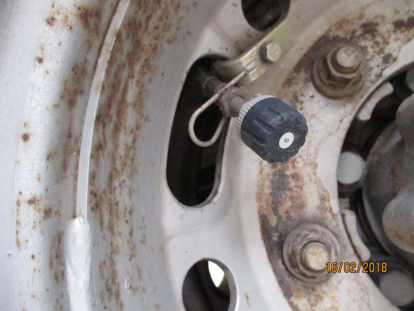

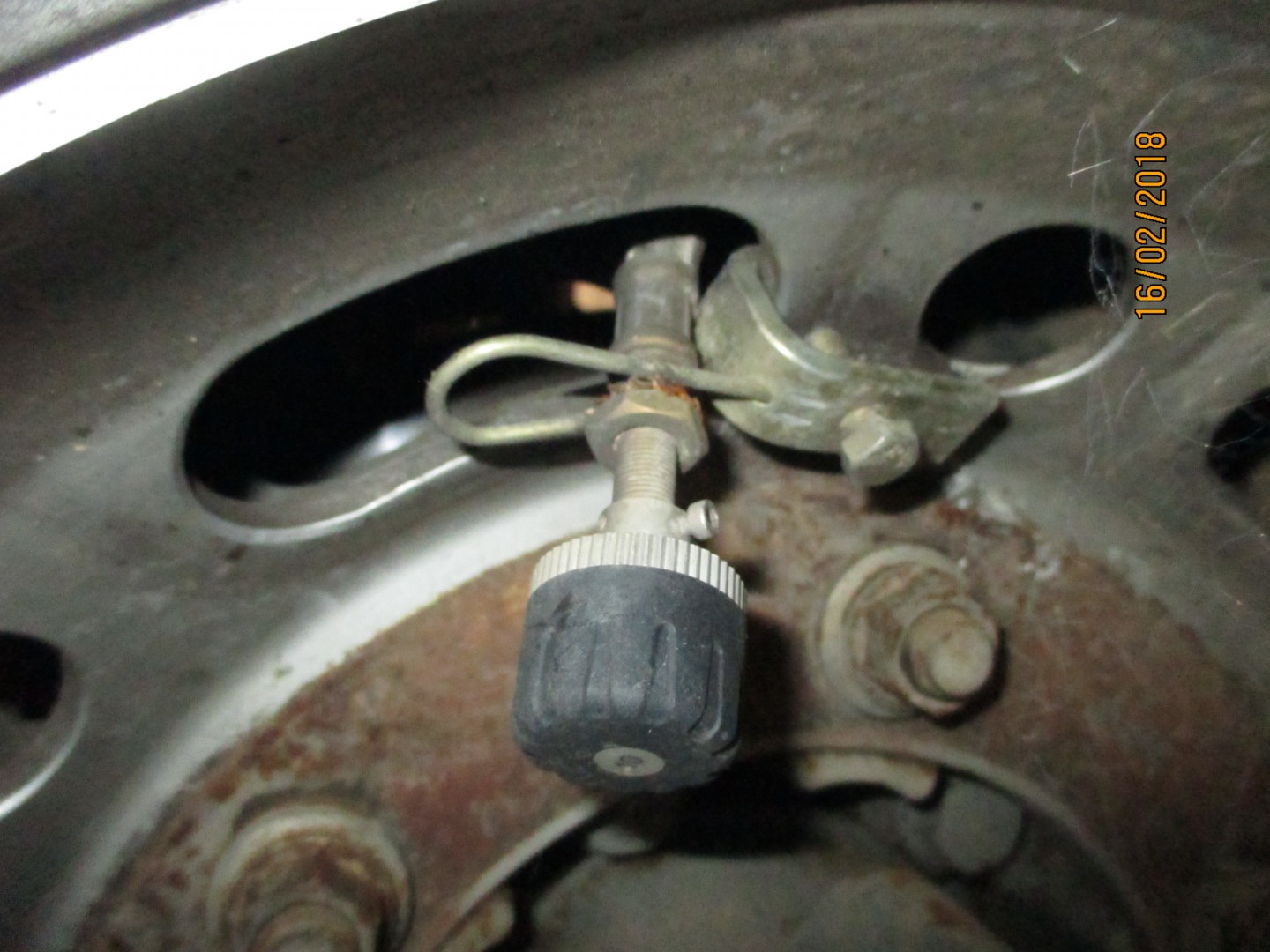

I'm new at attaching pictures. My tyre dealer fitted new valve stems which failed due to the flapping, so we went back to the originals but as my M/home has duels, he fitted flexible extensions to help me check tyre pressures etc. He then found clamps as shown in the picture this page and also in the attachments.
Another method is to use cable ties (the tougher the better), to brace the cap from flapping.
Gets awkward on corrugated roads, so bad one of my units failed but after removing and reinstalling, came back to life.

Maybe fit one of these to each wheel - Porsche used them for valve stem control at high speed . They were not expensive and just stuck on .
The only thing I found with metal valve stems, the seals are critical. On corrugated or pot-holed bitumen roads where sudden jars can be so harsh as to break the seals, suddenly your pulling up to check why the TPMS is warning of deflation.
I had two different style of steel fittings, one had good seals, was brass in colour (fitted to the steering wheels) while the four (chrome style) fitted to the duals were replaced in under 100k's on our first trip because the seals needed tightening which was impossible because the tyre needed to be removed from the rim thus enabling a spanner to be applied on both sides to secure them. On closer inspection, the seals on the latter four appeared to distort so I had a tyre dealer replace all four stems with the original rubber style with no further seal problems. The front two have given no problems.
Rather a costly exercise but I kept all rear tyres inflated to the correct pressure (until the hot day increased the pressure above the tyre manufacturers recommended 70psi). I'm thinking of using nitrogen (which I use on my car), to control the pressure increase on hot days.
