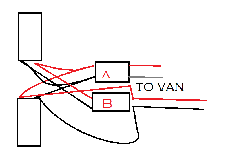

will both of these joinings have the same effect? ie 2 X 100 Watt solar panels
join solar together then to battery or can I splice battery line to one panel then use Anderson to connect panels.

Umm.....Is solar panel 1 a portable panel? Is solar panel 2 on the van and wired to a solar regulator plus to Anderson plug A? Where does the other half of Anderson plug A go to? Where does the other half of Anderson plug B go to?
A and B are options re wiring. Both panels are currently NOT on van and were purchased to go on the van,. Tail end of plugs go to van. option B allows me to put the panels on separately (ie not connected)
Question is best way to connect both panels to get maximum to batteries.

T1 Terry said
04:08 PM Feb 18, 2018
OK, understand what you are trying to do now. If the van side of the Anderson plugs are connected in parallel then each panel side Anderson plug can be wired to an individual panel with no ill effect ....as long as the cable run from the Anderson plugs to the solar regulator and on to the battery are of a sufficient gauge to carry the current from both panels without voltage drop of more than 1% over the full length.
If you use this calculator and add the numbers that suit your system you can determine if the cable choice is enough or if you need a bigger cable. Besides being a bit awkward to handle, there is no such thing as too large a cable when it comes to 12v stuff, just too small
