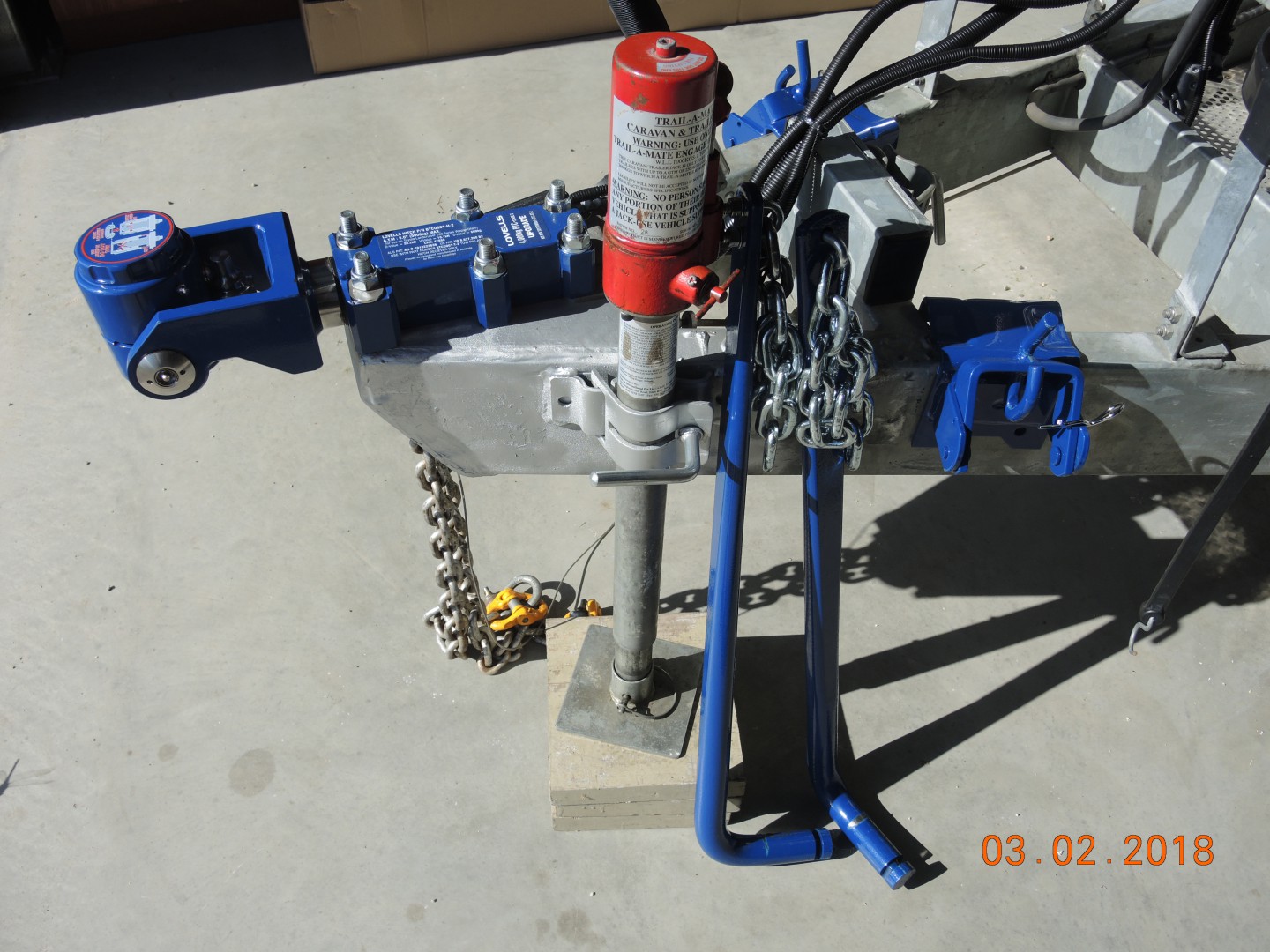

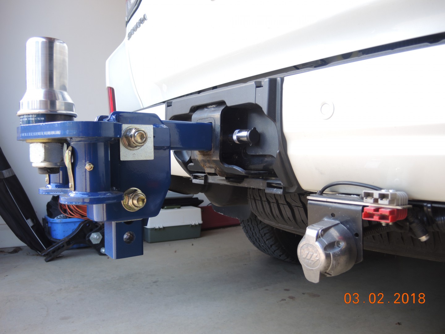

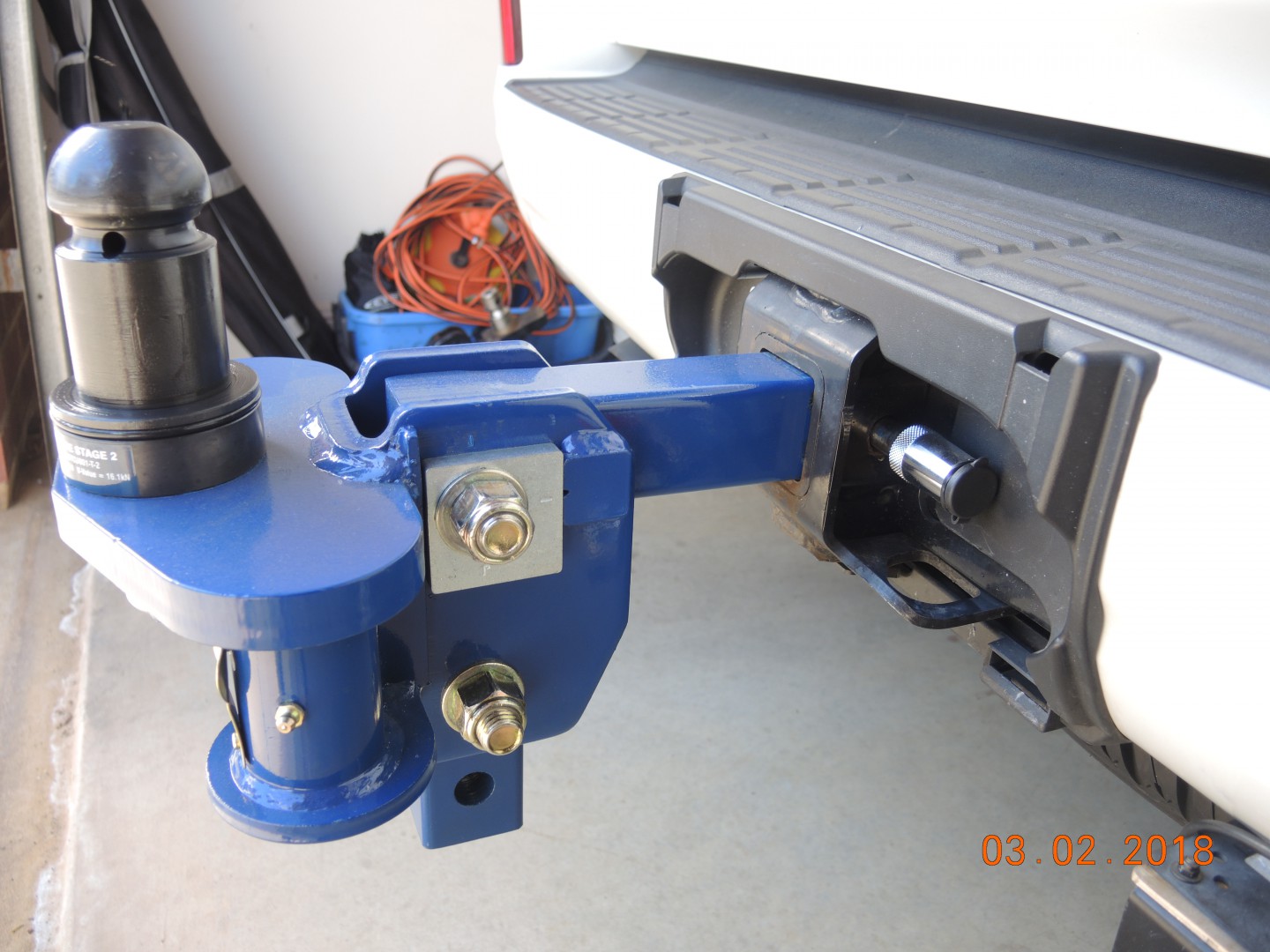

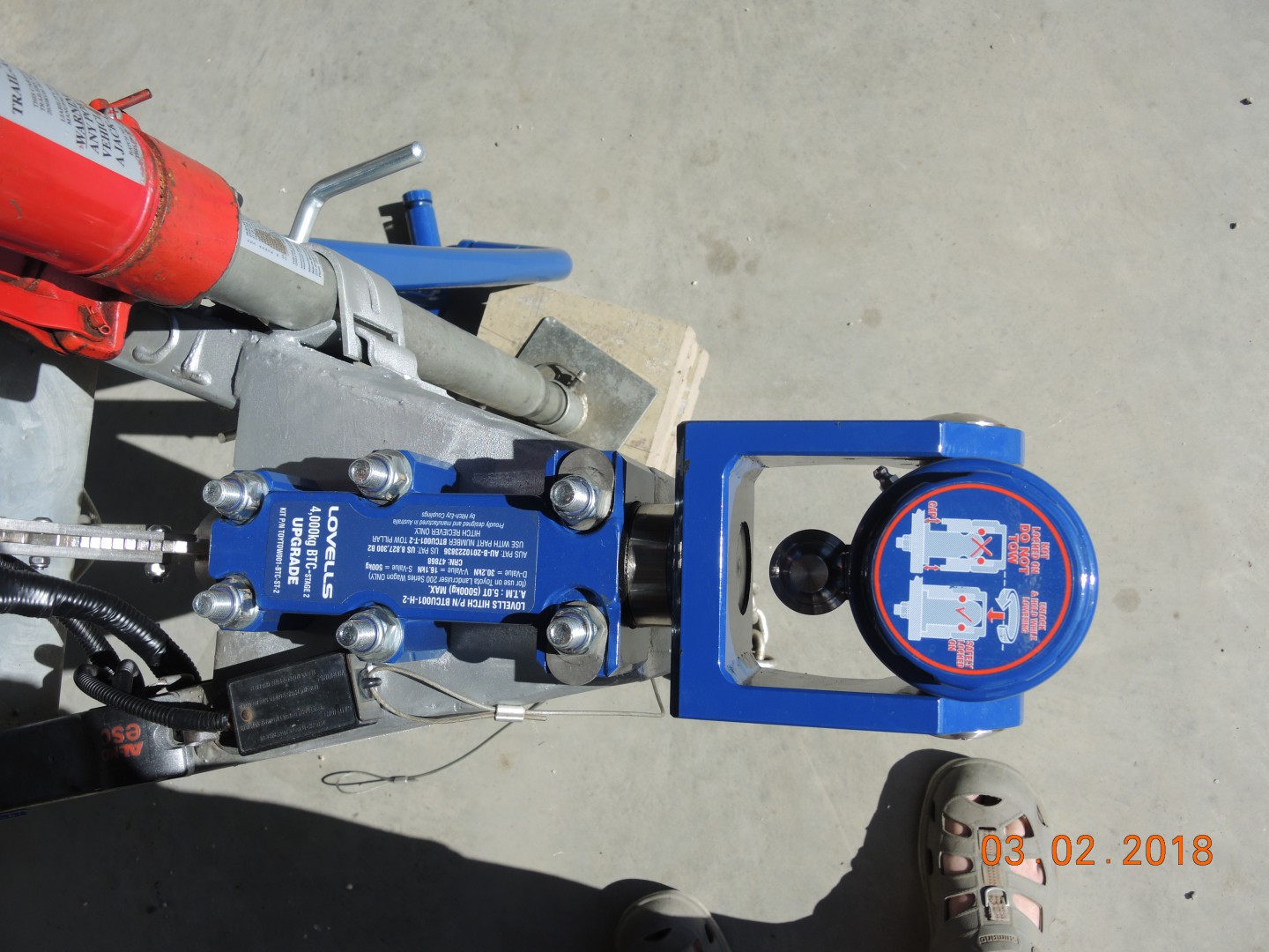

Last recent trip our caravan (Traveller) was somewhat over the three and a half ton legal limit, full water tanks, gas, batteries and solar panels - then food, clothes, etc. I just thought about receiving a hefty fine and having to empty everything out. Never again, problems with insurance and State registration authorities, etc. It was decision time, sell our current van which is great and buy a lighter van at significant cost for change over or look at an alternative. We took the alternative. G & S Chassis did the caravan suspension upgrade to 4 ton which was quick and easy to get done. Then at the Melbourne 4 X 4 Show I got a great special price off Lovells Springs. The result is my 2016 Landcruiser had a GVM Upgrade from 3300kg to 3800kg. (I also removed the rear fold out 6 & 7 seats which are quite heavy). The Rig also has Lovells 4T Heavy Duty Head/Drop Shank/Tow Pillar with 1200lb WDH system and a Lovells 4T Heavy Duty All Terrain Hitch. It was all fitted by Aaron at Uneek 4 X 4, Geelong, mainly because they were close by and recommended by Lovells. This Lovells Kit includes two drop shanks - one large and the other smaller. Lovells are now doing all their own Heavy Duty Drop Shanks/Tow pillar and WDH in Sydney. At least we still have something Australian made and what appears to be great quality. Lovells use the Hitch Ezi 5 tonne rated coupling to complete the whole kit. The Hitch Ezi has a locking mechanism and nipples for greasing. The upgrade installer obtains the Engineers (2) Certificates and fixes the two plates before lodging of the provided paper work with the registration Authority. (VicRoads) I have given it a very testing tryout and the bottom line at this stage is I couldn't be happier. As the van is 23.6" with full 6" chassis rails, etc, it is holding the road extremely well. The GVM Upgrade has made the Landcruiser noticeably more rigid. Wind and apposing trucks appear to have no or little effect on the rig. The only down side is, you need to stretch a bit further to get in and out of the Cruiser. I guess in the near future when we travel from Victoria to Western Australia, we'll find out how good it is. The bottom line is we now have about 300 KG'S to spare and will maintain that as a safety net. Regards, AlPal.
My only concern, I have no qualifications but would question the lenght of the hitch from the rear of the car. That is a lot of overhang, I sure if that was shorter it woukd be that much better again.
Enjoy what you have done, it great to know you are travelling with good figures. Ralph.

Re the overhang issue raised: I have a Haymen Reece (Hockey Stick style bars) 600 lb WDH and from the back of the vehicle to centre of tow ball measures 240mm whereas the Lovell's measures 260mm. That is 20mm or 3/4 " longer than the Haymen Reece, but really there is little difference.
What I didn't mention in my first post was that I have fitted a set of drawers in the rear with a fridge slide and if I wish I can carry a good weight in the vehicle. By taking out the rear two seats you are changing the registration seating capacity from 7 to 5. I simply stated that after caravaning I would take the drawers out and replace the seats When I did my own drive test with everything connected and level; it is my opinion that this is best system I have had. When I swerved the van, the only thing that happened was that the ESC on the caravan came on and it also worked 100%. I am not qualified or an expert on these matters, nor do I recommend anyone buy the Lovells Upgrades. But having driven Army heavy haulage vehicles, semi- trailers and heavy vehicles , a bus and had 3 caravans over 53 years without an accident, I feel comfortable in what I have done.
