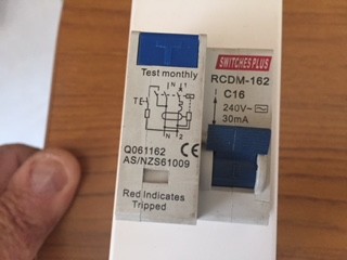

What is a combined RCD/MCB? Will one of these provide the same protection as an RVD?
-- Edited by Phillipn on Sunday 4th of February 2018 01:30:34 PM

What is this then?
