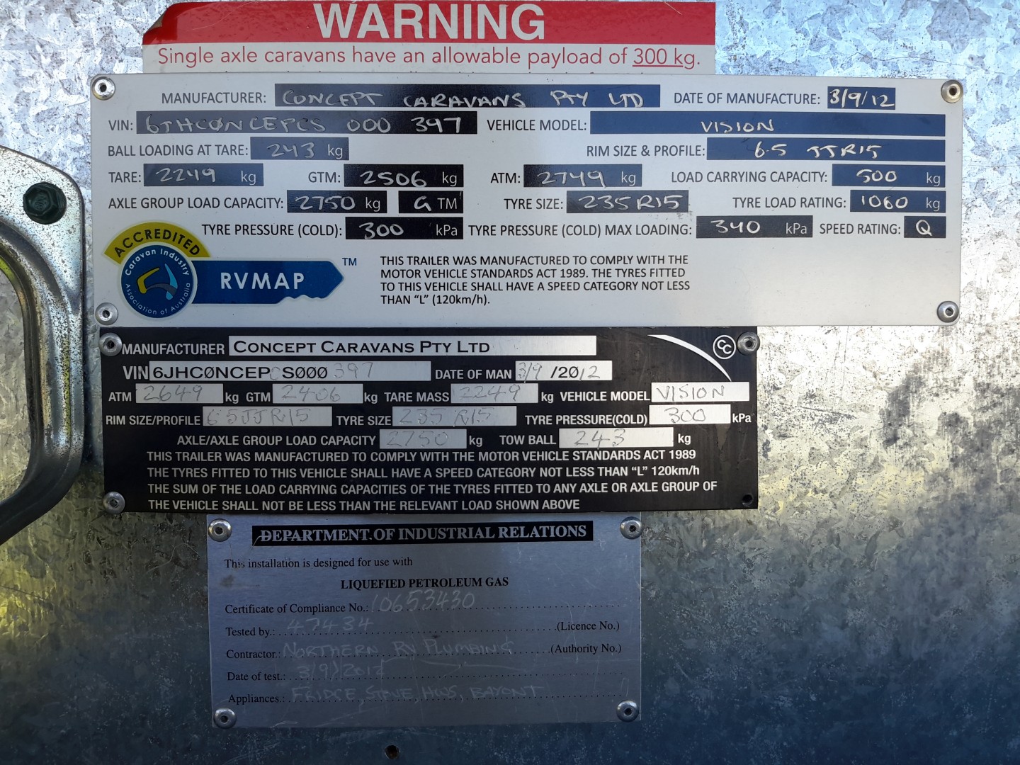

As there had been a lot said in the media about weights we decide to check this one while we have chance. Well it was not good.
Orignal Vin Plat First weigh. Over weight 2nd weigh. New Vin Plate caravan
Caravan only 2649kg 2720. 71kg 2730. 2749 gross vehicle max.
Towball. 300kg 320. 20. 273 300 loaded max.

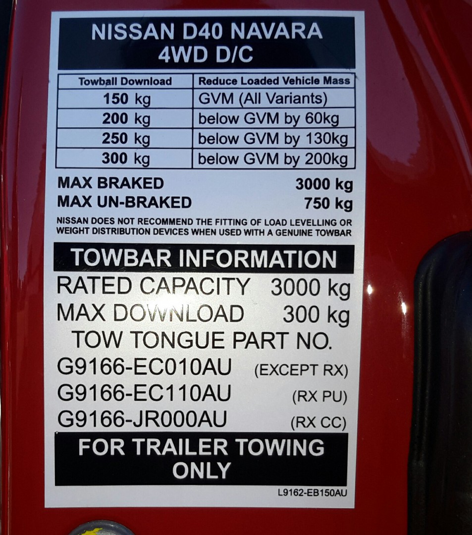

Nissan. gcm. Corrected rego certificate on Nissan
& caravan 5405kg. 5560. 155kgs 5440. 5510 gross combination mass
Car only 2805kg 2840. 2560. 3010kg gross vehicle mass

We approached Alan Grahams Caravans the orignal seller of the caravan for $165 they organised though Concept a Vin plate showing an extra 100 kgs. Things were looking better.
Next by a slim chance in a conversation I was told our particular Nissan Narava has a better gross vehicle mass then most other crew cabs, so a bit of checking was done and found the Nissan dealer had in fact filled out the registration incorrectly giving us an extra 205 kgs. Yes now we are looking better.
To correct the heavy towball weight. The axles are set well back, our caravan is mid door basically the only weigh behind the axle is the ensuited area, water tanks around the axle area nicely placed. Under the front bed is about 40kg of weight, the rest of the normal needs are sitting over the axle

Now I know we are legal with our gross combination mass weight, caravan is looking good with its 2749kg goss vehicle mass and thirdly the car with its 3010kg gross vehicle mass is well under.

The only figure in my graph I am not 100% sure about is the gross combination mas weight, to me is the important one, that 5510kg could possibly should read 5810kg in all the Nissan paper work, reading webb sites, sales brochures its not mention. That gives me heaps, maybe I might take me bike with me, the expresso coffee machine, buy a kayak.
