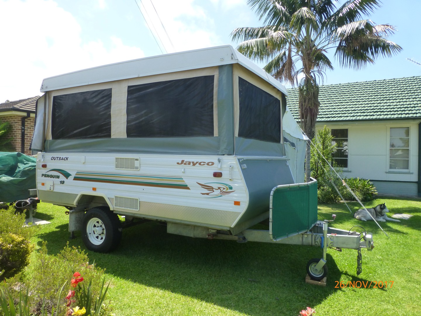

We've recently bought our first van,a 2003 jayco outback penguin and was wondering how people who own or have owned one found them offroad,we've driven most of the true offroad tracks like the cape etc so probably won't be doing anything too serious in the van,just the odd dirt track or road.
cheers

Our graduations were tent Large & small, tent (or camper) trailer, 2005 model Jayco Eagle Outback, 2011 model Jayco Discovery Outback.
Each stage where we went was reduced somewhat because of width, roughness of the road{?}. DRIVEN WITH CARE YOUR PENUIN WILL GO TO MOST PLACES.
Run LT tyres & adequate pressures for the terrain you're travelling in. Our last trip on part of the Oodnadatta & the whole of the Birdsville Tracks three years ago were done with about 36-38psi in new tyres. We had no troubles what-so-ever but we saw plenty who did!
Sure some small screws may fall out of the furniture (often it's hard to find where they came from0 but the van held together ok. Our worst trip was through Lakefield National Park a number of years ago. We were with friends towing a tent trailer. We went through in early December & cutting a long story short, I said to Pat at one stage "When I look in the rear view mirrors, all I'm going to see is the chassis & wheels!" Well somehow the Eagle survived - our friends had some parking lamps fall out of their bull bar.
Key points -
1. Keep an eye on the shocker mounts - sometimes the bolts fall out.
2. Check the tightness of the bolts securing the wind-up cables where they attach to the winch. The ply panel you need to remove to check this is under your bed.
3. Do NOT wind up the lid with the catches on.
4. Do not wind up the lid above the guide rope on the font LHS pole.
5. Make up four safety poles - one for each corner of the roof.
6. Bear in mind that on a bush track, the Penguin is wider than your vehicle.
7. Service your wheel bearings each 10 to 15,000Kms & use NEW SEALS
In nine years, I had two majors - the cables as in Key point #2 - one nut came undone causing one corner of the roof to drop (it was very heavy).
- I blew a grease seal at 100 kph on the Hume Highway & welded the bearing to the axle (was minutes from a total disaster)!
Yes there are better vans but they cost a lot more, weigh more & who knows whether they will perform better in the same conditions.
Happy Jayco-ing,
Warren

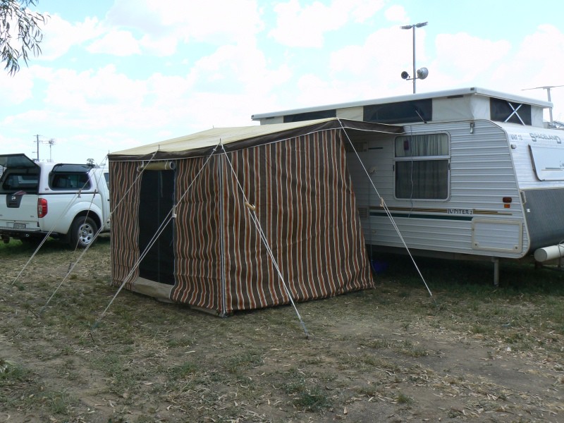

Have a look at adapting the Oztent to a breeze way annex. The awning flap can be modified to attach to the top of the Penguin. Many years ago I had a Tebbs breezway annex that was much the same as your Oztent. It made good outdoor protection when on site for a couple of days or more. It also makes a good bedroom for freeloaders. We only got rid of it when we got a much longer van, an 8' 6" annex was a bit small for a 19' 6" van. The annex went to an owner of a Jayco camper trailer.
edit - I found the pictures of the Breezway annex. I erected it on the off side of the van to get some pictures to sell it. You should be able to modify the Oztent to work the same way.

Thanks mate ,worth thinkin about if we need a bit more space with the grandkids
