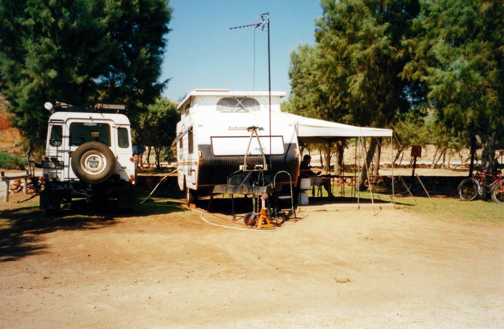

Our van was built with a slightly extended A frame. A piece of metal - like an upside down U, but with the arms splayed, was mounted on this, in front of the stone guard for the gas bottles. A hole in the top of the cross piece took a towball. We already had a bike rack that fitted on a towball on the back of a vehicle and wanted to keep using this. The bikes hung down from the rack. There was just enough room to get the van boot lid partly open, when the bikes were up. They were well clear of the vehicle. We were admanat that we would not carry bikes on the back of the van, having seen a couple of accidents where bikes came off same due to vibration and fell in the road of oncoming traffic. Our arrangement worked well over the three years of full time travel round Australia and on some other trips. It meant that we could, when we wanted, put the bikes on the back of the vehicle and drive off somewhere and then go cycling.

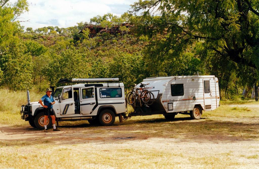

Gday this works for us .I relocated the tyre off centre,Rang Supreme and they said all the rear ends are designed to take 2 wheels an 2 full jerry cans so no weight problems. Just a normal tow bar rack with mods and fitted on with Hi tensile U bolts . I went to the local cop shop to see what they said re number plate .all OK .Cheers

Those bikes illegally obscure the number plate and the lights.
Sooner or later you will be booked for that.
Apart from that, mounting ANY weight at the rear of a van WILL increase the inherent instability.
