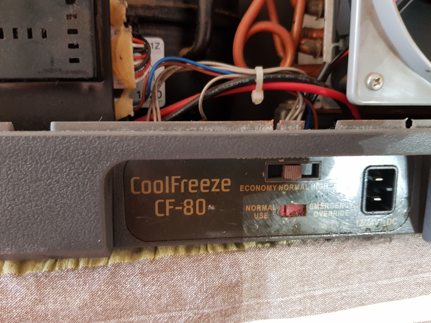

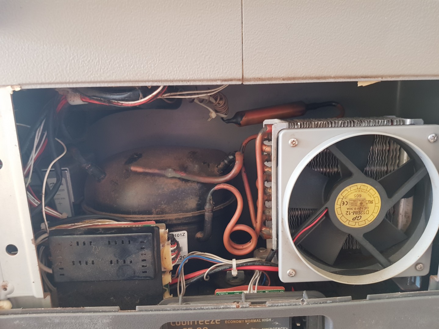

Hurls said
10:33 AM Dec 28, 2017
DeBe,
Thanks for your reply. Photos attached.
Override switch is in normal position, can't see anything that resembles a spare part. Any further assistance would be greatly appreciated.

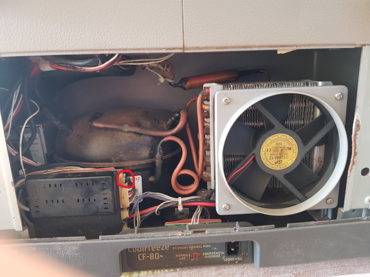

DeBe said
11:25 AM Dec 28, 2017
Bit hard to see in the picture but possibly around where marked should be a 2 pin plug with thin black wire pair. This in the thermistor wiring, if you trace it back to where it disappears in the Foam there might be another spare lead with plug. To test the thermistor it should read 10K ohms at 25 Deg C.
