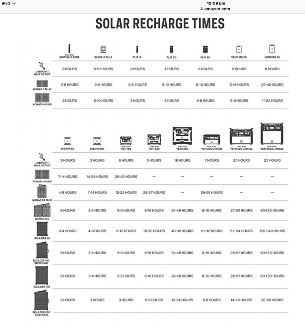

The link didn't work, but Google found this https://www.goalzero.com.au/shop/rechargers/yeti-400-solar-generator-230v/ and $699 for claimed 33Ah battery makes it $21.20Ah @ 12v ..... but even the 33Ah is questionable as the specs show 396w yet no mention of the lithium chemistry used (all lithium batteries are classed as lithium ion, that is the ION exchange that all chemistry lithium batteries use to function). LFP/LYP, the safest of a lithium chemistries have a nom. 3.2v per cell so the capacity is 3.2v x the number of cells x the capacity of each cell, or by dividing the watts (396w) by 4 and dividing that by 3.2v the capacity comes out as 30Ah. Now, if they are using LiPo or lithium polymer cells, these are the fireball cell the model plane people talk about and are 3.7v nom. so 396w divided by 4 divided by 3.7v = 26.75Ah.
The next eye opener is the 13 hrs to recharge via the vehicle, lithium is well known for its fast recharging ability so.......????
What is missing from the spec sheet but is the all important part, what chemistry lithium batteries are they
The next worry is this in the Yeti 1400 listing
High-Quality, Replaceable Lithium Pack Lightweight lithium batteries yield long runtimes and extended 18-month shelf-life. High quality cells feature additional monitoring electronics for superior management and ultimate safety. The lithium pack is also easily replaceable and is easily swapped out at the end of the product lifecycle.
So the 18mth shelf life suggests LiPo cells, you don't want to be putting them inside any where you plan to live or sleep.
The other bits you get are an unknown, but it they tell porkies in their spec sheet you have to wonder don't you, is the inverter modified sine wave or pure sine wave? What is the inverter capacity? .... the list of questions go on and on.....

PS I found this chart and yes it does seem that the Lithium charge tomes are long?
