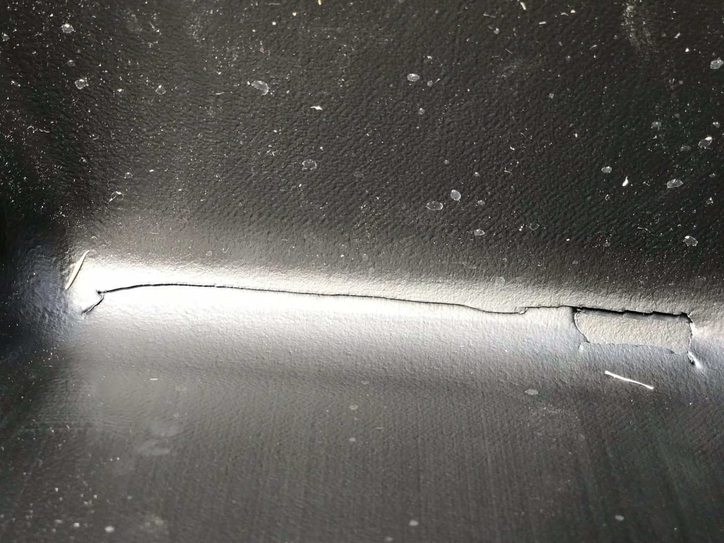

I have had my van in storage for 8 months and as advised had drained the two 90ltr undervan tanks .
Today I flushed them and then shut the tank values off and filled them as I had done many times with the hose .
Much to my surprise there was a very loud bang one of the water tanks looks like it has slit and just dumped the water.
Normally when the tanks are full it spits out of the water cap.
To make it more confusing it did work as it should the first time I flushed teh tank earlier today.
I am going to have to drop the tank out to confirm it has split next week end .
If it even possible to bust a water tank under pressure.
What a day and the bolts to get the tank out look a little nasty to get to.
Ideas

Peter_n_Margaret said
08:29 PM Dec 3, 2017
Sounds very much like the vent is blocked or non existent.
dieseltojo said
09:56 PM Dec 3, 2017
Hi Col Rennie,
Yep, I never advise a tank to be emptied for storage. I never have in 50 years of camping and never had a water problem.
That said, it is hard to say what caused it to split. I would say that due to being empty it has been able to expand and contract more than the poly would like, then the incoming pressure was too much for it. Or a manufacturing fault.
As already noted, a hornet might have built a nest in the expansion area, but more likely the over flow hose might be kinked or trapped with the movement of the empty tank.
I remember this happening to a bloke years ago and the van was moved by the caravan (long term parking) mob and then placed onto a site. They must not have taken it over even ground, or the van sunk a bit into the mud. Or the tyres were low.
Anyway the tank corner was hit on something and damaged.
I asked the owner where it was parked and even showed him what they had dragged the van across.
Hard to say with out a good look mate.
Col Rennie said
10:20 PM Dec 3, 2017
Thank you for the feed back.
It is greatly appreciated.
I will disconnect the overflow pipe and run water through it to ensure it is clear and drop the tank out this week end to see the actual damage .
Thank you again
Tony Bev said
11:28 PM Dec 3, 2017
As others above have said, it is hard to say without removing the tank, and looking at it
From my observations, a lot of rubber and plastics, suffer from age hardening, due to the cold and heat cycles
Perhaps over the eight months of storage, the empty tank has been contracting in the cold, and expanding in the heat, which may have caused a weak spot
Or the tank may have had a weak spot from new
I removed the 59 litre tank from my old caravan to clean it out, the thickness was not uniform
As far as the rusty bolts go, use a wire brush and plenty of CRC/Penetrine before trying to undo them
Also (if the bolt head is not welded in), use two ring spanners and try to loosen the nut off, by going back and forth
mustangdude said
07:25 AM Dec 4, 2017
I'd be surprised if the tank was made of ABS and it split. That stuff is tuff.
Hopefully it's a fitting came unscrewed or snapped off. You're going to undo the fittings before dropping the tank so hopefully you find an easy fix.
09:14 AM Dec 4, 2017
99.9% of commercial water tanks and most custom made ones are polyethylene, either blow moulded or rotation moulded (with custom ones hot air welded). A few custom made ones might be hot air welded from polypropylene or ABS. If it is split and made from polyethylene it can probably be repaired by hot air welding provided the wall section is sufficient (there are some very thin junk ones about).
I may be easier to cut the bolts off and replace them with new ones.

lizard said
09:44 AM Dec 4, 2017
We had one of our water tanks split after filling - tank split on the seam ..... my vent was clear - water spurted out .... !!! Replaced the tank
Possum3 said
02:34 PM Dec 4, 2017
I had one split on and Old Viscount 1977. Tanks are cheap -replace and ensure overflow vent isn't blocked
07:36 PM Dec 4, 2017
And buy the heaviest one you can find.
11:21 PM Dec 4, 2017
I have not heard of one splitting for quite some years. Back in the 90s it used to be common where people filled their tanks with full flow from a tank and the hose was pushed a fair way down the filler. . A lot of tanks are formed from two mouldings that are stuck together, they were splitting on that seam.
See if you can get the split welded. Then make sure you have good free flowing breathers. Also take a little more time to fill your tanks.

Col Rennie said
06:40 PM Dec 6, 2017
Thank you all as always this site really helps newbies like me.
Tomorrow I have the time to drop the tank and see for the first time the real damageto the tank
Spoke to the manufacture sounds like the tank has split on the seam as the tanks are two halfs welded together.
Interesting
wish me luck
